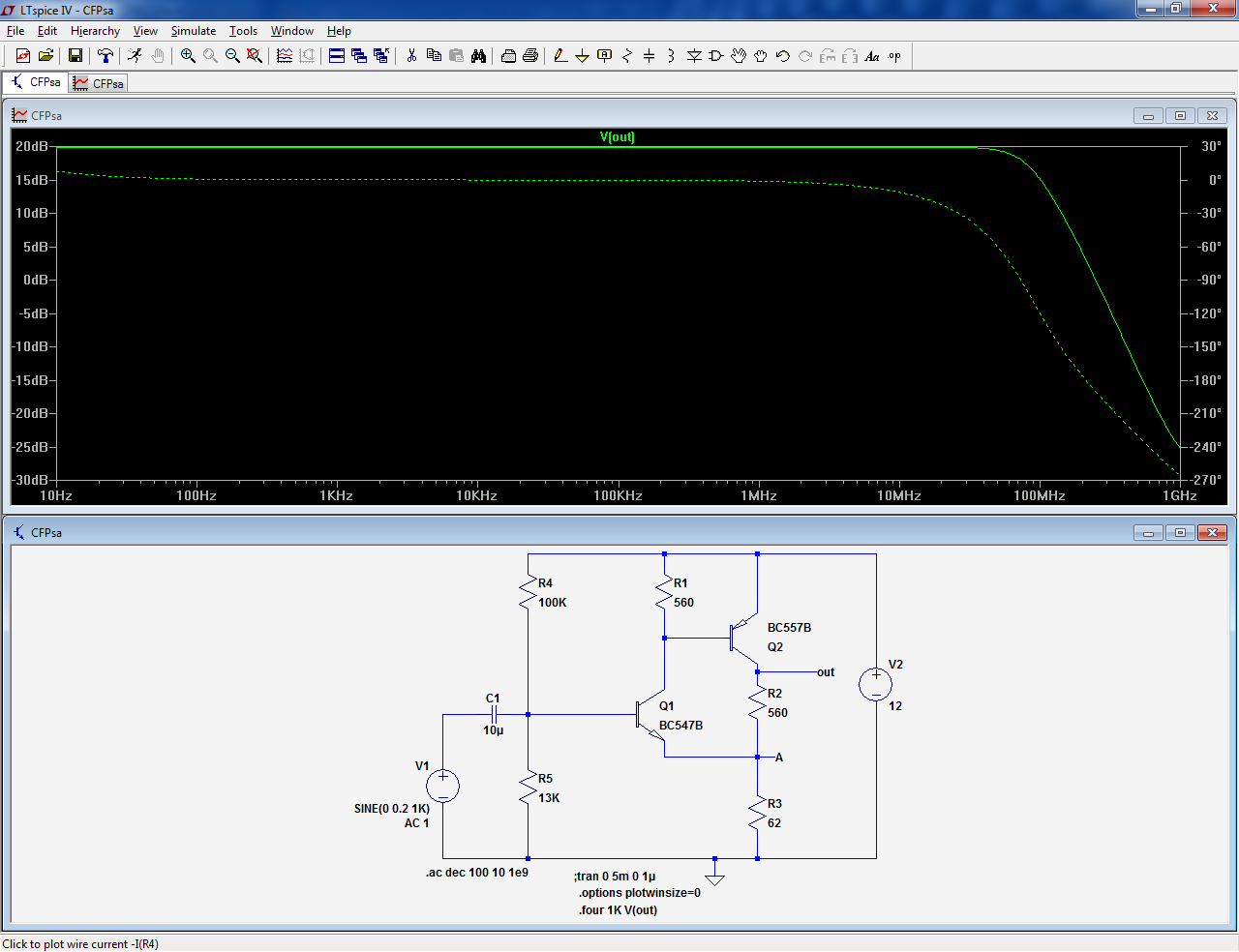

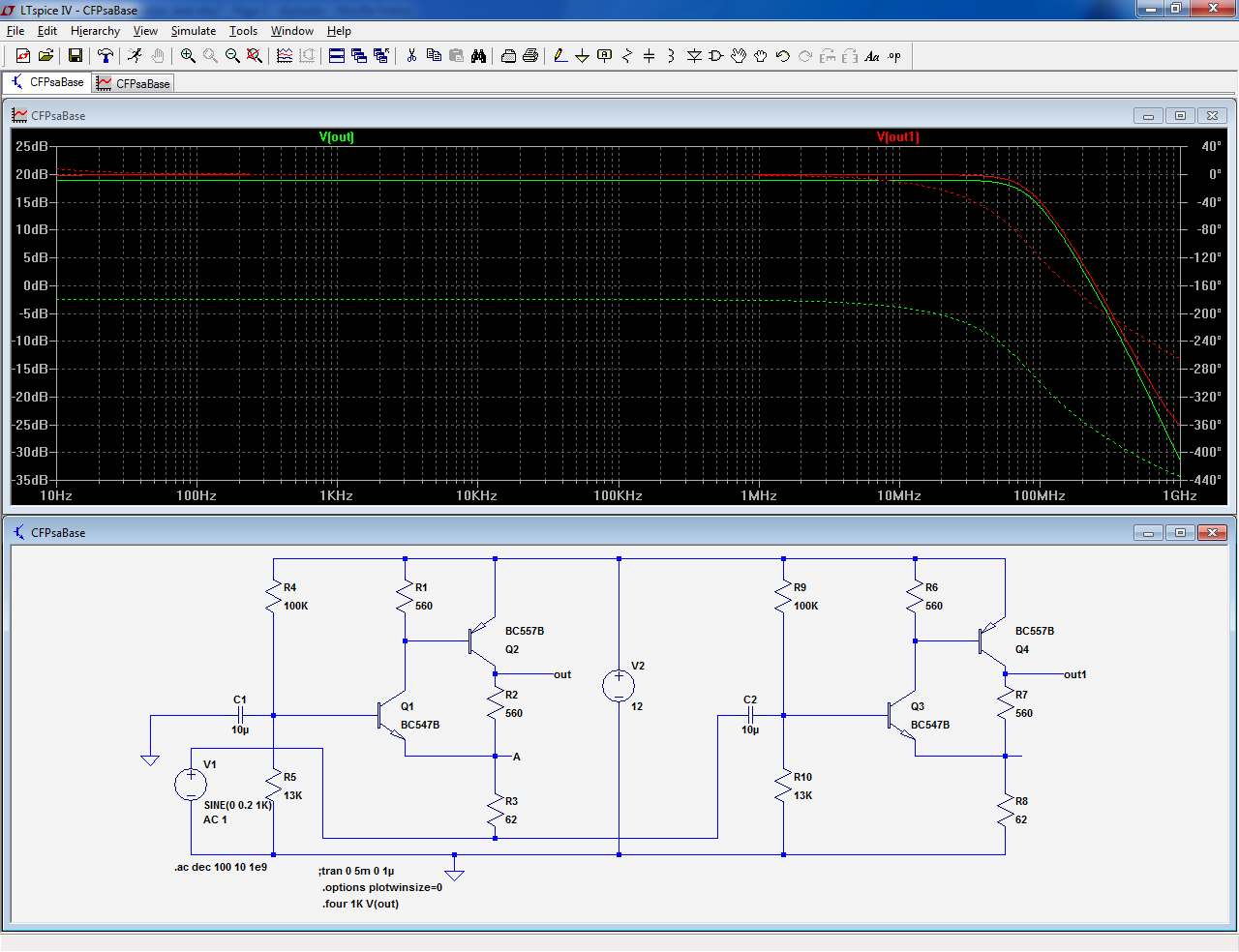

Is the CFB topology superior, and why?
I would like to investigate about the actual/perceived/imagined superiority of current feedback, and possibly to pinpoint what exactly makes it superior (if indeed it actually is).
As a study subject, I propose to use a very simple, quasi-canonical form of a CFB amplifier, the CFP with gain.
The two first pics show the linearity and frequency performances of the circuit.

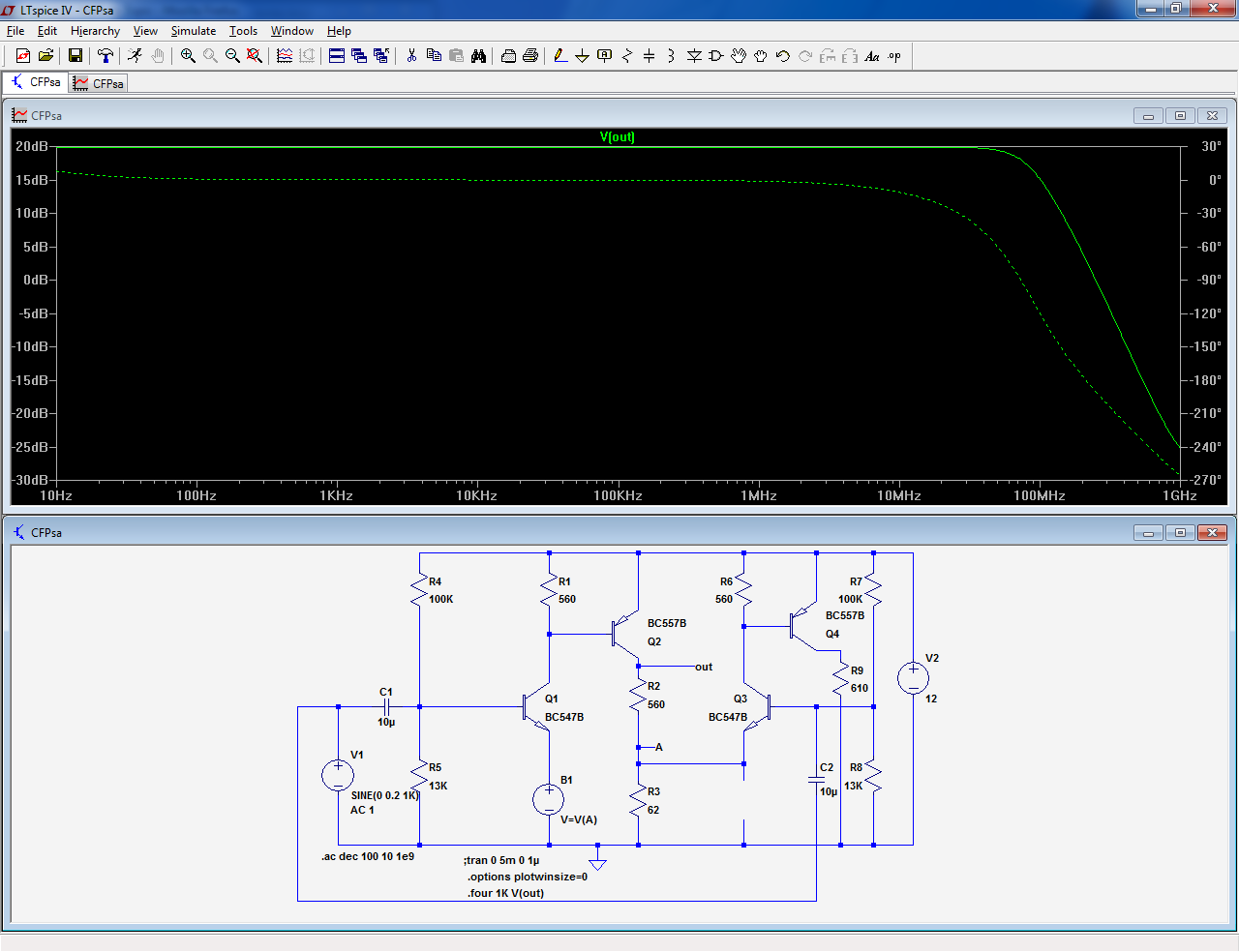

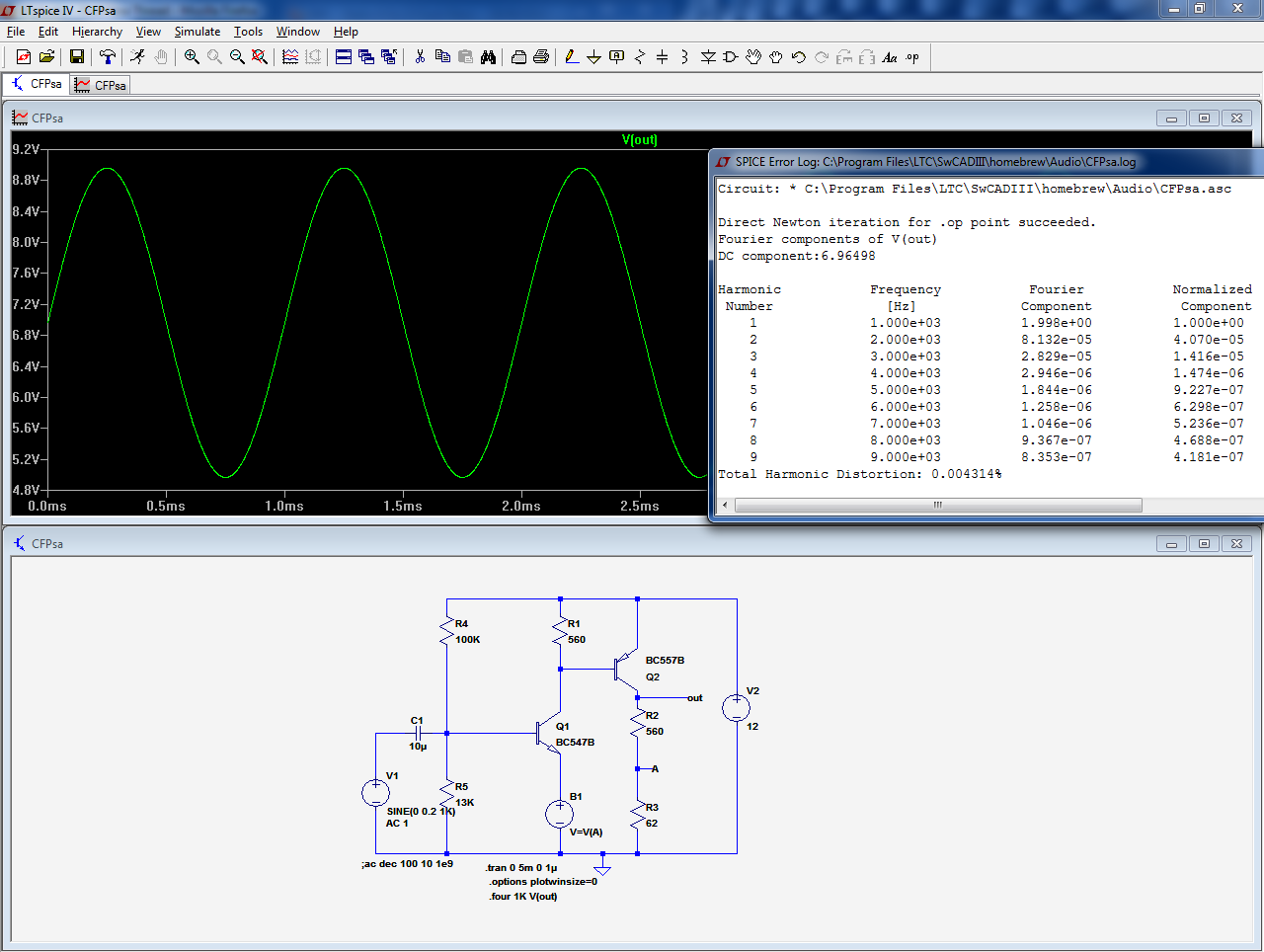

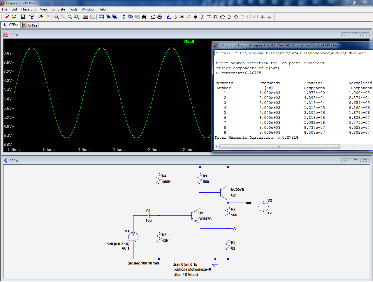

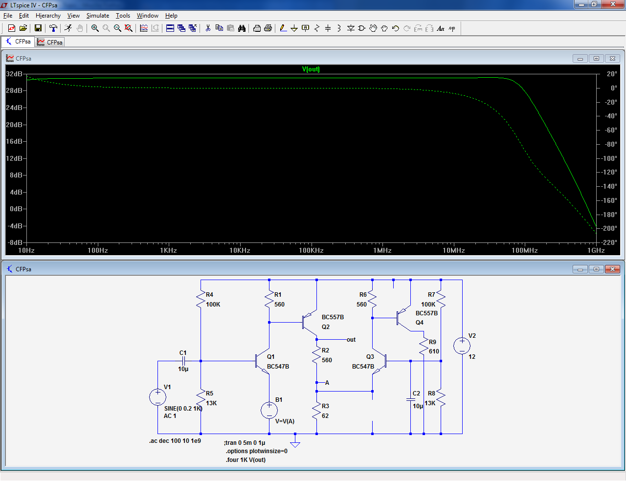

The interesting thing with the sim is that it allows the transformation of this ideal CFB amp into an identical ideal VFB stage.
That can be done with an arbitrary voltage source (the next two pics).
As could be expected, the linearity has improved thanks to to the increased loop gain, but somewhat more surprisingly the bandwidth also increases.
Now that we have noticed the differences, we can begin to try to even them out, to try and see where the two versions diverge.

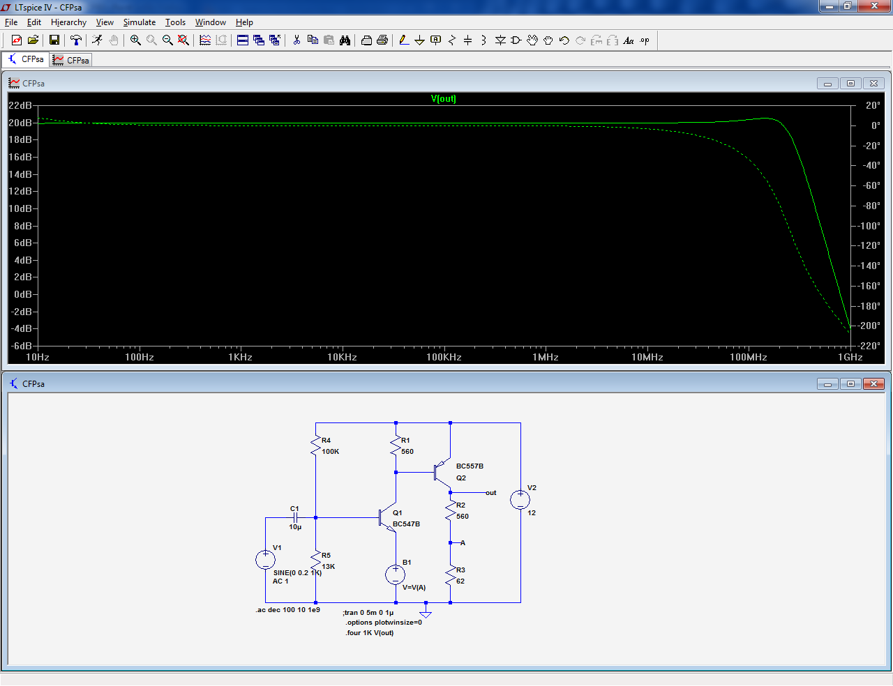

Let's see the effect of the loading on the feedback point, by adding an equivalent circuit, while retaining the VFB configuration: it begins to look more like the CFB incarnation, but do not be fooled by the graph: LTspice has automatically scaled it, and the 1GHz intercept is at -4dB instead of -25dB.
Isn't R2 in the wrong place?
OK, I should have explained more clearly what I did exactly.
I thought the diagrams were sufficient, but that is not necessarily the case for people unfamiliar with spice.
I started with a classical CFB circuit; I then buffered the feedback point using a spice ideal buffer: a voltage source that simply copies its input, without loading or delay.
I then attempted to reproduce the behavior of the initial CFB circuit by loading again the feedback point with a (not so!) similar load.
That's where we currently are
The first attempt to revert to the CFB characteristic by loading the feedback divider has failed.
The reason is simple: in the real CFB, the impedance is in fact different, because Q1's base is not at a fixed potential: it follows the signal, and thus bootstraps the emitter's impedance.
This in itself is quite interesting: it means the so called CFB is not really a pure CFB: it also displays attributes of VFB.
In order to have a really pure CFB, we would need to sufficiently reduce R1 to make R3 unnecessary.
So, back to our CFB-like VFB, all we need to do is to equalize the base potentials of Q1 and Q3.
And this time, it works:
We can now try to confirm what we discovered: the canonical CFB is in fact a closet VFB circuit.
We just have to compare the magnitude of the currents in the sensor transistor, Q1 and the output divider: (the current into Q1 is 72µApp)
Yet, this very light loading is sufficient to cause significant errors, as we have seen earlier.

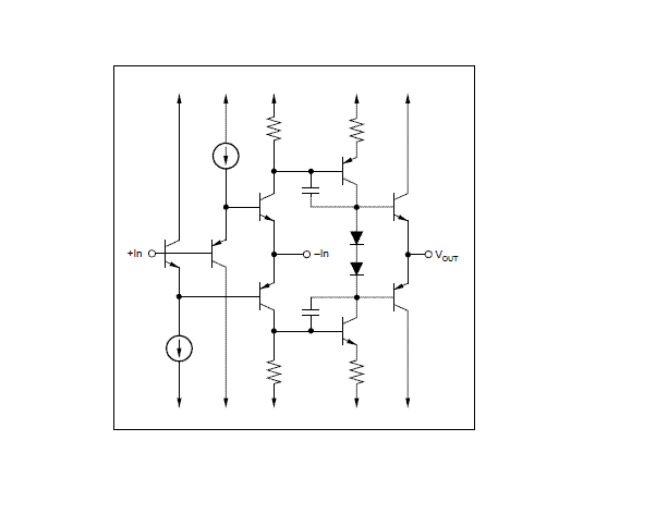

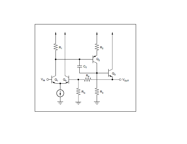

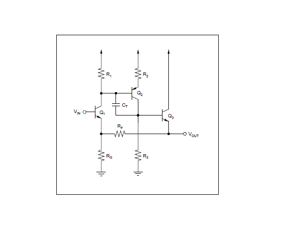

This is the three transistor configuration as it appears in a Burr Brown application note.
The second configuration is the addition of an emitter follower that isolates the feedback loop and gives constant open loop gain unaffected by the feedback components this is then the classical voltage feedback op amp topology.
The third diagram is the basic current feedback topology. You can see that it is a symmetrical version of the three transistor amp, with a complimentary emitter follower on its output and emitter followers buffering its input.
rcw

This is the three transistor configuration as it appears in a Burr Brown application note..
OK, this circuit is identical to my first one, except for the emitter follower output.
This addition means that you can lower almost arbitrarily the gain setting resistors, and get a matching increase in OL gain (and departing from the CFB "philosophy")
That one is the "real life" version of my second circuit, with the spice buffer replaced with an emitter follower
Yeah, for high enough transimpedance gains, this structure will have a behavior indistinguishable from a regular VFB in all practical circuits (except comparators).
