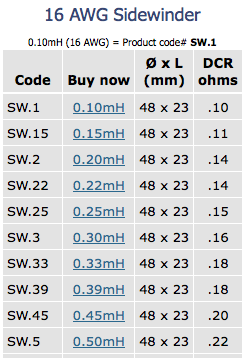

You can look at f.ex. this Madisound table and see that the DCR for two smaller coils in series do not add up to the DCR of one larger coil. Turns ain't always turns....

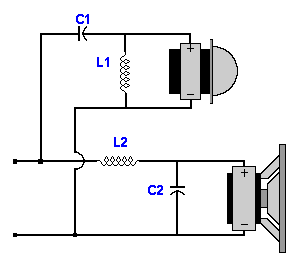

I need it for very simple 2nd order Butterworth passive crossover.
Therefore, 0.22uH/0.11Ohm RDC + 0.10uH/0.07Ohm, sum will be 0.32uF/0.18Ohm (I can live with that), but what abouth quality of sound
I have Mundorf colis CFC14 0.22uH(and if possible I would love to use them), dont want to waste money buying coils of 0.10uH and connect to my coils if the quality of sound is not equal or similar to single coil of 0,32uH.
