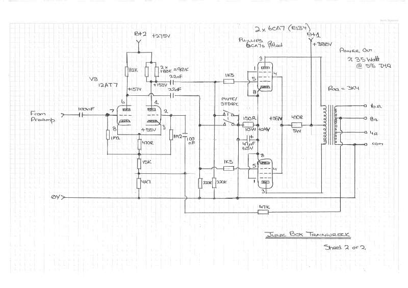

If you are a member you can see my schematics etc. here - the "Junkbox Trainwreck" built from an old Ozzie AWV PA Amplifier.

The "Junkbox Trainwreck" I did. For your possible interest.
Note you end up with a spare 1/2 of a 12AX7, I added a "wrinkle" of my own by using a parallel input to take advantage of that spare triode. The 2 triodes at dissimilar operating points for a bit of harmonic emphasis.

Nigel may well be right.
I copied this schematic before adding my own "wrinkles".
http://www.blueguitar.org/new/schem/trainwreck/wreckxpr.pdf
It says 0.001 Ceramic parallel with 0.001 poly for that coupling cap so thats what I used.
Probably would not be able to tell the difference if you just used a single 0.0022 (2n2) poly cap.
Poly means, polyester, polypropylene, polystyrene etc. all of which may (or may not) sound a little different. I used polypropylene.
Ceramic Caps suffer from dielectric absorbtion, that is they cause distortion of their own so it is not beyond belief that it does affect the sound somewhat. You will (should) never see a ceramic coupling cap in a HiFi Amp.

Is the output transformer labelled incorrectly?. 16 ohm in the middle, and 8 ohm at the end?.
Of course not - it's just a coupling capacitor in a low quality valve amp, neither the type of capacitor or it's value are in any way critical. Personally I probably wouldn't have even considered one that low a value, and probably used 0.01uF throughout.
Ceramic Caps suffer from dielectric absorption, that is they cause distortion of their own so it is not beyond belief that it does affect the sound somewhat. You will (should) never see a ceramic coupling cap in a HiFi Amp.
There's a lot of rubbish written about different types of capacitors causing distortion - but many of the worlds best sounding amplifiers used the supposed 'problem' capacitors and they weren't of any concern.
And it's certainly no concern for a guitar amp :D
