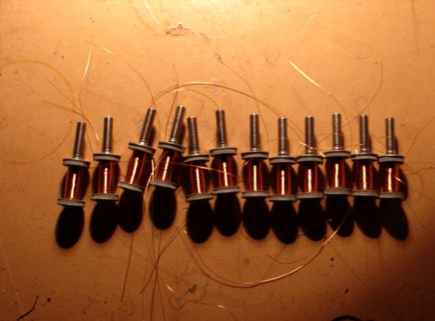

all the coils are hand woven... they look like this :
i didn't count the turns, as i used a power drill to wind them. they measure at 8 ohms.
perhaps they are covering to much space on the bobbin... would a coin shaped coil work better than a cigar shaped one?
can't tell how exactly those are made - AlNiCo core seems to be commonly used in the patent lit for the magnetic core to have some permability and DC field bias

do you have an idea of the string motion range - how close the sustainer can be, or how big a gap if you use a more efficient magnetic core shape?
