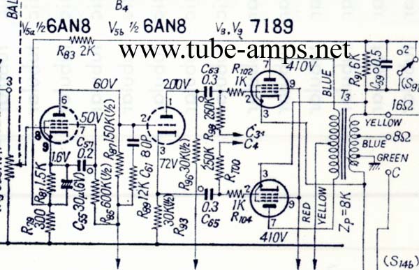

I have output transformers from the Sansui 1000A receiver and their transformer number is 410-5234 and sometimes they are labeld 1000A and sometimes both numbers are labeled on the end bell. So most likely your transformers are from the AU70 integrated amp which uses 7189 tubes. Although according to this schematic the impedance should be 8K.

Thank you very much for your effort and the detailed information. The schematic you attached shows the OPT impedance as 8K, just as the 7189 data sheet. Judging by the labeling of you 1000A transformers that shows “1000A”, it appears that mine are indeed from an AU-70. I have to get to the bottom of this impedance discrepancy. Could my transformers be shorted? Who knows!!! I bought them as a set including the mains transformer, which was definitely shorted. Thanks again, directdriver!!!

The method to estimate the primary impedance consisted of multiplying the impedance of each speaker tap with the turn ratio squared (turn ratio different for each of the 4, 8, and 16 ohm taps). Because of measurement inaccuracies, the calculated impedance values ranged between 6,150 and 6,600 ohm, the average being 6,300.
I made a mistake in my previous post. The average impedace is 6,300 ohm, not 6,600. Sorry.
By th way, I determined the turn ratio by applying 15, 10, and 5 volts and measuring the voltage on each speaker tap. I did a total of 9 tests, good enough for estimating purposes.
One measurement should be good enough under the right conditions: e.g. midband frequency 400 Hz or thereabouts, with a resistive load on the output, and preferably at at least a volt output or more. Also did you observe the output waveform on a scope?
What I'm saying is that low voltage unloaded measurements at certain frequencies could introduce gross voltage errors. Even the simple winding DCR can account for 10% difference in actual turns ratio vs. measured voltage ratio. If the 8K ohms specified includes say 10% DCR (primary plus reflected secondary), and you measure without a load, then your impedance ratio could be off by something like 20%. Add to this a little overshoot due to leakage inductance at low voltage and you may have explained your discrepancy.
In fact, if your most representative measurement was the highest, 6600 ohms, and your DCR component causes a 10% voltage error in an unloaded measurement, you have exactly 8K... Assuming the 8K is measured with the rated load.
