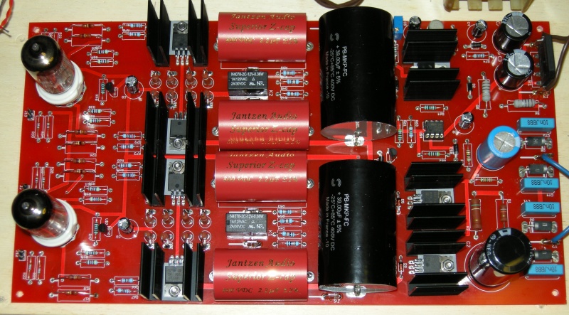

Universal hi-end hybrid output stage for DAC
Wow, I thought I was wrong going in similar direction, or I was just too lucky that it sounded so good. So it is not a bad direction at all. But the resolution really depends on the quality of the power supply. Must be decided by listening test. Shunt, coils...
All I meant was that it's been shown that a passive I/V resistor's value strongly affects the distortion performance of current output DACs. The lower the resistor's value, the lower the distortion. So, I don't see passive I/V as being the highest possible resolution, though my own design doesn't have a zero input impedance either, but it's pretty dang low. Anyway, good luck with your project.
pcb ready

last photo of balanced version
