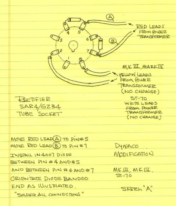

these are not shown on the schematic? how can they be added to the old design?
There is no provision on the old PC board for these parts. It is easy to do off board, and I explained how in a thread somewhere.
You can add the diodes by soldering the anode of a diode to the end of each red wire on the power transformer and covering it with heat shrink tubing. The stripe (cathode) on the diode is the free end. It is inserted into the terminal strip on the PC board where the red wires were.
You can solder the CL-140 to the power transformers red/yellow wire and insert the other end into the boards terminal for the red/yellow wire. The CL140 has no polarity.
Both of these additions are for improving the reliability of the 5AR4 tube and do not affect the sonics of the amp. Ordinary 1N4007 diodes work fine since the characteristics of the tube rectifier prevail, but you can use fast rectifiers (FR4007) or other exotics as long as they are rated for at least 1000 volts and 1 amp.
