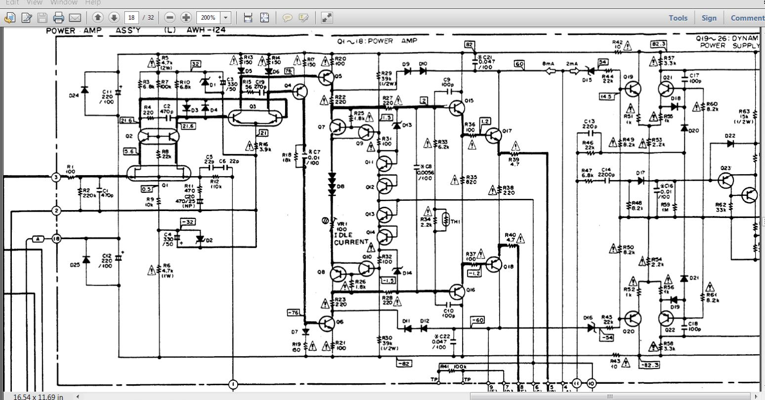

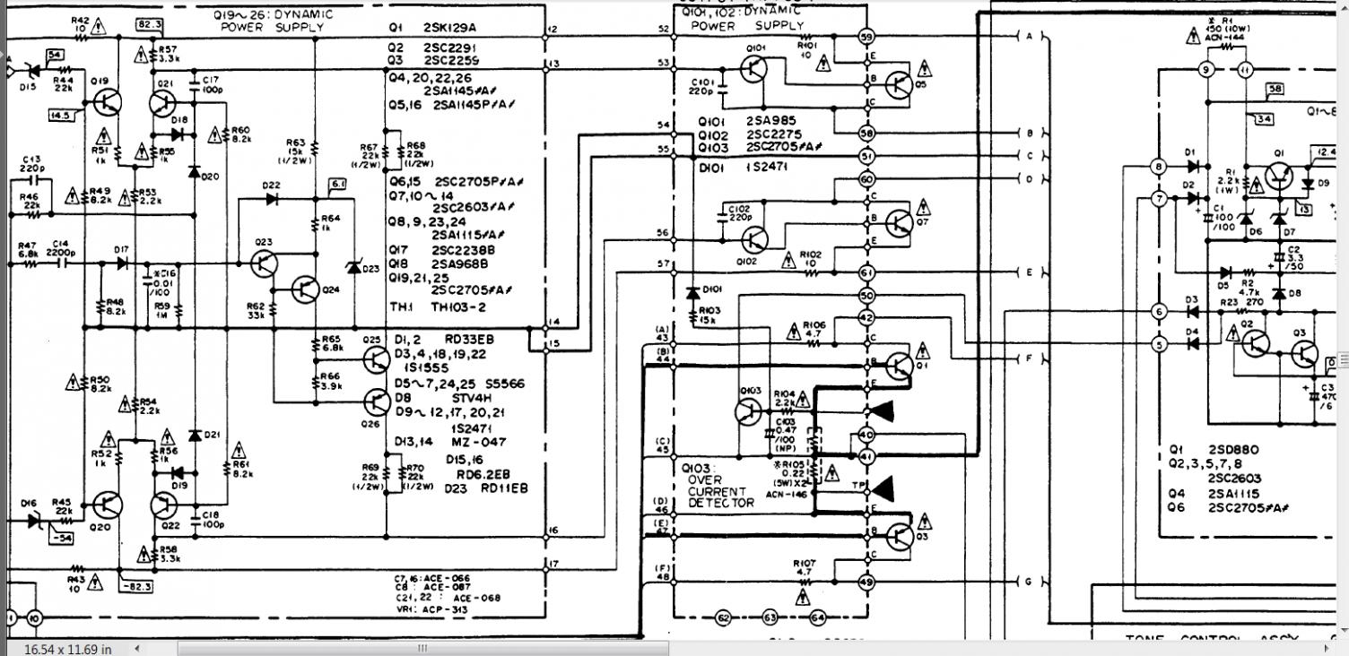

For anyone interested this was the Pioneer A80 (sorry going a bit OT here).
I was deeply impressed at the time by the complexity of it and yet something like the JLH69 would eat it alive for sound quality.
I'd forgotten how scary those rails were too.
-/+ 82 volts for the main amp. The outputs ran on a much more sensible (lol, you can not be serious) lower supply of around -/+65 volts only switching to the higher rails when needed... which was probably never.

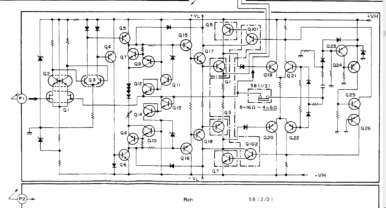

Mooly, is an interesting comment and one I have also mentioned on Harrison's (OnAudio) thread. You say the front end runs on its own supply, remember the thread regarding the Goldmund about a year ago, it also had separated the supplies.
Hugh Dean decouples his front end from power stage with diodes. All of these amps are said to have "exceptionally clear sound with very defined and deep sound stage" could the ripple be the primary cause of smearing the sound and is it primarily affecting the front/driver end.
Correct me if I am wrong, but could an amp with good regulated low ripple rails on the front end be the main requirement for a good sounding amp while the output stage need not have a very sophisticated supply at all.
In other words should we spend less on mega farads power supplies when 4700 uF (or less) will do and pay more attention to the front end driver stage power supply ?
