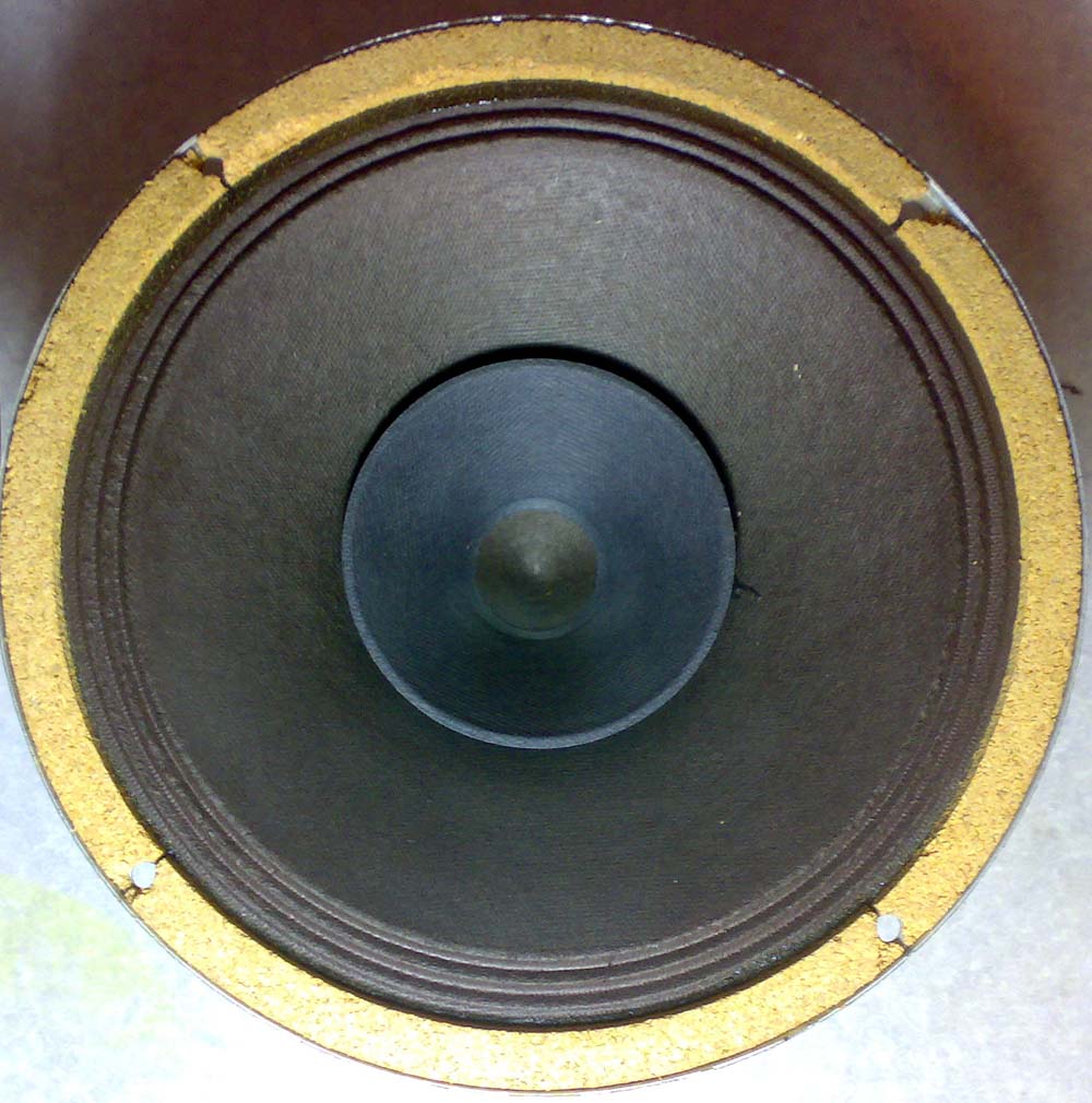

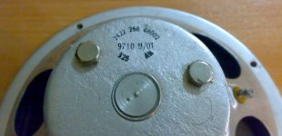

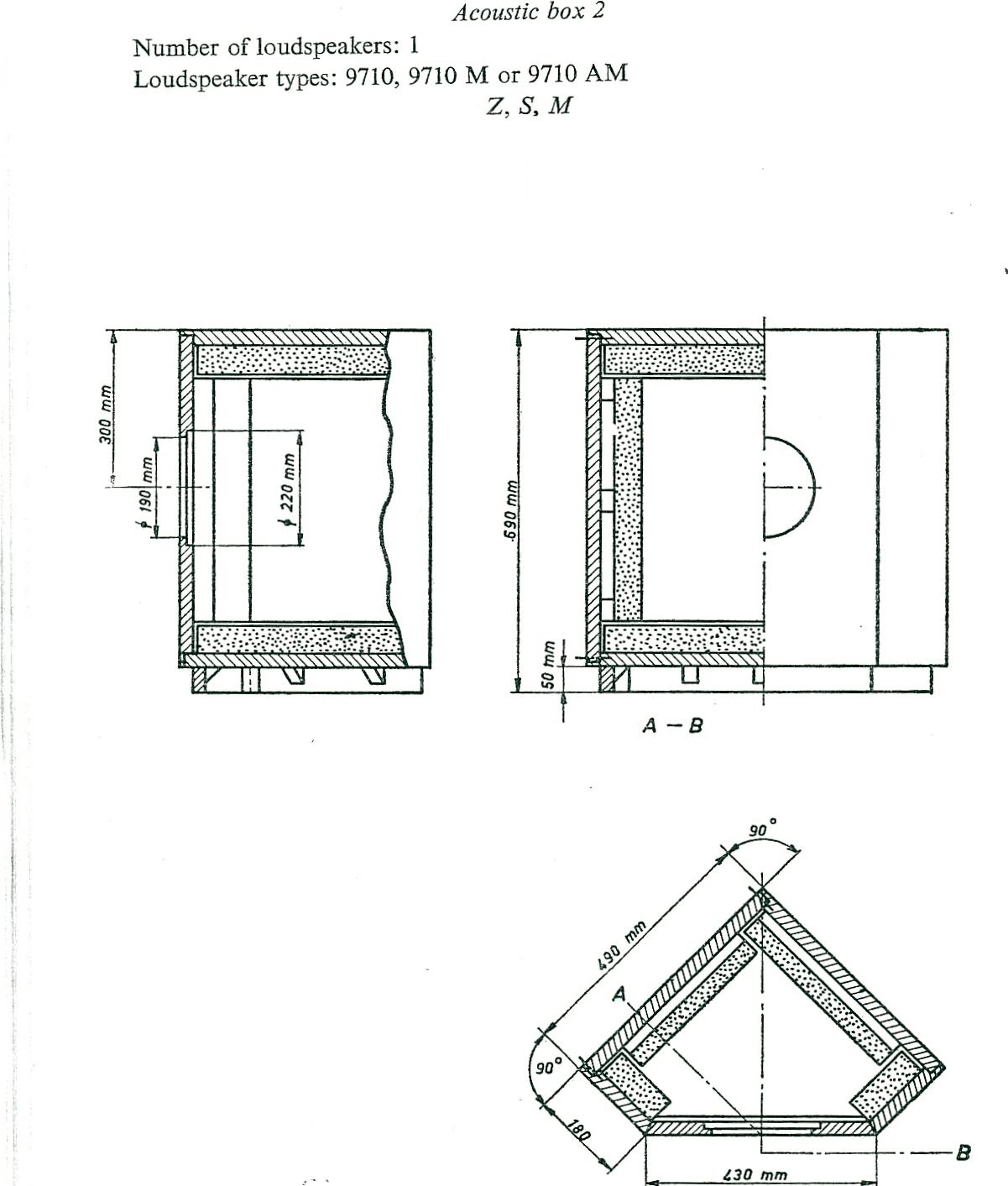

I took these two Philips 9710s today. they are like-new both are alike. I want your idea about enclosure. there is no limitation in size

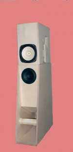

Nice vintage speakers! If you don't have a wife at home then this might be interesting to look at:
More information can be found in this nice article that Nelson wrote: http://www.passdiy.com/pdf/KleinHorn.pdf

Uh come on holly lord will punish me in an other-worldly place kiddin' aside, they are neck-breaking to build. I want something easier
You should probably start with gathering more info on these drivers. Especially the T/S parameters. Measure them if you can or search the internet. With this info you can properly sim enclosures..
as these are very famous and widely used speakers, I wanted others opinion so I'll use their experience and build something which is successfully done before

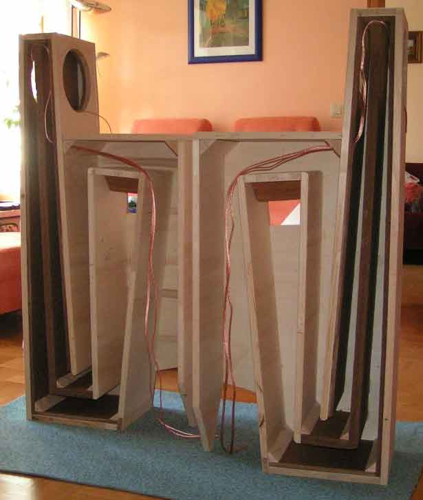

You said "there is no limitation in size", so I figured this would be a nice example of why you should take a limit on the size
You didn't read my post literally I said "they are neck-breaking to build" not "they are too big" I can't build something like this. BTW they are big!

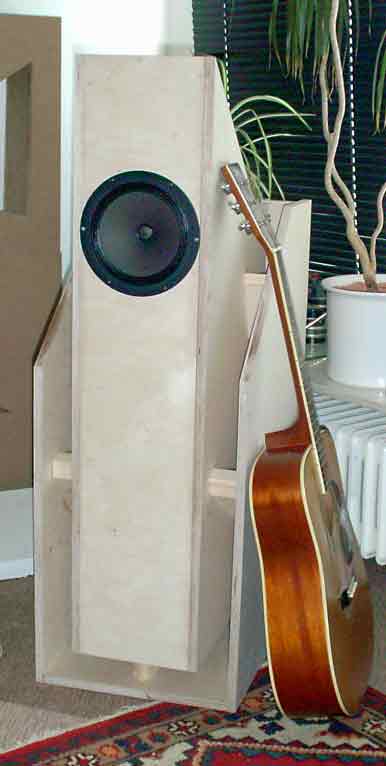

Hello,
for this driver may be my solutions an idea:
sathorn Schalmei, down 100 Hz
or double horns:
Posaune XL, Saxophon, RDH20
as a rear driver i prefer the Monacor SPH-210,
take a view
Hello,
or double horns:
take a view
Hello,
or double horns:
take a view
Most BLH designs are neck-breaking to build. Personally I am looking for a nice enclosure for my Coral Flat-8 speakers and I am thinking of building Lowther TP1 enclosures. The reason why this design is very appealing to me is because of the double horn (one in frontside and one on the backside).
The building plans for these enclosures are available on the web if you search properly. The Lowthers are build out of allot of different sized / shaped boards, these plans are insane and not for the beginner

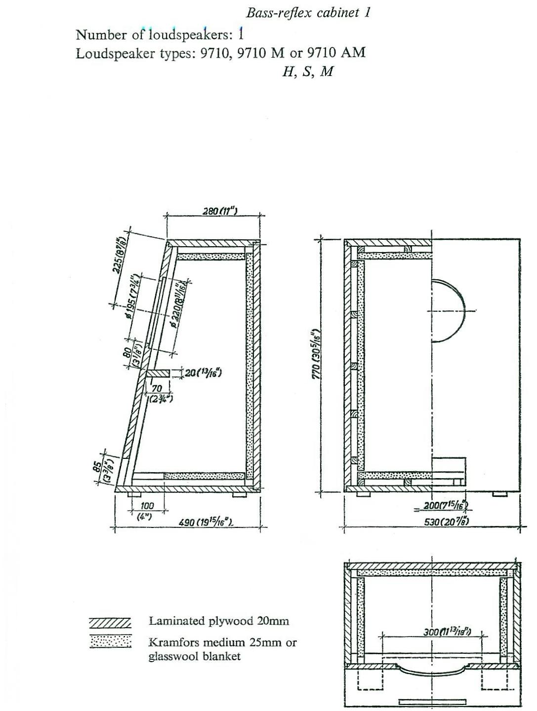

An 88 litre internal volume vented enclosure tuned to 40 Hz is a good match for the Philips 9710M/01.The braided voice coil leads need to be checked and replaced if necessary as they have a tendency to harden with age.There are some simple refinements for this driver and a cowl of 'Tontine' or similar fitted snugly behind the frame is one of them.A slot diffuser fitted at the front can help alleviate an aggressive high end and a suitable coating (flexible) applied to the corrugated surround will preserve this item for a long period.

Hello,
yes,
the driver need support up to 800 Hz + rolloff,
in the Schalmei double horn sat you will get it,
and you need a good sub,
in the double horns with rear invers driver
you get support up to ~2 kHz and a best bass
by delete the bass imp in the lowest oktave.
look:
Schalmei-Sat
saxophon
RDH
9710 is a good driver in the right enclosures,
try it without added tweeter

Hi, these are some nice drivers you got, they look to be in fantastic shape!

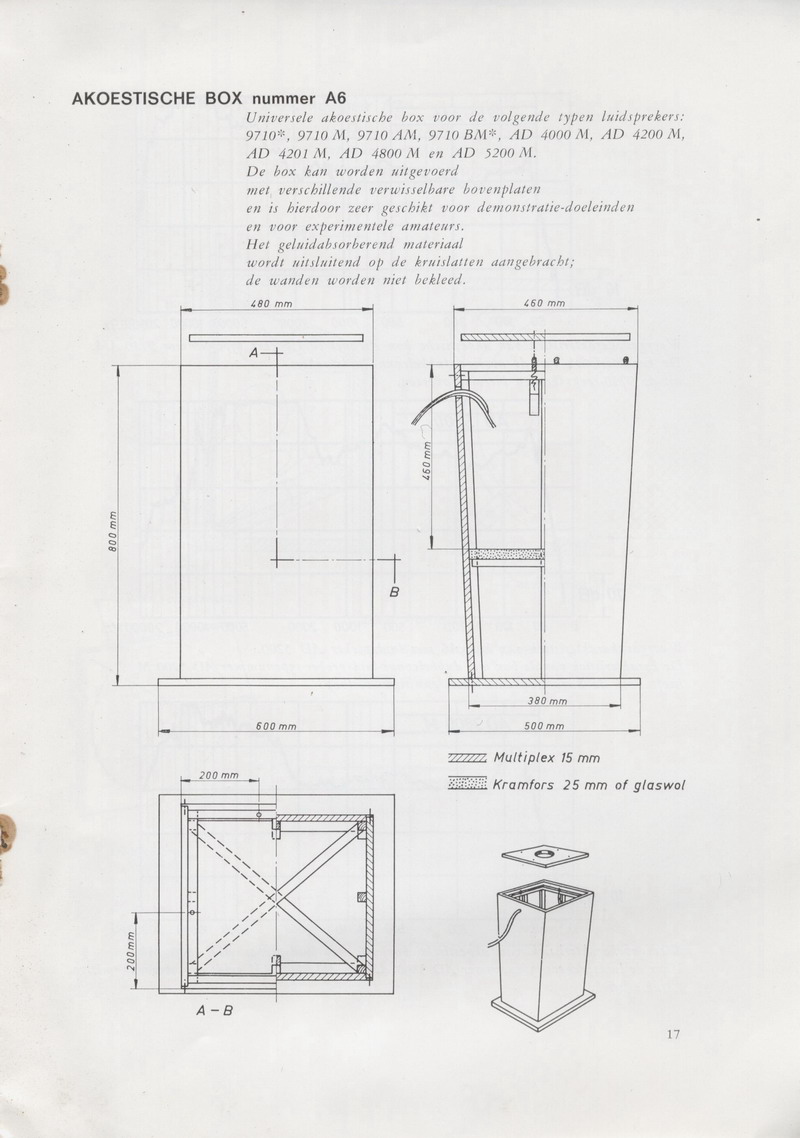

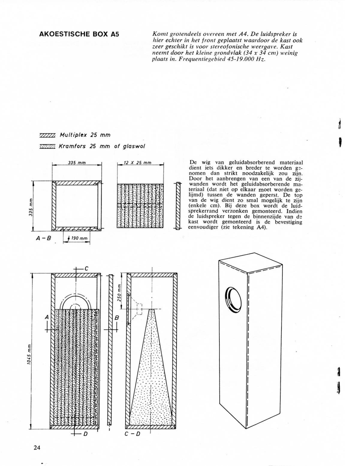

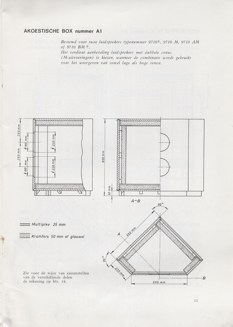

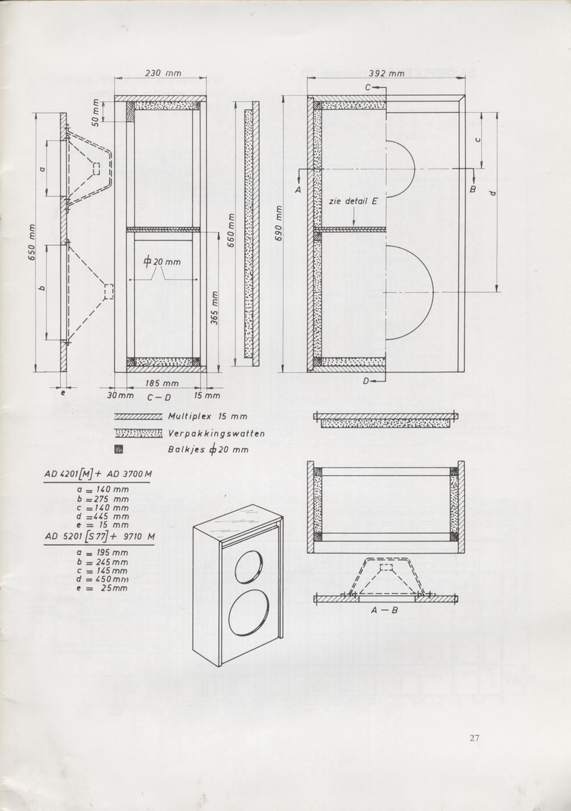

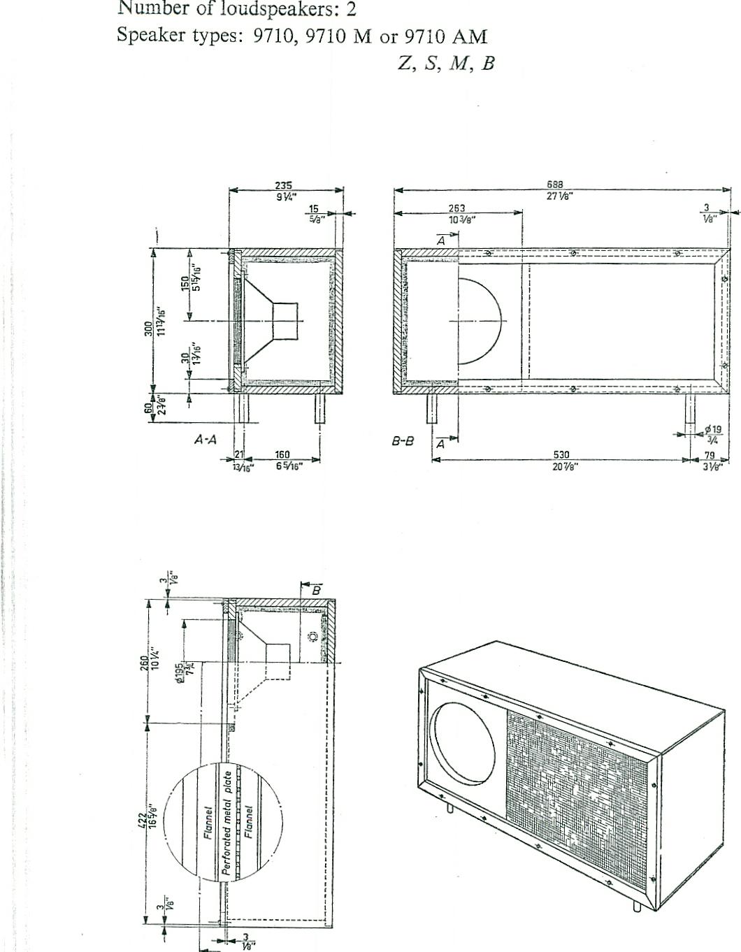

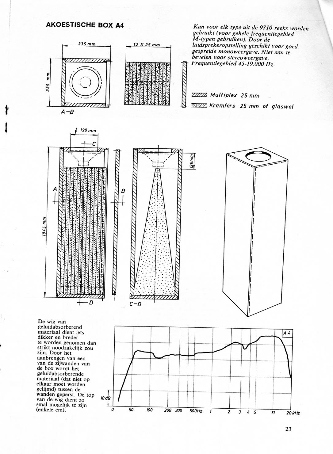

I have a pair of the ceramic magnet version, which has pretty much the same parameters as yours. I used mine in Karlsonettes and they do pretty good, but I believe a better Karlson could be designed for them. AD9710 is on the left; on the right is Richard Allan CG10T.

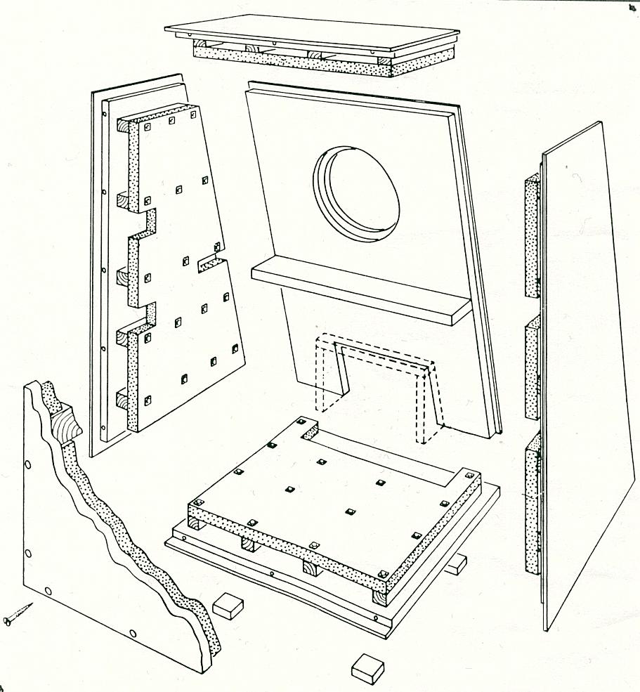

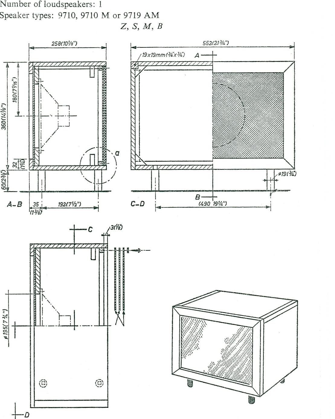

A big-@$$ TQWT might be your best bet for these. I've attached a variety of Philips enclosures made for the 9710 that I have collected.
IG
IG
I actually bought the TP-1 plans from Lowther and scaled it down for a 5"driver. The plans were a mess with the horn both expanding and contracting, my guess is that they converted if rom imperical measures to metric and someone less talented with calculator doing the job and then not bothering testing the results obtained. The top vibrated quite badly as I recall. In hindsight I can not understand why I built such a complicated design for such a crappy driver. I think it was a cheap Japanese driver with a dual cone thing in fake aluminium
So if you build them make sure that the flare is resonable ( not negative in som bends) and that the parts fit together...
