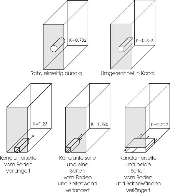

I have read in past somewhere that if an enclosure's vent is part of the walls of the enclosure then the length should be counted as having the extra half of the vent's height.For example if a vent has dimensions 40(L)x10(W)x20(D) then the total depth should count as D+1/2(W) or 20+1/2(10)=20+5=25.In simple words it it should be counted as longer than it measures.
Do you agree with this?It sounds like a rule of thumb but seems to have some validity since the 3 walls are extended into the enclosure and only one side,the single wood part is of specific length.
with a 1:4 slot ratio, I have typically seen about a ~40% reduction in required port length for a given cross sectional area. Conversely, only ~60% of what theory predicts for length needs to be used in such a situation.
I have here a 1.75 ft³ box (after all displacements) that with a 3"x12" slot port (using 3 enclosure walls) that is 32in long. See if you can find out what frequency it should be tuned to, and then I'll surprise you with what it's actually tuned to.

Even that K=2.227 is not that accurate

The "K" is called the end correction. It has a certain place in the equation for port length. It modifies the final length calculation to account for different scenarios. You can easily google this equation.
Missed this one...Its accurate as including the floor effect in front of the enclosure.
b
Then why does that correction factor not correlate with my measured findings? Unless we are applying that correction to different port-length equations.......
Granted my slot port has a bend, but I believe it to be of large enough area to be of little significance.
