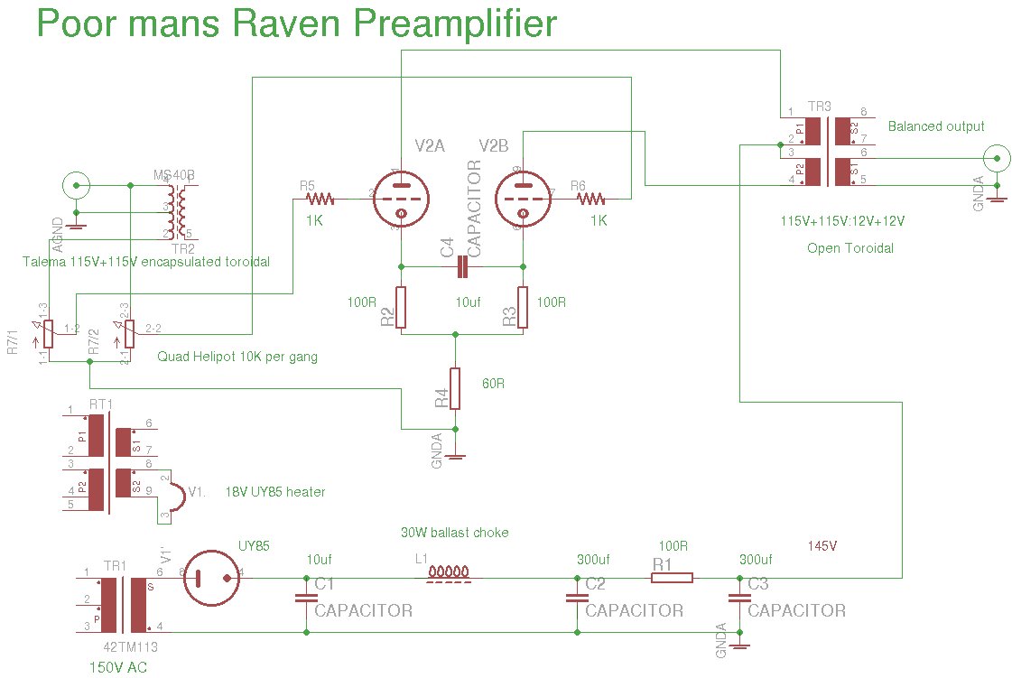

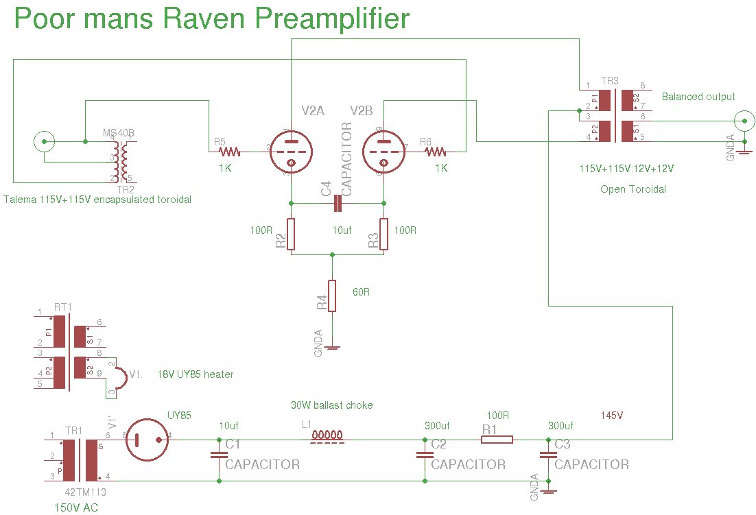

Hi all,
I have been working on a version of the Raven preamplifier by Lynn Olsen. Since I couldn't afford the expense of LL1660 transformers I have substituted cheap and cheerful Toroidal power transformers for both input and output duty. I used Taleman encapsulated transformers as a center tapped choke for the input. These drive a quad heliopot (wire wound pot at 10K) which in turn drive a 5687 into the final transformer. I attempted to use the same taleman encapsulated transformers at the output - but the encapsulation increased the interwinding capacitance to unacceptable levels. I therefore substituted some open frame toroidals with a step down ratio of 115V+115V:12V+12V. These generate two separate outputs - one for my main amp and one for my active subs. So far they are working with just a 10uf cathode to cathode bypass and each cathode is biased with a 100R resistor followed by a shared 60R resistor - DC current balance is less than 0.3mA different. I will eventually add a current mirror.
Power supply is dual mono using a UY85 followed by a 10uf cap > a florescent light ballast choke > 300uf > 100R > 300uf.
Source selection is via reed relays.
So far it is running whisper quite with AC heaters (and a rats nest of interconnecting wires). Response is good to at least 20khz and down to 10hz (though I haven't measured it in detail). Comparing it to my ECL80 FVP5 SLCF clone it betters it in nearly every way. Bass is better defined, detail is better. Everything seems to have a more transparency and life. Frankly I am amazed at the difference.

Heres a rough of the schematic. Picture to follow.
Shoog

Because it is operating as a center tap choke - the demands on the input transformer are relaxed. Basically I have found talemac to work excellently in this role in a number of implementations. Source impedance should be low - but I have not encountered any issues with standard CD players and other components. EI transformers will not subsistent for toroidal and open frame will always be better than encapsulated.
Something to be aware of is that the primary side of the transformer can be wired up in two directions and one will sound better than the other. This is because one end of the primary winding is closer to the core and there is higher leakage capacitance at that end.
After a few days of listening I decided to load the output secondaries with a 1K resistor to calm down the top end a fraction. My experience is that a fixed 1K load will generally improve performance.

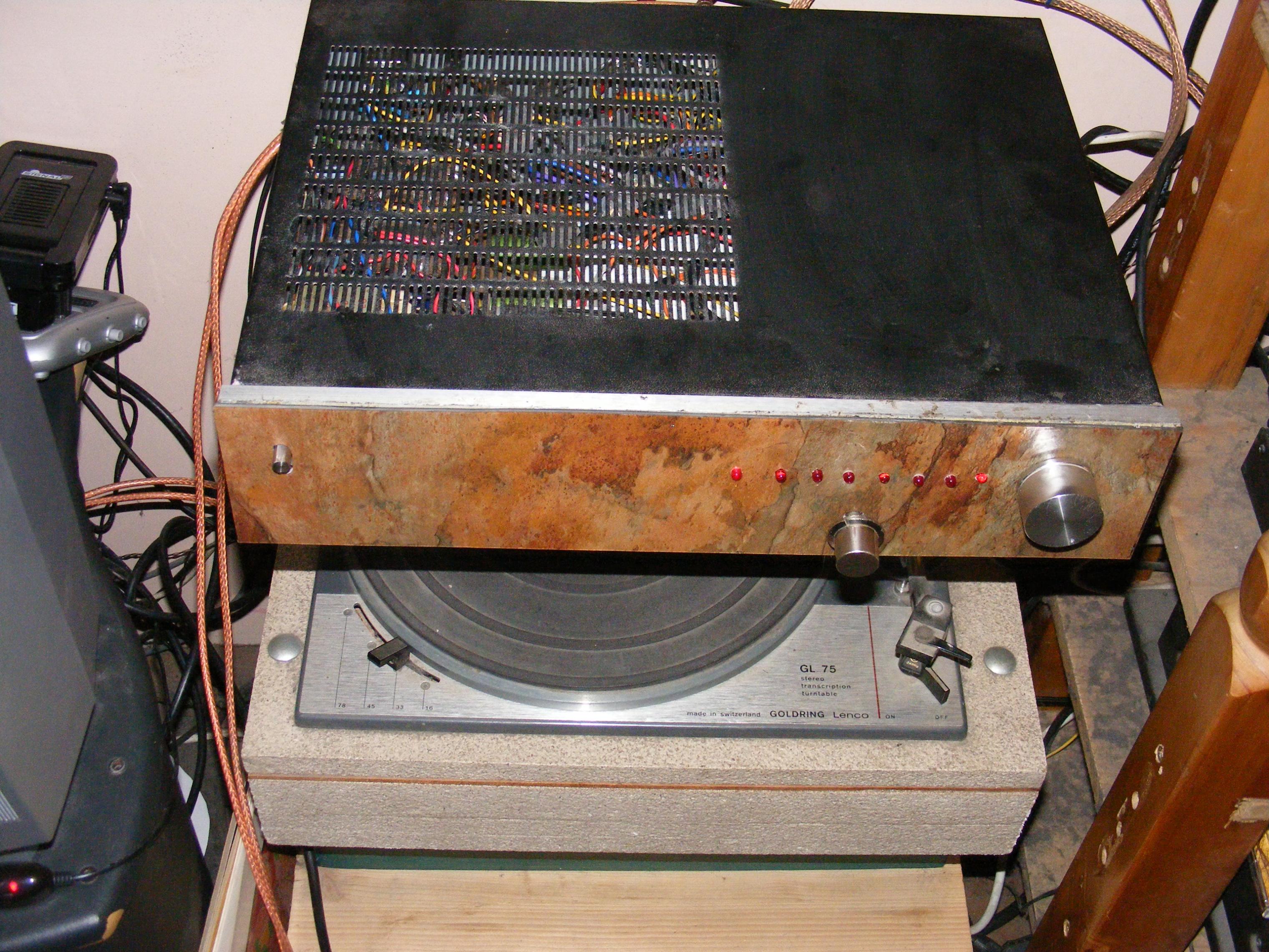

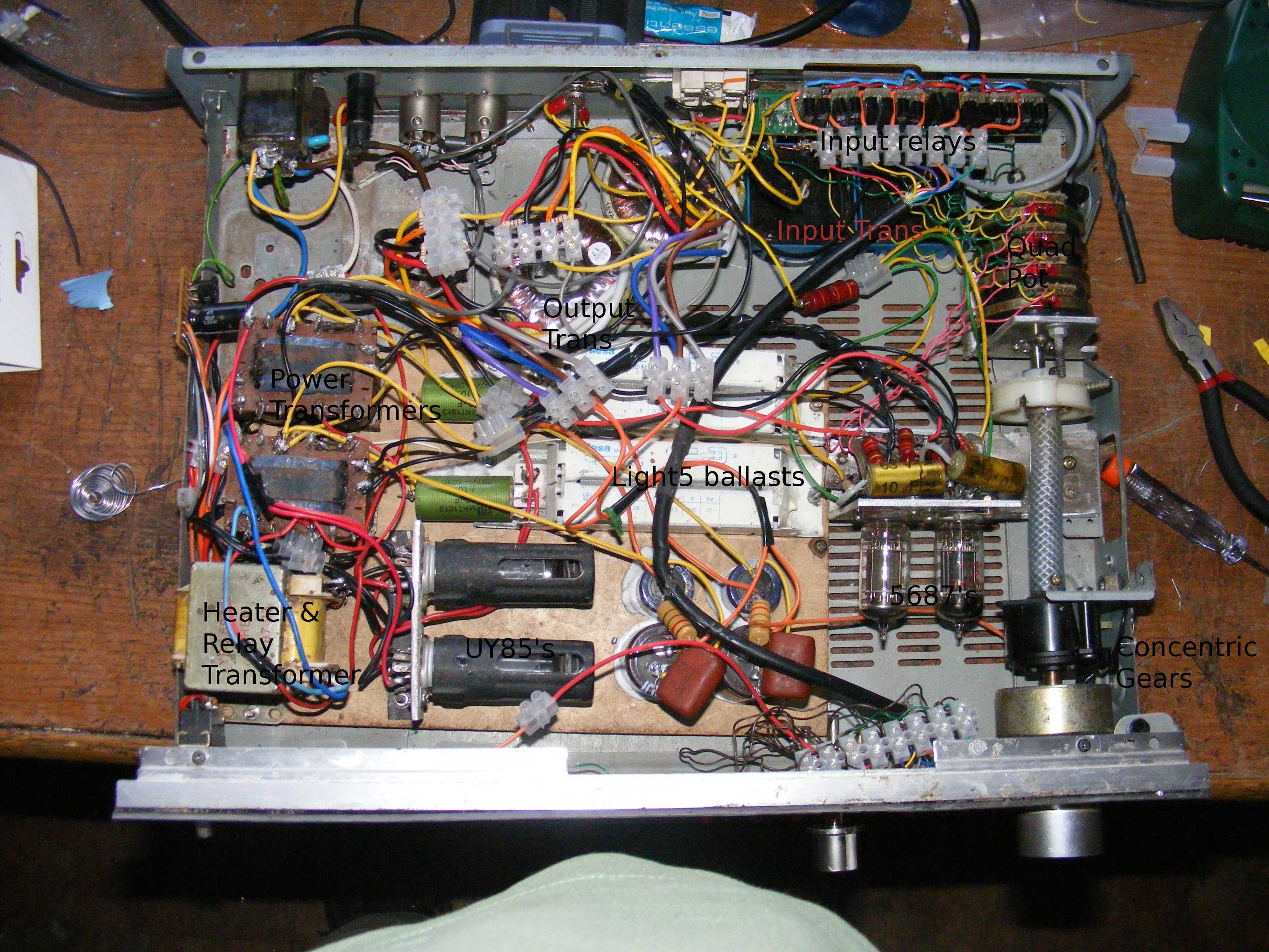

I promised a picture - though I have to say I am not proud of the look of the beast.
It just goes to show that strict adherence to star grounding (at the back where all the yellow wires go to) is more important than neat wire layout. This preamp is quiet - real quiet.
I will look for the details of the transformers used. The main power transformers are some nice little C-core models salvaged from a reel to reel tape recorder.
Shoog

The intention is to eventually replace the 60R resistor (common) with a current mirror and two 100R resistors. This will raise the cathode resistance considerably (I believe). This is essential as even though current balance excellent at the moment - it will drift over time and start saturating the OT. The 10uf is a full bypass from cathode to cathode making it an effective LTP output stage. I may raise this to 20uf - but the calculated increase in bass extension appears to be marginal until you reach many 100's of uf.
So the intention is to allow for different bias arrangements whilst maintaining full differential LTP behaviour.
