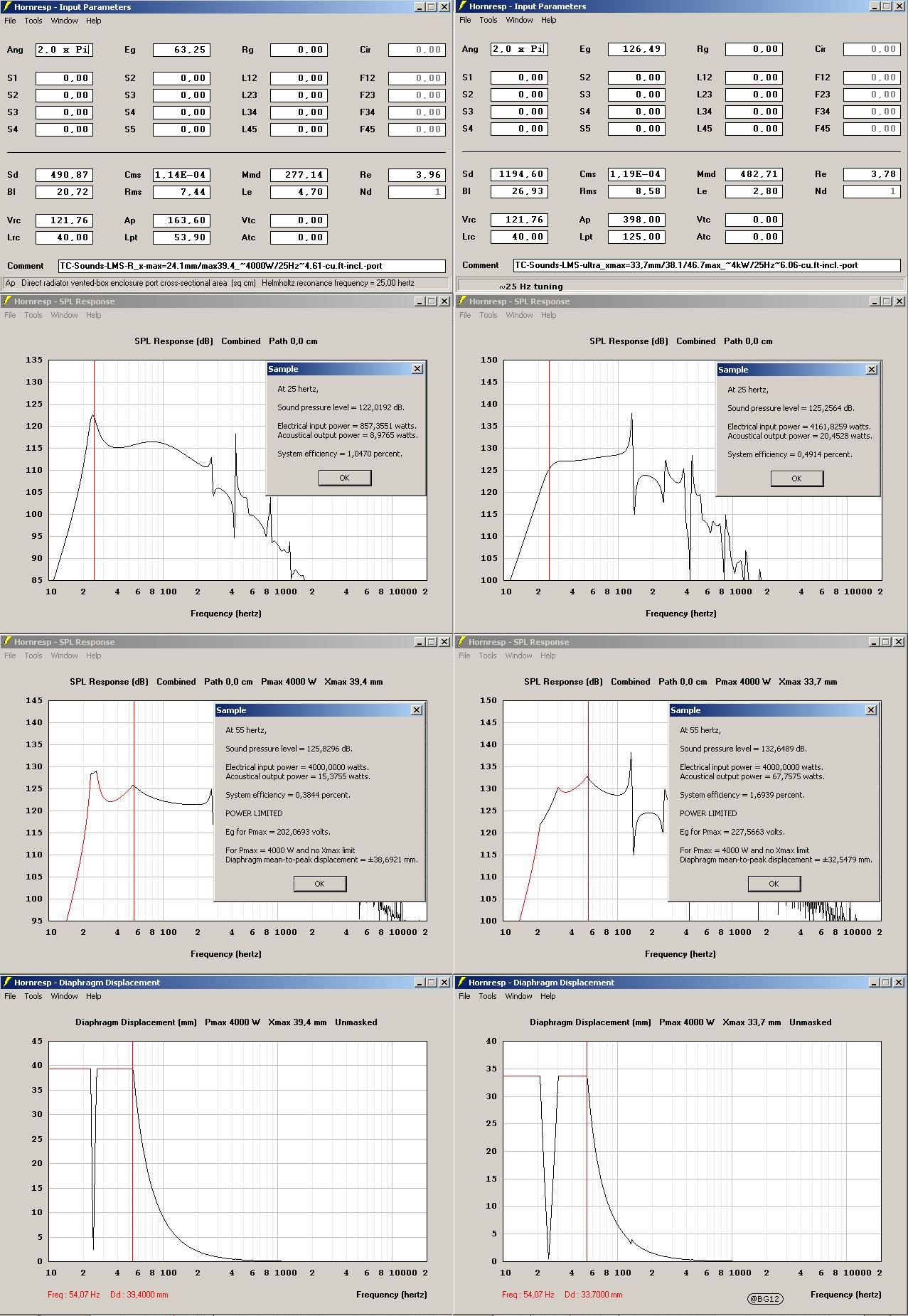

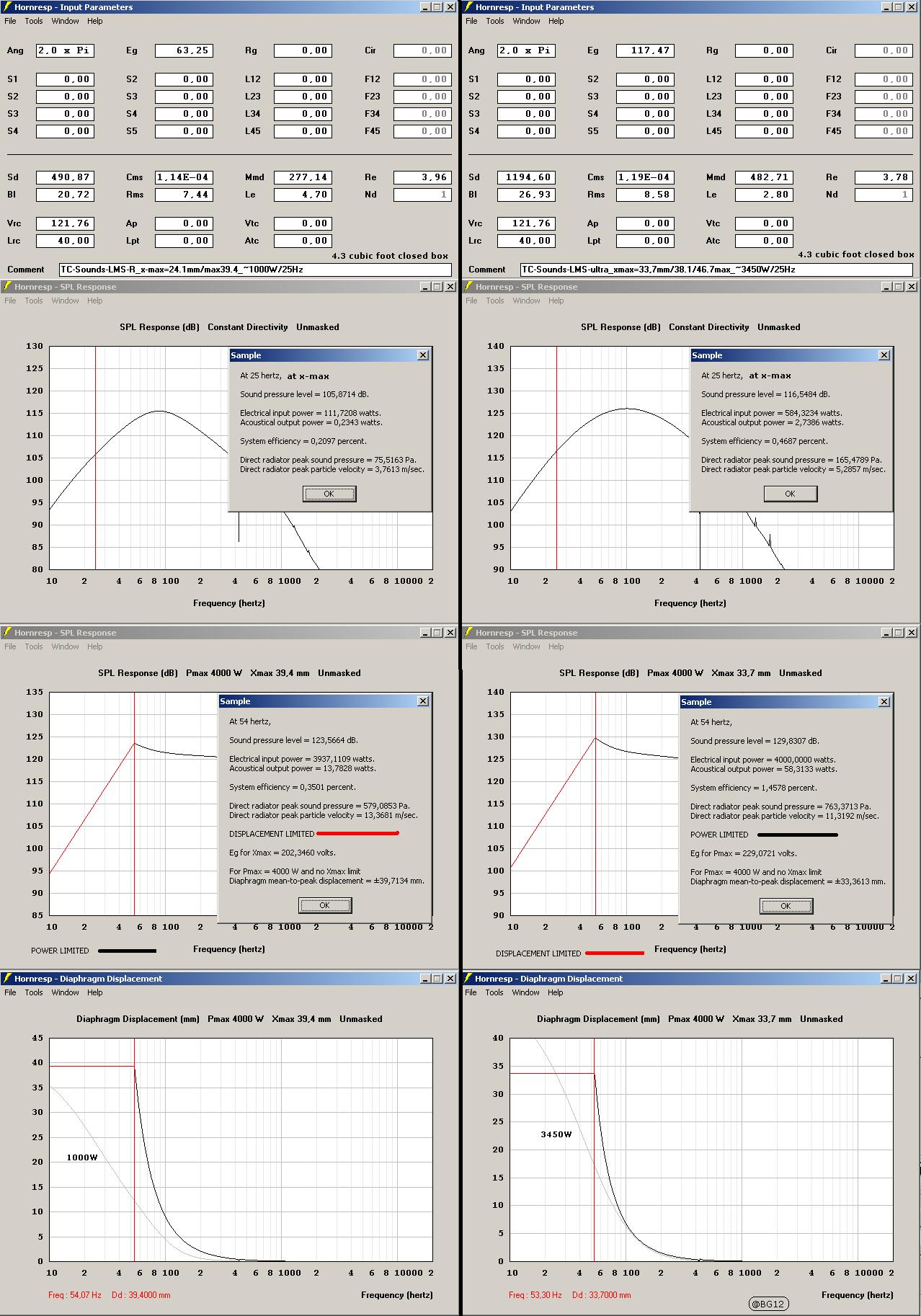

What I was looking for was an estimate of power reached at xmax for both tuned to 25hz. I did forget to say they would all be in a 4.3 cubic foot enclosure for each driver. I think the 15 is close to xmax at 4000watts (2K each).

What conclusions do you find from these submitted pictures:
Note: You provided the prerequisites.:D

I have 3 20 amp circuits. Each Peavey CS4080 has its own line and the two remaining 2 channel amps run off a single 20 amp line for the MT active mains. The CS4080's are run bridged at 8 ohms. The LMSr 15's have never bottomed out.
I didnt think a LMS Ultra would bottom out at 2k watts tuned to 25hz. Run in series on a single CS4080 bridged is thus 2K watts.
I have 2 15's for the 4000watt input now and it isnt bottoming out. I was looking to see if someone could run the ported sim so I could see what increase in clean SPL I could get in my theater using the 18's. Regardless, the added power is still going to make it sound cleaner on peaks even if you dont use it.

Anyway, its 4000watts for 2 drivers in series so 2000 each not 4000 so I guess I'm fine for the swap and will get a bump in efficiency along with far less distortion from the drivers. Personally I always use the biggest amps for more headroom. You can damage a speaker way sooner with underpowered amps that clip than with overpowered amps that dont. You control damage with the volume control. Clipping amps still make far more power than their rated limit and exceed power limits.

Gaing 4db in efficiency is one benefit. The other is that the 5400ultras in this box cuts the group delay in half and I can add power later when I upgrade houses in the near future. I will have 100amp service in the new construction's theater.
