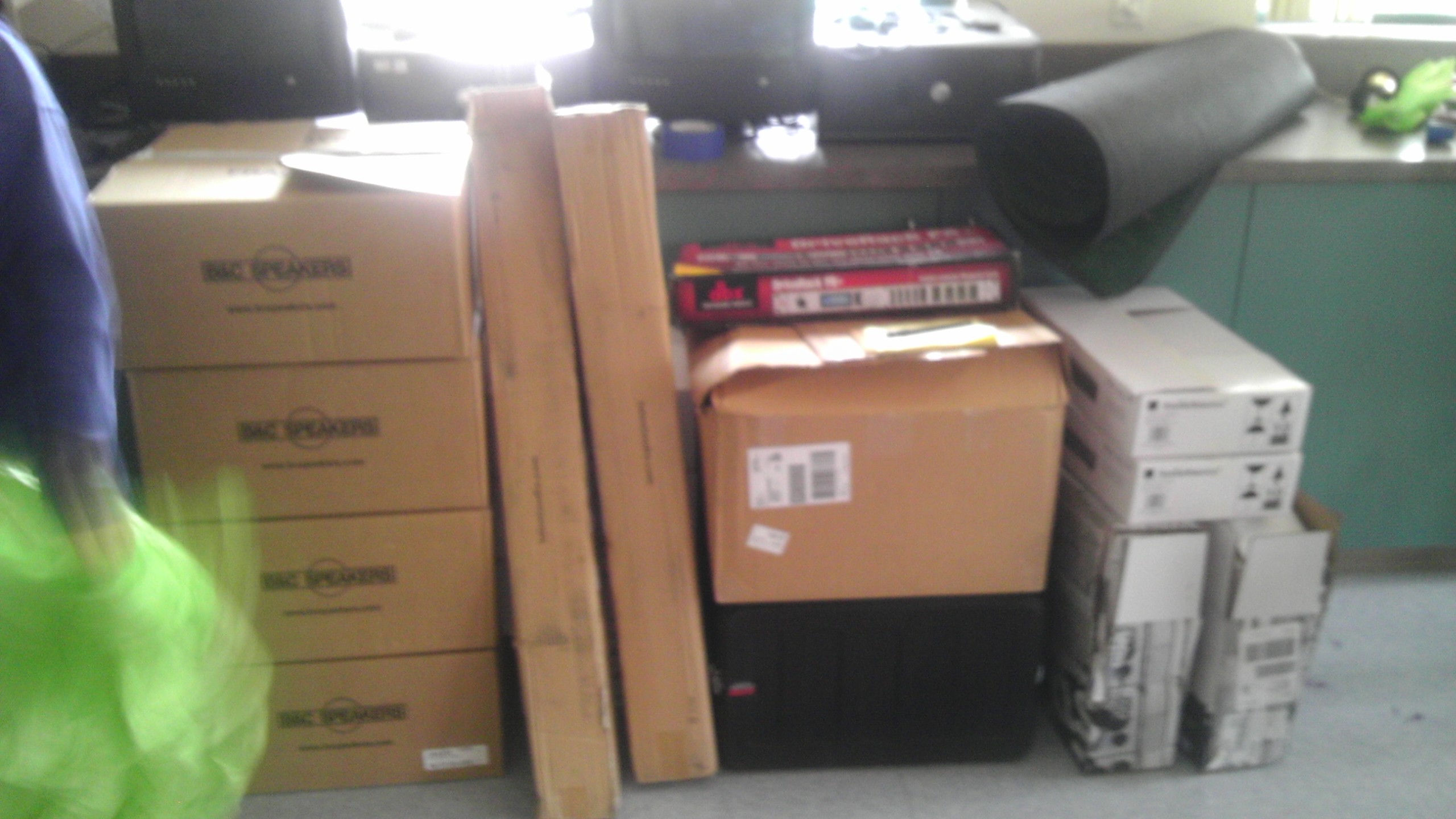

Alright ladies and gentlemen, it's almost that time.

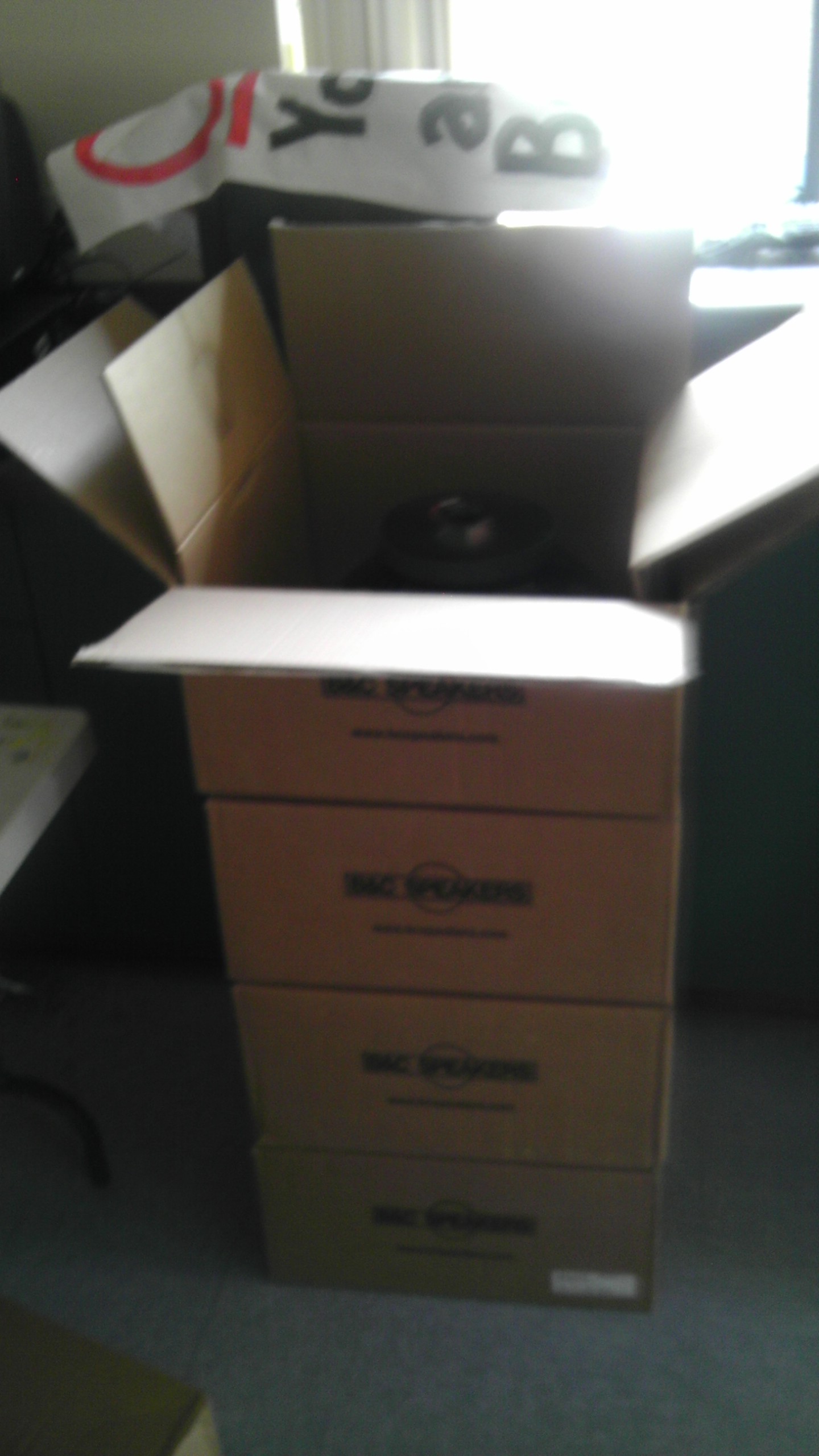

School is back in session, and my purchase orders finally went through. I am expecting 400lbs of gear from Parts Express friday, and about that much lumber from the local hardwood store in about an hour.

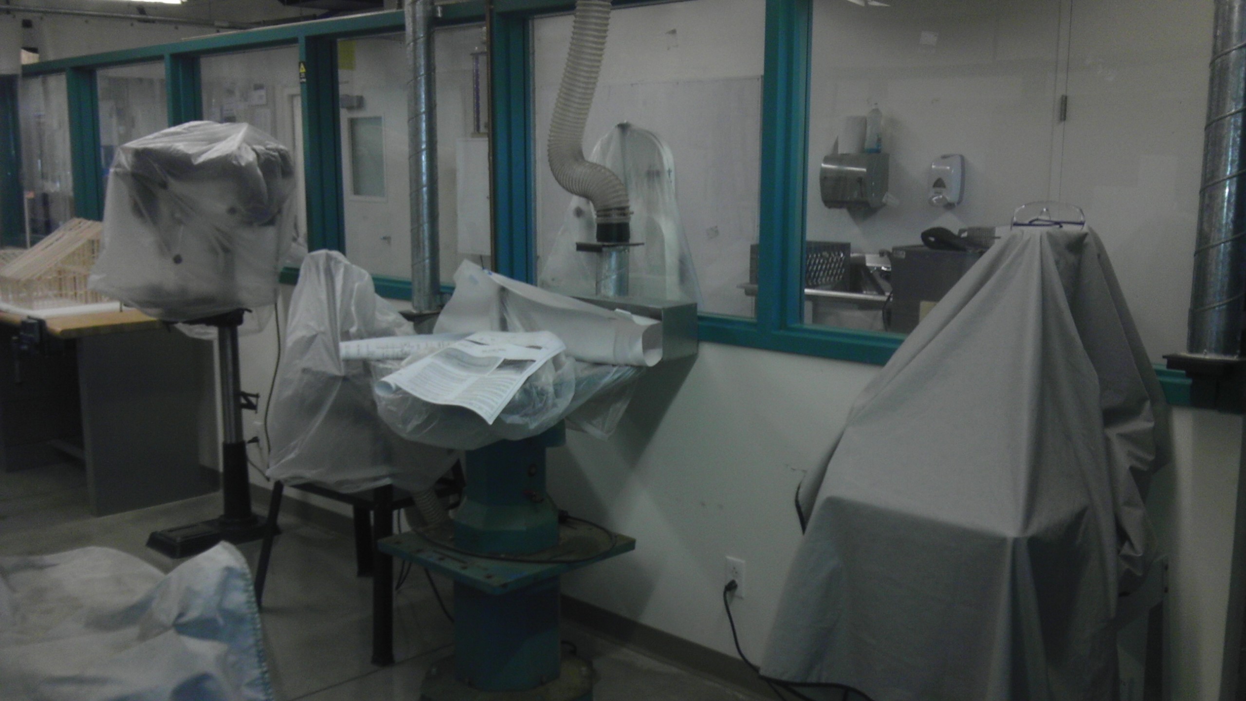

I will post pictures of the supplies as they arrive, but for now, a few of my toys.

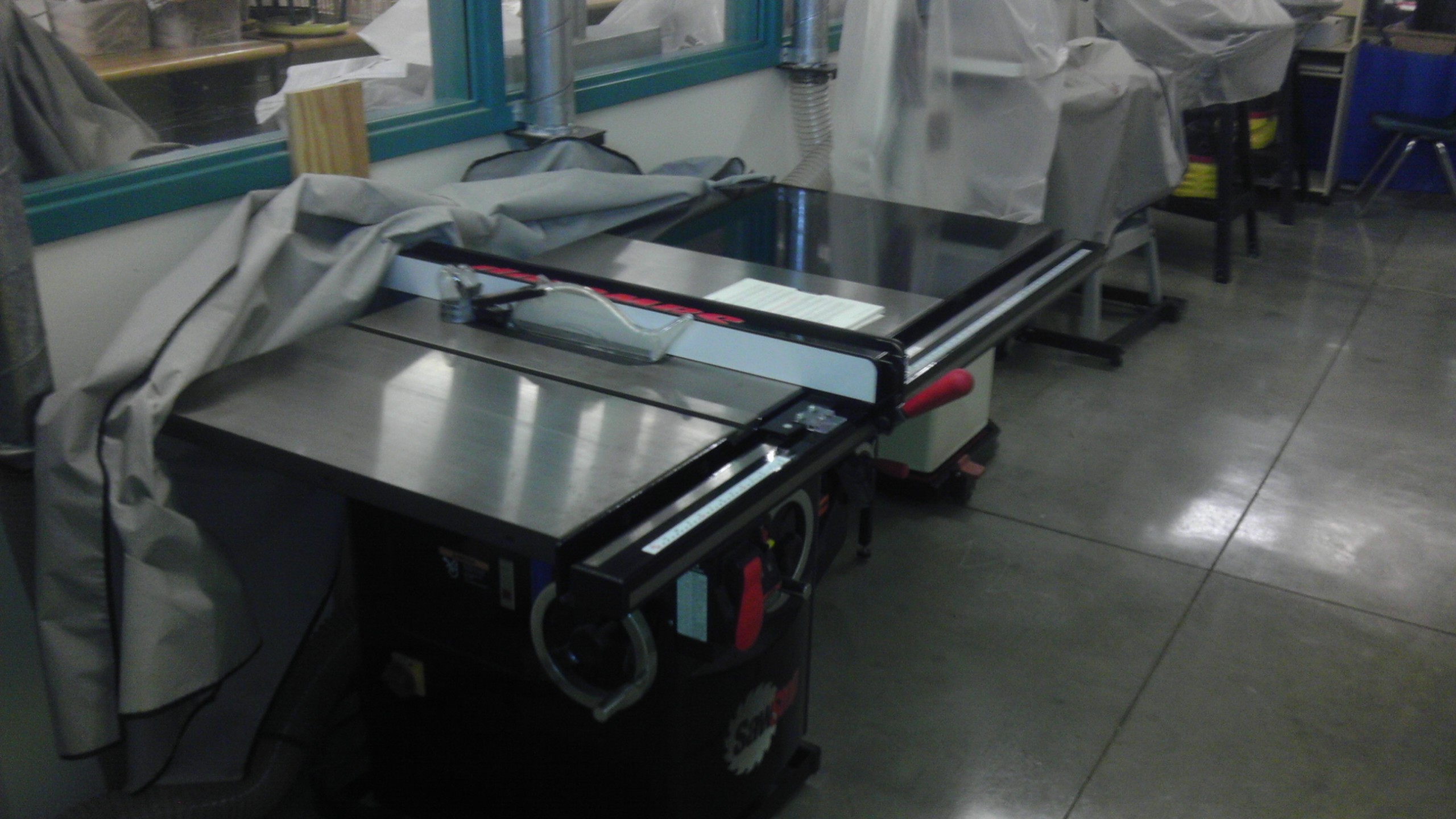

The table saw I get to use is a StopSaw, so there's little worry about getting killed or anything. One of my favorite things about it is that it has measurements in mm and in for the gate, which will be awesome for my metric cut sheets. It's going to be a dream to use, except that my engineering teacher insists that she be there whenever I am using it. Considering that I have been using a saw since middle school, and its the safest saw in the world, that's pretty annoying.

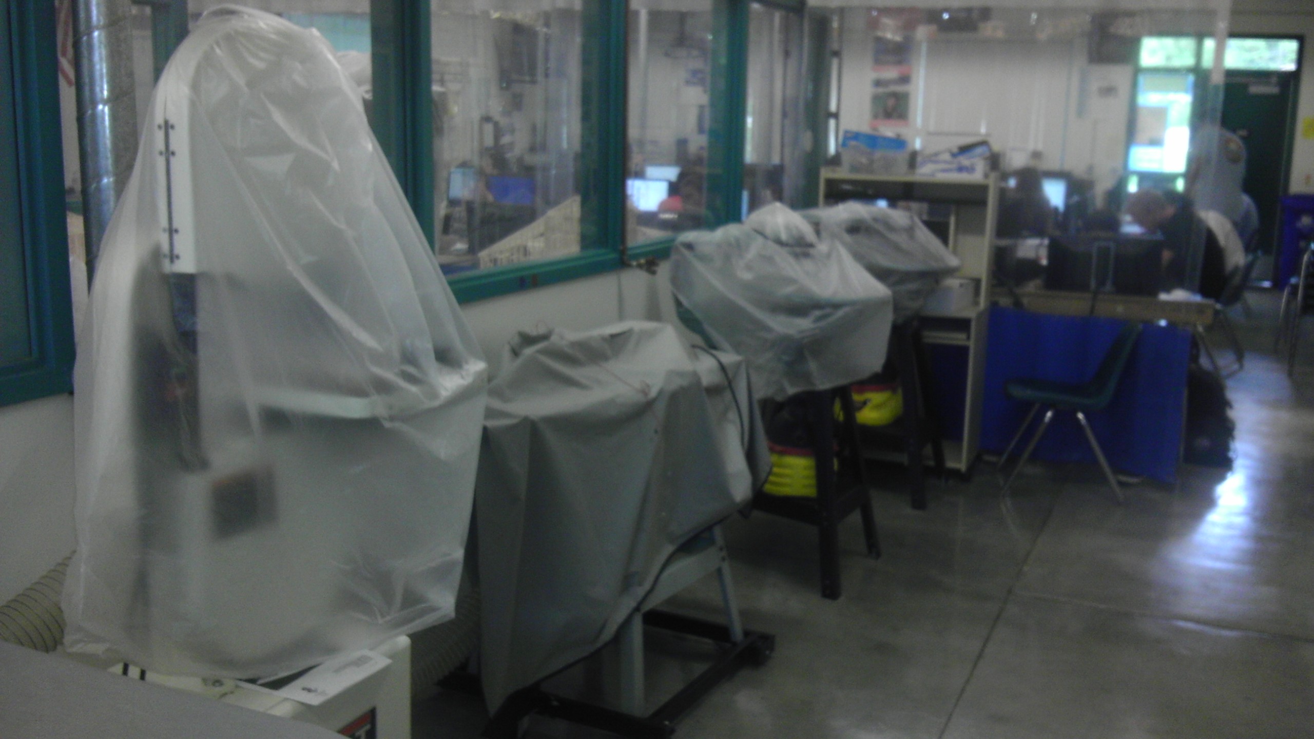

The other toys I should be able to use on my own. We have a couple of scroll saws, some sanders, drill press, chop saw, and a bunch of handheld tools. There is also a CNC but it's out of commission :( I will also be bringing in my own pneumatic brad nailer to hold everything together until the glue dries.
I should start making saw dust very soon, hopefully this week. I have my work cut out for me :)

Update
So it's about time for an update...
I've decided to start with the subwoofers because they will be able to go into action during this football season (the system they're using until mine is ready is REALLY inadequate).

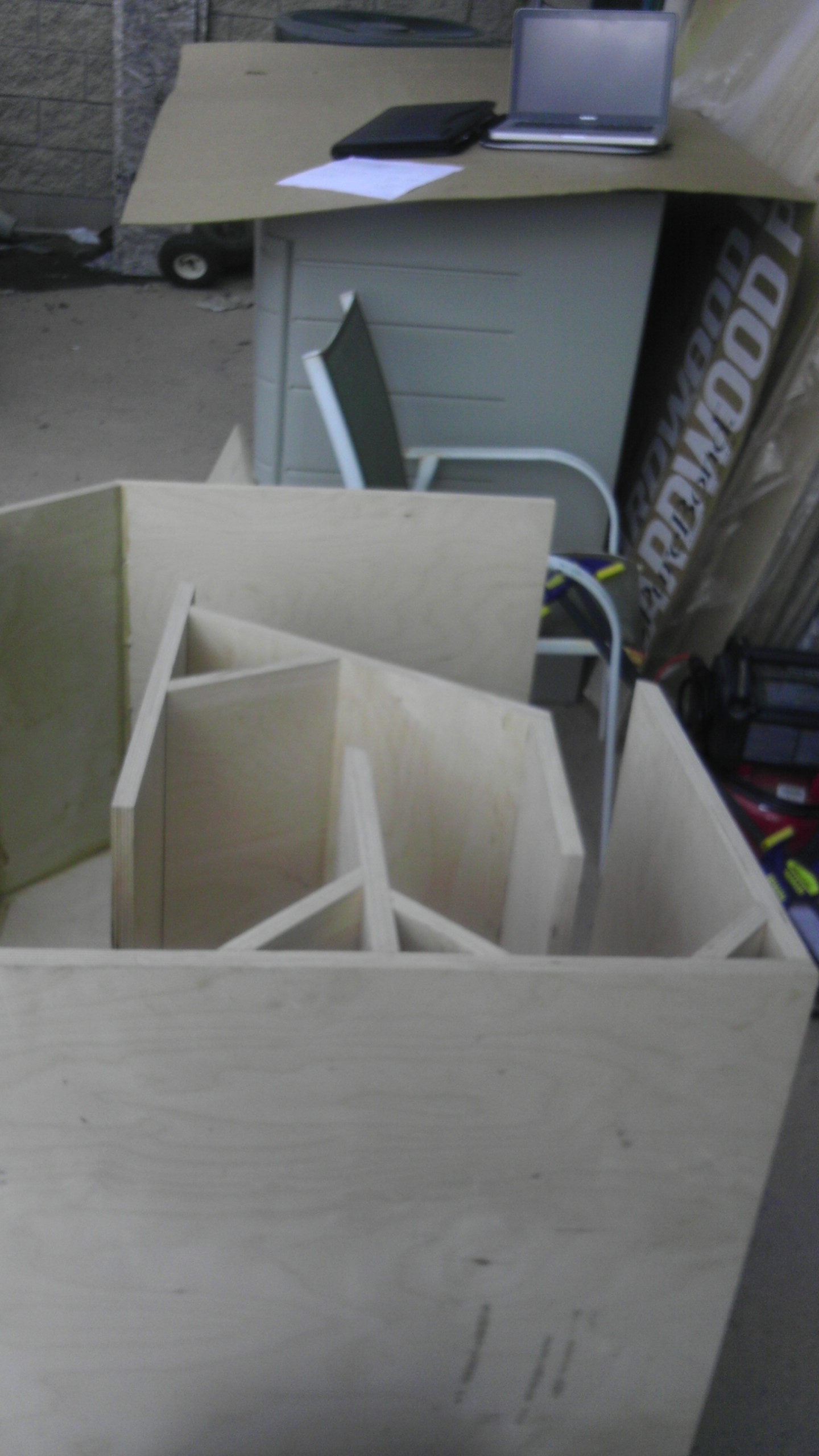

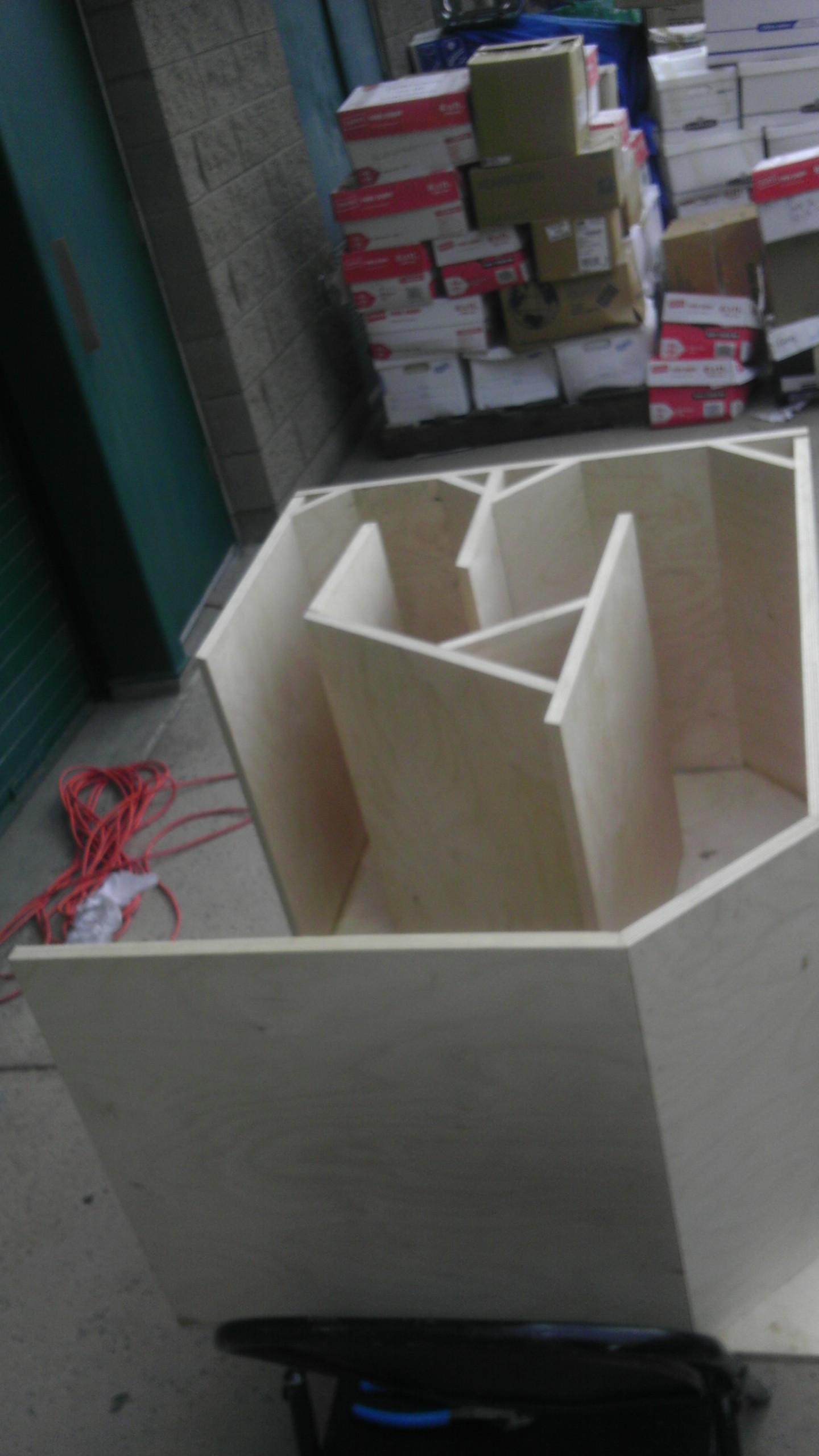

I started with just one of the four TH18s, I wanted to make sure there was nothing wrong with the cutlist and figure out all the tricks before going in whole hog. Once this one is making some noise I will cut the other three and build them simultaneously to boost my efficiency a bit.
So far it's going pretty well, I cut two boards wrong but it was not because of a cut sheet issue, and they were pretty small pieces so I'm fine on supplies.
I got all of the stuff over the last week, there were a few things that got back ordered but none of it is mission critical, and one of the rack cases never made it to the fedex truck, they have since reshipped it though.
Hopefully I will be making some bass my next week, all thats left on the one is cabinet hardware, putting the other side on, and painting.

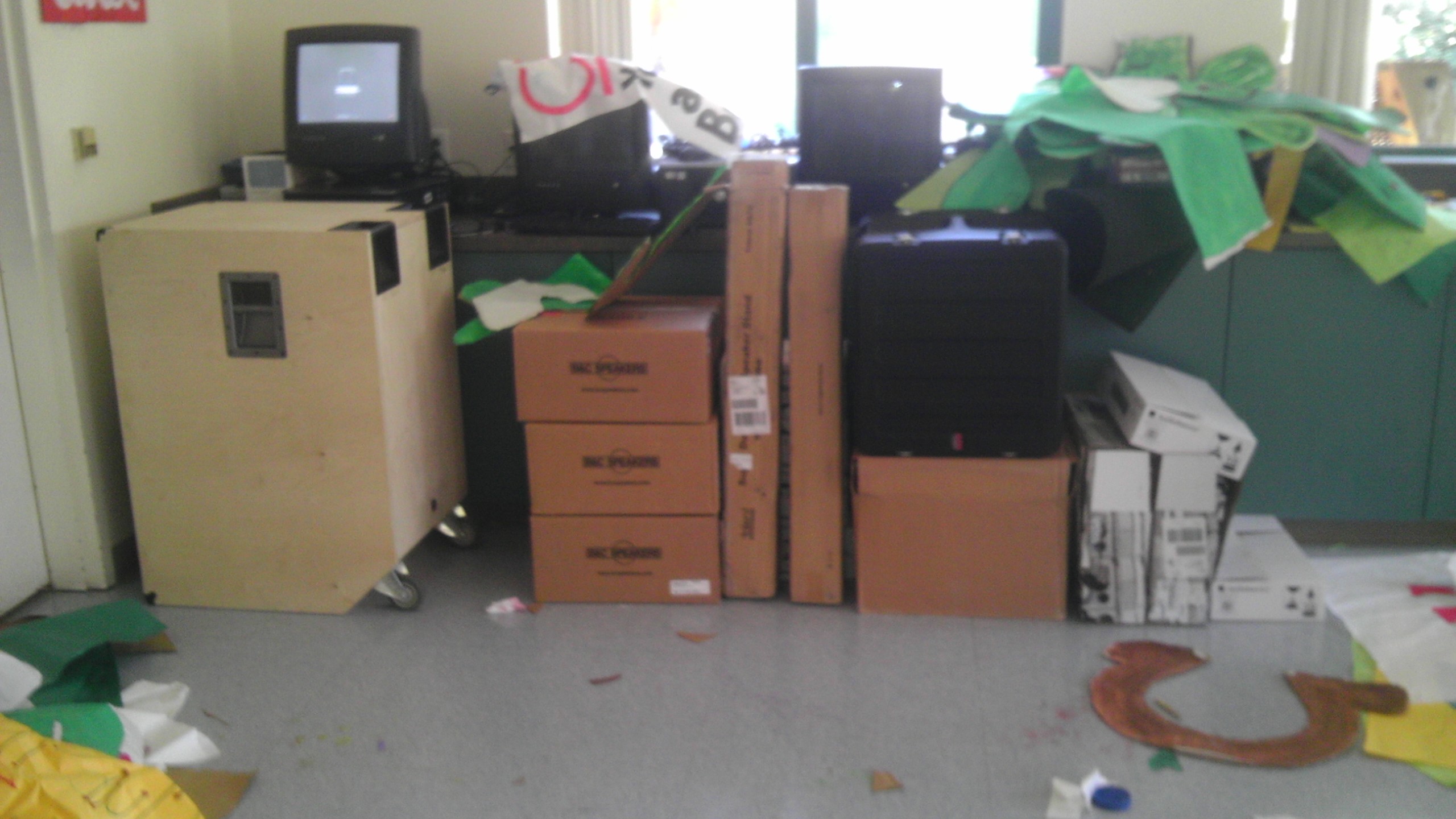

A few more pictures...

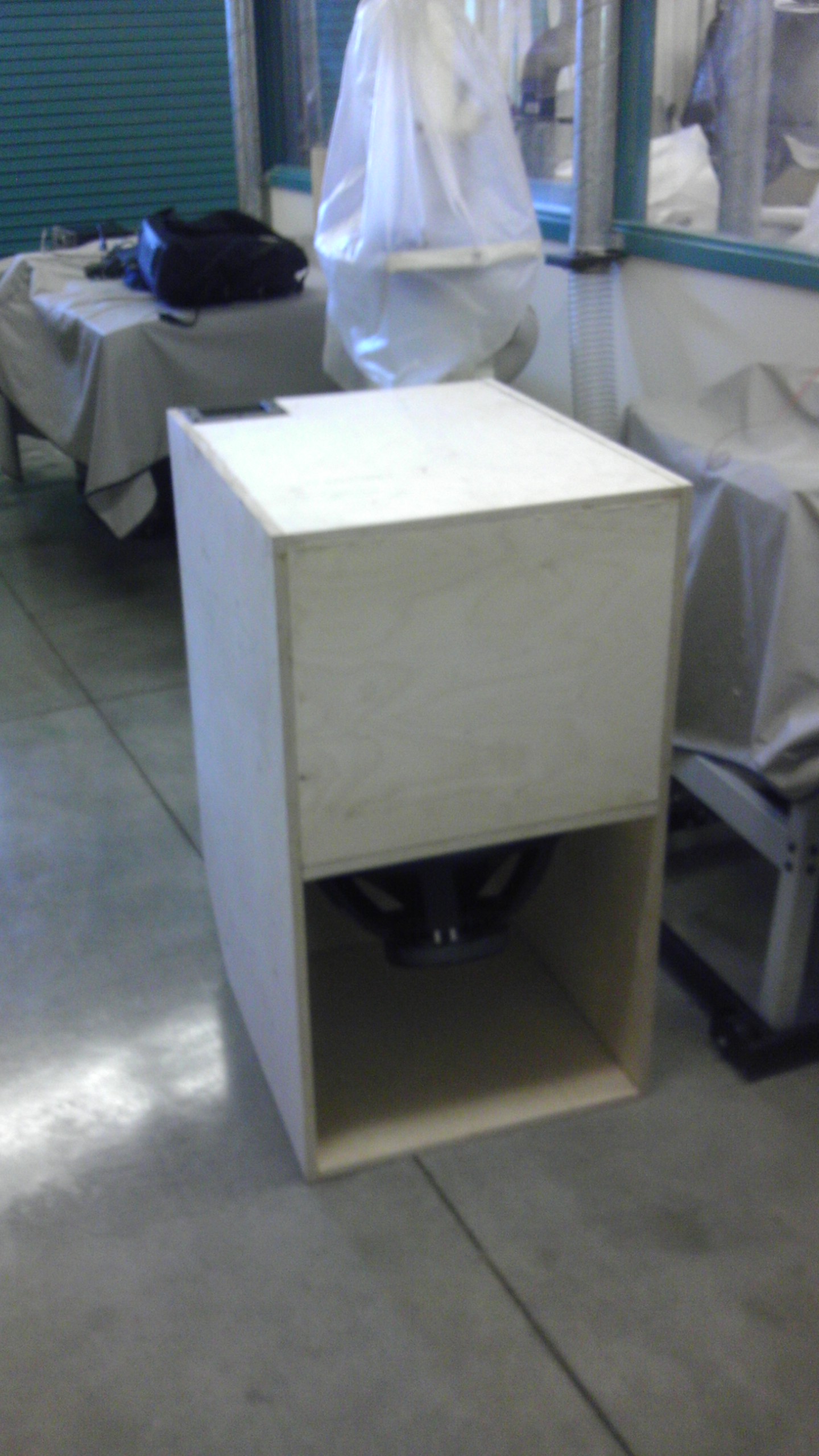

One sub is done (except for paint), and I cut all the wood for the remaining wood. I started with one so that in case there were cut sheet issues I wouldn't ruin a couple hundred dollars worth of wood. Now that the prototype was a total success its move-ahead time.
Hopefully those three will be done within two weeks, and I can get onto the testing :)
All the electronics are here now. So far I haven't had any major issues with the products I ordered, I forgot a couple of wires, but nothing mission critical. I am very happy that I received the Pyle power conditioners that were backordered. They have a TERRIBLE backorder history and I thought it could be up to 4 months before I got them.
I did high level testing inside of the room the sub and all the stuff is pictured in. That was GOOD fun. Everything was shaking, the windows were visibly flexing, with the doors open even. That room is pretty large, but the sub is designed for a space even larger :) If I had to guess (spl meter batteries died) I was hitting 125dB with music, without a high pass filter, and still not pushing the cones to xmax.
The finished sub is going to work next friday at out home coming football game. It is supplementing the rental system we are bring in. Next season when I am all done we won't have to rent

No nasty cabinet rattles / vibrations?
I also tested it outdoors so I could just hear it not the room, nothing really bad. There's a little bit at certain frequencies but if your more than a few feet away you can't hear it. I have yet to brace the mouth of the horn, I do plan to add that though, along with a grate, both of which will reduce the cabinet "walking."
When I was inside the room was making quite few "cabinet rattles" though ;)
p.s. I plan to paint everything at once near the end, which is why the sub is moved to it's more long term home in the ASB room (I built it in the engineering room, pictured in a previous post)
