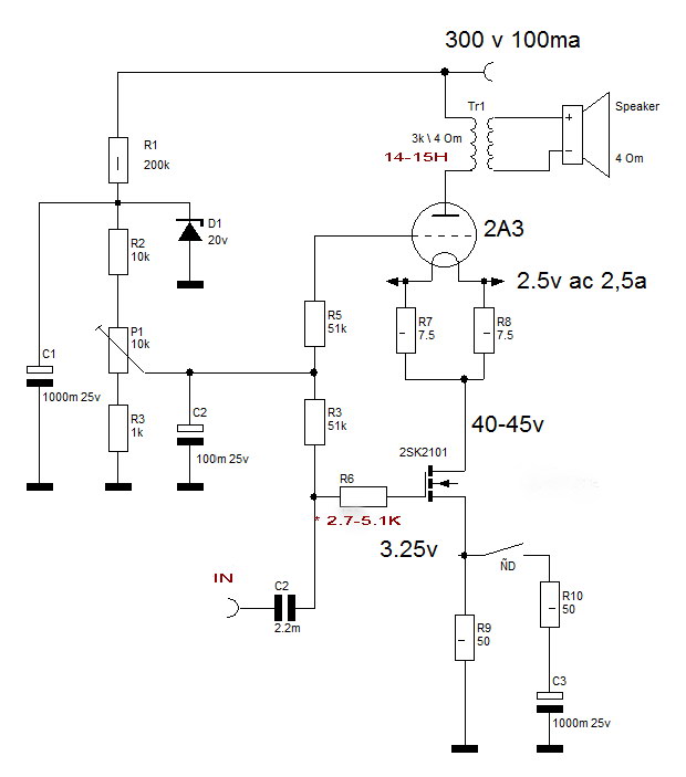

My amplifier today and all last year, the purest sound.

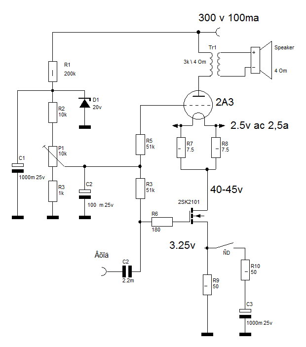

last edition -Eliminate the resonance rise of frequency characteristic if it is above 20 kHz, easier, increasing the value of the resistor (180Om) , in gate transistor, up to 3-5 kOm, which, together with an input capacity of transistor 1 NF, creates a filter that is 30-50 kHz, smoothing over the resonance, and limiting the bandwidth of the input signal.
what is an easy way to bias this top half?
I don't need to go for power right? I should aim for low parts count...
If I run the cascode from the top rail then I could bias the lower tube easily with the plate resistor of the preamp 12ax7. The grid for the el84 colud be biased with batteries rock solid. So no high value cathode resistor and no coupling cap. If the grid stopper resistors were removed and pure silver wire for signal path could I use my tube amp as a linear cb amp? I'm just kidding of course.
