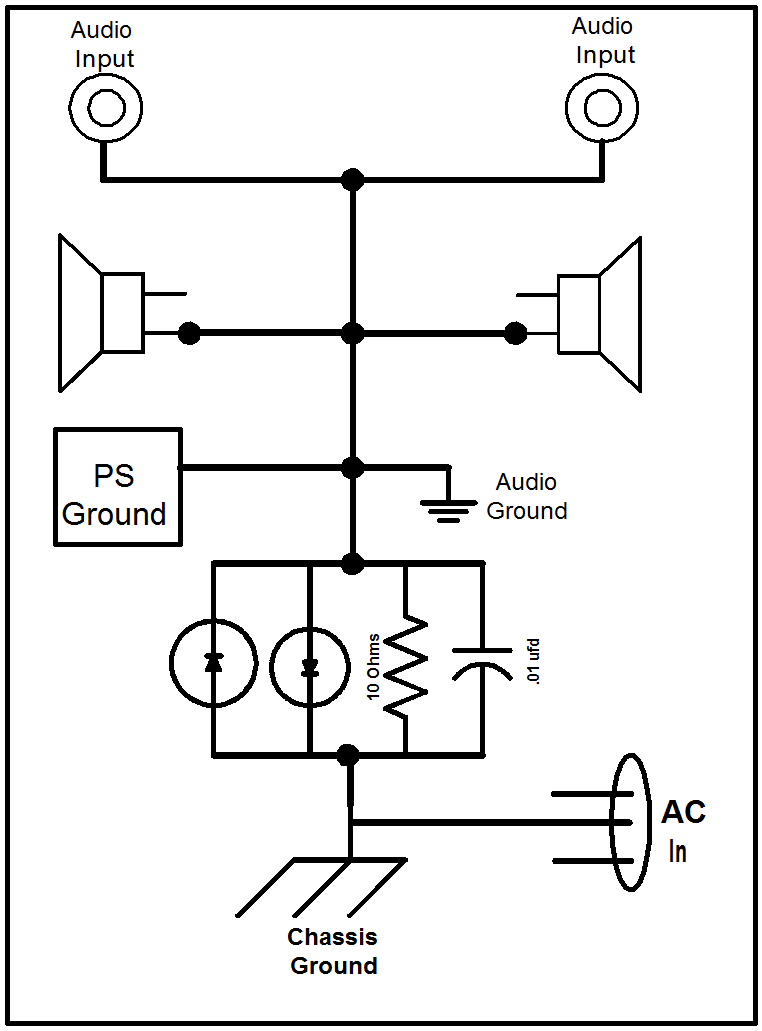

A picture of my grounding scheme:

Thanks for your reply Ian. I tried attaching a picture of the grounding arrangement in my first post but it appears I need more practice.....
I built 2 amp boards and 2 PSU boards, which includes the speaker protect circuit. Both PSU's are supplied from a single 250VA 33-0-33 transformer.
I did not copy the boards - it was a group buy type thing on a local SA forum, put together by one of the local guys. I've asked for advice there as well - which I listed in my first post.
PSU boards are located directly below the amp boards.
RCA connectors are isolated from the chassis.
>There is a single star ground point for everything on the chassis
> PSU grounds to star (in the attached pic black)
> Amp ground goes to PSU ground
> Transformer center tap to star (black)
> Power outlet ground to star (white)
I try again to post pics of the above:

The transformer grounding is not obvious, I think you say you have made chassis earth the star earth and this is
not correct. Star earth is at the PSU common and a strap leads to chassis earth from there, otherwise you introduce
lead resistance into the earth path. Obviously, the resistance between each PSU star ground must be as close to zero
as possible and the benefits of separate supplies vanish without separate windings to permit isolated supplies.
Normally, star ground is above chassis earth but then strapped to it at one point, which may be safety/chassis earth
or another chassis point, according to safety rules which are endlessly changing to satisfy bureaucratic whims.
Safety/chassis earth accepts mains earth, transformer frame earth and a single lead from PSU star ground.
this connection may even be made at another chassis point, depending on power authority rules.
Perhaps this isn't the case but I would hope the transformer secondary common or CT is returned direct to PSU or rather star
ground. If there is a transformer frame or shield strap connection, by all means connect this to chassis/safety earth.
Safety rules may insist on this anyway.
I hope that the problem is just that simple and you get some improvement
if I have understood you correctly. Let's hear what you and others may have to say on it :D
Suggestion ....
Give the safety ground its own chassis connection about an inch away and secure it with a locking nut/washer so you dont keep disturbing it . Then check it has a good electrical connection to the chassis with a meter.
Connect all amp and psu grounds directly to the star ground , including the loudspeaker output returns . Make the psu grounds as short as possible .

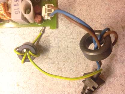

but i think you will have to move the mains socket and wiring!
Shorten that white earth wire. but first try a ferrite on it!
Shorten all mains wiring too, cant see from the pics where its routed, but keep it at least 2cm away from all other wiring.
Rotate the transformer orientation slowly while listening for hum
also try grounding the RCA sockets, disconnecting the signal ground wires from sockets.

+1 to Epicyclic
>The mains is routed from the middle of the back panel along the bottom corner to just behind the front panel where the switch is. From the switch, along the front bottom corner to the transformer. I don't think I've much options in that regard.
> All the AC carrying wires are twisted.
>I've done the transformer rotation - no change. I've also had it on its side, etc.
> The RCA's are currently isolated from the back panel. If you say ground them, please explain?
> Sorry - novice - could you explain the 'ferite' on the mains earth? Resistor?

As previous, there are small gains to be made reducing hum after you get rid of the major problem which is earth or ground wiring.
Follow epicyclic's suggestion, or, for the sake of simplicity and understanding, remove the second PSU and its amplifier from the circuit.
The relay can remain operational if you wish.
Now, connect the transformer CT to the remaining PSU star ground and ensure a chassis ground connection from there.
Assuming you have the other returns to PSU star ground in place, such as the speaker return, input ground and amplifier
power 0V, you should have sweet sound in one channel without hum. You can then parallel the second amplifier onto this
I've finally gotten round to making up the diagram requested muuuch earlier.
Shown is what I tried tonight - with no success:
-Moved the mains earth to another location on the chassis - no change
- I then removed one channel from power and star ground - no change
- I then added a 10 Ohm resistor on the mains earth - no change
- Take output earth to star and then with 10 Ohm resistor in line - no change.
- Packed the freakin thing up and started writing this post. ::)
Irritatingly, there's only noise when the RCA is connected - even without it being connected to the preamp. If its lying on top of the power cable the hum is pretty awful. If I lift it straight in the air - much less hum.
For the record - all of this was done in my study - which is on a different breaker switch to the lounge where the amp is normally used.
Here's how its connected no, sans resistors.
1) Should the star ground be isolated from the chassis?
2) Should each channel have its own star ground?
3) If so, how to do with the single CT I have?
Thanks again for your patience!

Hi Atjan
Thanks for the diagram. It makes something clear which, as I see it, is still a problem. The point you mark star earth
is still the point of connection for the transformer CT. This is not correct.
Star earth is actually on the PSU power board. - lower right side where multiple connectors shown, are provided for the purpose.
The speaker ground return connector should also be taken directly to that point. Perhaps the PSU traces ensure this.
The only connection from the whole amplifier(s) to the chassis earth should be a single short lead from the PSU star point
to that chassis earth/safety earth.
Remove that speaker ground connection from the amplifier board (top right side) and see if there is any change.
The correct return point is also to star earth (as above and previous posts). It should not be duplicated as shown.
I imagine you have already tried this, but plug the power amp and source into the same outlet/adaptor. If the hum is reduced,
you may well have to break the earth shields to the source but this is extreme and suggests something silly in the supply wiring
- perhaps even a bad earth strap for the house ground connection?
The reply to your question (1) is above but the star ground is not isolated other than by the small resistance of the chassis
lead/connection. Surprisingly, that tiny resistance is critical in hum reduction, being the very reason we keep the earth points
separate or as close as possible as required.
(2 & 3). Ideally, the star earth points should be identical for a stereo pair using a single transformer winding. That is the reason
for suggesting the single supply so there would be no added earth resistance. In order to use separate PSUs, you ideally need
separate windings on the same transformer or separate transformers. In that case you simply duplicate the amplifier, PSU
and connections. The only common connection is again the chassis earth. Both schemes are used in many commercial designs.
I strongly suggest you read the articles pages on Power Supply Wiring Guidelines design at Rod Elliott's ESP siteto confirm.
The reference amplifier design books by Douglas Self, Randy Slone and Bob Cordell also contain important chapters on this subject.
EDIT. I believe we don't advocate that DIYs attempt double insulated wiring practice. It is certainly prohibited in this country.
