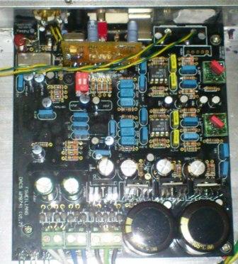

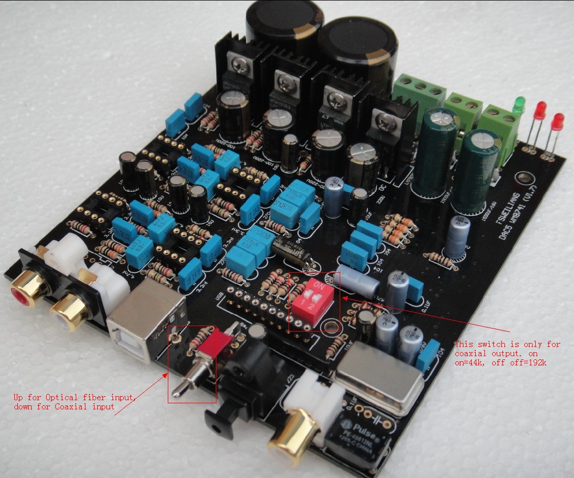

I recently bought a WEILIANG DAC5 from China.
I also bought the same DAC (only diff. is mine output IC is a AD827).As seller asks ,i connect it with a transformer 15VAC (50VAC output),and a 12 Volt DC (i don't have a 9 Volt AC) by pass the LM317*.Once power it up ,
the red pilot light is on .Hooking it to a computer USB output ,the other led
now is on too (i guess the power from the USB computer )
BUT NO SOUND COMES OUT
I can't leave it ON any longer ,it may harm the unit and seller is NO help :all he offers is how to adjust the output ,and that is it .It is brand new unit ,and this is my 1st DAC from China .
SOMEONE HELP , PLEASE .

HOPHANTHIET/SANTA, I think you must have the DAC6 board if there's only the AD827 at the output. That is not the same board I have. I have the DAC5.
Comparing the photos of the DAC6 with my knowledge of the DAC5, I think you need two 15VAC transformer secondary windings, plus one 9VAC secondary winding. One 15VAC winding most likely feeds an LM317 circuit to produce +12VDC, and the other 15VAC winding most likely feeds an LM337 circuit to produce -12VDC.
If you're bypassing the LM317 with your own +12VDC, are you feeding your 15VAC to the LM337 circuit?
I believe you MUST also have 9VAC to feed a 7805 circuit. Without this supply, I don't think there is any way to make the DAC6 work.
This is all conjecture on my part, of course. I suggest you try to obtain a schematic for the DAC6 and go from there.
