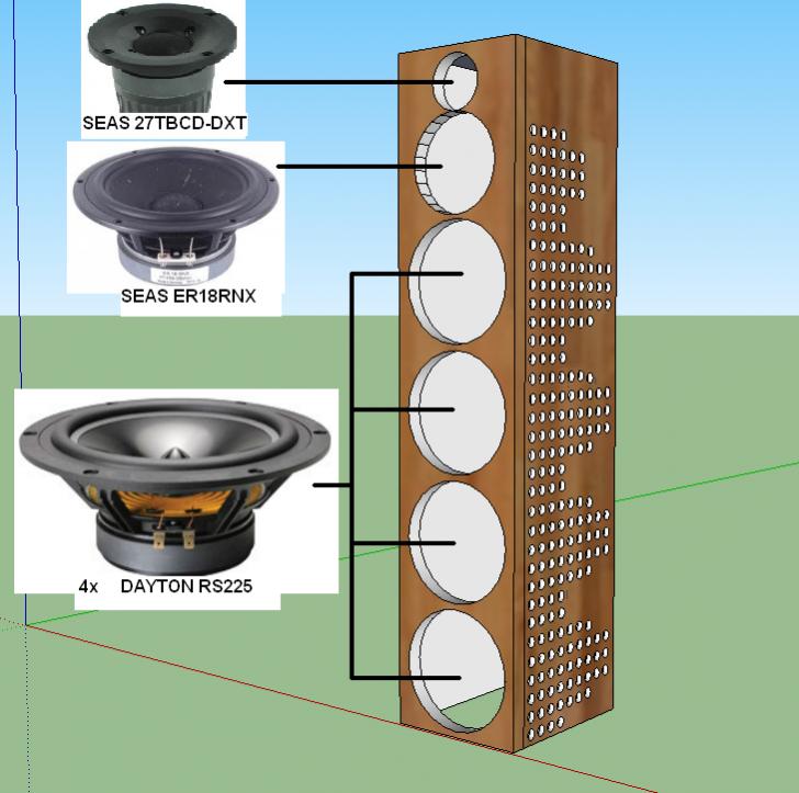

- Prototype:
There are still many unknowns surrounding this design so building a prototype and taking measurements is of high priority. I hope to get insight in the following areas of concern:
- Will damping the rear wave result in the desired cardioid response? How does the composition, thickness and placement of the absorbing material affect the response?
- What will the vertical polar response look like? Will the mid-tweeter crossover allow a good listening window? Will the bass array integrate well with the midwoofer?
- What are the best crossover points and slopes?
- Will the off-axis response remain linear throughout the entire system bandwidth?
- How can I improve the construction of the box to address vibration issues? I want to experiment with magnet-mounting the woofers. Some dipole designs run woofer arrays in alternate polarities (push-pull) to reduce vibrations and I wonder if that approach will work here?
- What is the low end limit of this speaker in terms of safe driver excursion? Will I be happy without an extra subwoofer?
- Most importantly, does cardioid midbass reduce room interactions enough to be worth the extra work?
That's a really beautiful project, lot of good points that are barely seen on the same speaker, the cardioid bass section gives a nice touch of originality. You can expect either nice results and a lot of fun before finishing it.
But I am not so enthusiastic about the Le Cleac'h filter and it's implementation.
First, it's not a linear phase or whatever but only a "quasi optimal", more conceived by his author with in mind something easy to do and accessible to a majority of DIYers, than challenging the ultimate transient perfect.
Second point, finally it's not at all easy to do. There is a gap between the theory and it's application, the drivers have to be textbook linear, the Fc far from their natural roll offs.
In other words, the magic recipe of the spreadsheet needs a lot of measurements and a parametric EQ to comply the target...all this for at best a quasi optimal. This said for the sake of discussion, the important goal is only listening.
I have also the KX drivers on my PC, pretty amazing for a freeware. They are perfectly able to do the job.
You are right of thinking bracing and magnet mounted drivers, the side panels can be vibration friendly. Will you separate the mid cavity from the boomers ?

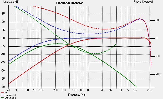

Here is a quick simulation I did with DSP that you might find interesting. It looks at how 1st order filters may crossover in an open baffle. Let me state however, that although the simulation looks good electrically, I did not verify it acoustically and I give no guarantees that it works as shown.
My baffle size causes a natural response roll-off to occur at 500Hz. I'm using a 1st order high-pass filter on all simulated drivers to account for that. The red trace represents the midwoofer. The green trace represents 4 woofers on the same baffle. I discovered that in order to sum all of them flat the 4 woofers require a 1st order filter low pass filter at 125Hz. So in essence, when dealing with 1st order slopes, quadrupling the number of woofers on the low end allows the crossover point for the LP to be moved back 2 octaves.

Thank you for your input!
I'm afraid you are right that the amount of damping will have to be determined by experimentation. My idea is to start with a nice looking polar and continue from there. I have doubts about this method being able to hold a cardioid response for a wide bandwidth.
As for your design it sounds like you are working with a U-frame box. Note in JohnK's articles that a U-frame design develops a resonance above the dipole peak. He uses the U-frame only below the resonance point <100Hz. I doubt that U-frame will work well in the mids even when damped well. A damped lossy box with holes on the side behaves differently than a U-frame.
