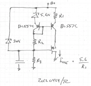

The CCS'es could be improved, but I don't think that's the source of the problems. Especially, if they provide a reasonably constant current they way they're currently configured. This can be confirmed by measuring the voltages across the emitter resistors.
However, if the CCS'es are causing trouble, I suggest replacing them with attached. It's a CCS that I've been playing with lately. It provides a nice, temperature compensated current source. It's fairly low gain compared to the one Zen Mod is referring to (I believe that one what Morgan Jones calls the "Ring of Two"). This is completely intentional. I've had issues with the Ring of Two oscillating on transients. The Ring of Two is also not temperature compensated (as the transistors heat up, the bias current will vary significantly).
If you choose to use my CCS, set up the current in R2, R3 around a few hundred uA (limit the dissipation in R3). Calculate R2 such that you get roughly 10 V across it. Also, keep the two PNP's close together - preferably thermally connected to each other. The output impedance of this current source is extremely high - exactly what you want for a CCS - due to the cascode (the PMOS). You can turn the circuit upside down and use NPN/NMOS devices for a current sink if you like.
