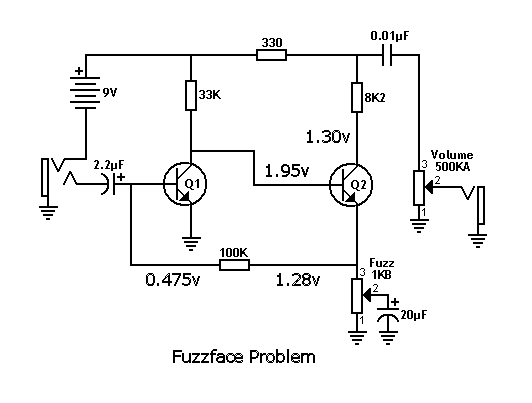

Hi. First post on this site, so bear over with me.
I recently buildt a bc108 fuzz face based on the schematic on this site:
Fuzz Central -- Arbiter Fuzz Face
Everything seems to work, it it cuts out if I play a little soft, between notes or if I turn the volume down just a little. Does anyone know what's wrong or what errors to search for?

Assuming that's all ok though, and that you haven't got a defective component, all I can think of at the moment is that you've perhaps got a wiring error - how is it constructed? Pcb? Vero/Strip board? Dead bug?
Maybe a close up photo would help, if you can take one and post it? Better still two photos, one of each side of your board, assuming your using one.
Check and re-check that you've got the right connections between the right value components in the right places and that you've got E, B & C correctly oriented on your transistors.

Check the bias - sounds like it's gating from a mis-bias.

As suggested, it is likely the transistors bias should be checked. According to the site you should measure a collector voltage at Q2 of about 4.5 to 5 VDC.
They suggest installing a 10K trimpot in place of the fixed resistors for adjustment. I would not do that without keeping some fixed resistance to avoid possible direct short when trimpot is at minimum. I would use a 5K fixed and add a 5 or 10 K trimpot in series to adjust it.

Hi everybody, thanks again for all the feedback.
Sorry for the delayed reply, got a bit hectic going into the holidays, but now I've measured the voltages at each transistor and they are as follows:
Q1: b- 0,475 e- 0,003 c- 1,95
Q2: b- 1,95 e- 1,28 c- 1,3
Now I'm sure the values of Q2 are off (not even close to the 4,5 shanx suggested), but no idea what's wrong, or how to remedy it.

Ok, getting there. What's the voltage at the other end of the 8k2 resistor connected to the collector of Q2? Where it meets the 330R resistor and the 0u01 capacitor? How much voltage is being dropped across the 330R resistor? Suggest you check the value and connection of that 330R resistor - is it 330R? Not 330k for instance?!
The collector voltage on Q2 is too low - the base-collector junction is forward biased - fits totally with what you've described sound wise.

Are you sure you are using a 1K pot for the Fuzz control and the Q2 collector voltage stays stable as you rotate the pot? Reducing the 8.2K resistor (experiment with a trim pot) should get the collector voltage in range.
If the Fuzz pot is correctly wired and the capacitor on it is good, rotating it will not affect the bias of either transistor.
The voltage at the emitter of Q2 looks about right to me, feeding through the 100k resistor it gives about 8uA bias current into the base of Q1, which should be bumping along the bottom rather. Negative input half cycles get clipped first.
Q2 has reasonable forward bias across the base-emitter junction, 0v68, given the apparent lack of current flowing through it. I'd be looking at the 330R and 8k2 first of all.
The base of Q1 should be approx 0.63V
Why should it be 0.63v? It gets fed a tiny bias current. 0.63v might be what you'd expect in a "normal" circuit. This just isn't one of those circuits. Anyway, it isn't "off", it's got 8uA flowing into its base.
Sorry guys, when i went back to check the value of the resistor i discovered i had actually connected one leads on the voltmeter to the wrong terminal (I didn't even know that would show results) rechecked the values and they are as follows:
Q1: b- 0,64 e- 0 c- 2,12
Q2 b, 2,12 e- 1,45 c- 1,45
sorry for the mistake
resistor is correct 330 (no K) and voltage between resistors is 8,68
