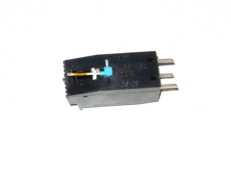

CS-29 is a ceramic cartridge, it was designed for 1MOhm input impedance and no equalisation or amplification. IIRC the output will be around 150mV or so..
This is an extremely low fidelity cartridge. The output will follow the LP Equalisation only very approximatly and have very large deviations from flat.

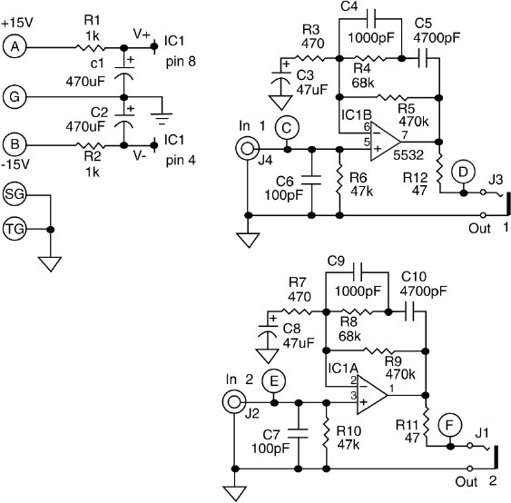

Riaa pream for CS-29?
Hi ThorstenL !
What RIAA preamplifie for CS-29 to recommend?
I made ​​the RIAA preamp by this schematic, but in the secondary area (from 1 ... 3kHz) is the large distortion?
And this gives the preamplifier gain of about Au=60dB is too high.
thank you and cheers!

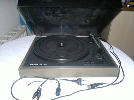

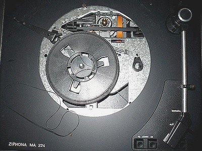

Here are the photos the piezo-pickups CS-29, and photos turntables Ziphona MA=224.
Which schematic is required to exit?
Why Mr.ThorstenL turntables Ziphona MA-224 with this we need the RIAA preamplifier than usual amplifier with gain of Av= (8 .. 10)dB and the input impedance of 1Mohm?
Thank you and cheers!
I know 1MOhm input buffer will work, because that is how they where used with the other east German Equipment.
Radio's, Amplifiers etc. all had inputs labelled "TA" for ceramic inputs that where 1MOhm, minimum capacitance.
The three resistor attenuators I do not know if they work well or not. But as you already have build a MM Riaa Pre, trying them would be easy. If it is still is not good, use the 1M input impedance buffer...
Ciao T

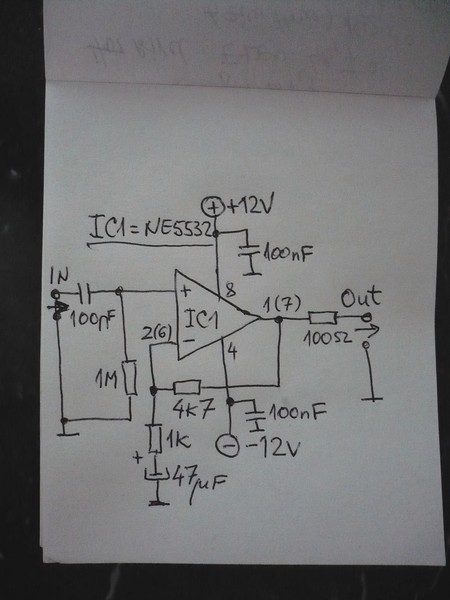

Preamplifier for Ziphona MA 224 (CS-29)
Hi all!:wave2:
I made this schematic saves preamp for piezo pickup CS-29 (Ziphona MA 224) and now everything is OK!:up:
Excellent turntable to an amplifier can be heard now and enjoy music Dire Streits!:eguitar::note:
Cheers!:cheers:
