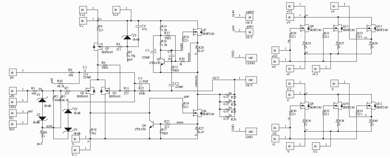

Hello, I'm new to this thread and am building a aleph30 of Mr. Nelson, thank you for all of us Mr.(Papa):) I would need to know this:
1) Why use a 220uF capacitor for C1, polarized electrolytic type?
2) Why only on the rail (-IN) input and not also on the rail (+IN)?
3) Is possible a little meditation on these capacitors, their job so ..what to use for their for best performance (perhaps using different types for each specific case)?
Please...sorry for my English!
Thanks in advance:D

I too had the same doubt, it seemed very strange circuit, quite rightly, very noble, presents the signal path of an electrolytic capacitor, unless, in the balanced circuitry (I do not know the best) , the question changes.
I am very curious what will be the answers on many of the gurus in this exceptional forum.
thanks and greetings to all.

I read with interest your speeches, but none of them has basically gutted the problems presented by Toni, in fact, if I understand the its question, its necessity is to understand how to develop the branch electronically negative input audio signal, on which this is a 220uF electrolytic capacitor, which at first glance, for those not expert in the balanced circuitry Mr. Pass, creates great uncertainty,,,, if I remember correctly, somewhere I read that Mr. Pass is not convinced of the use, the signal path, the electrolytic capacitors;
please, can anyone explain to me and consequently at friend Toni, the task he must accomplish the capacitor and its resistance to it in parallel (which should form a band pass filter) in series with the negative branch of the signal ,,, many thanks and greetings:confused:
