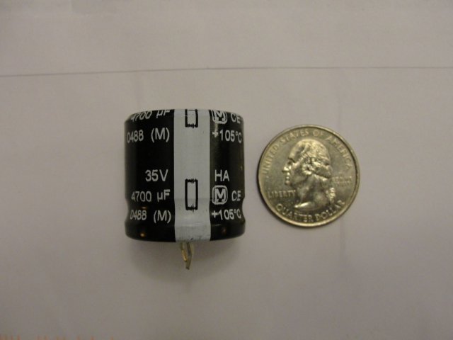

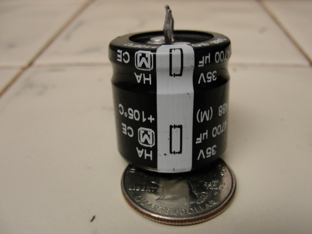

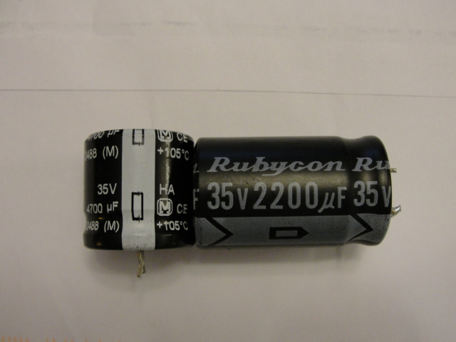

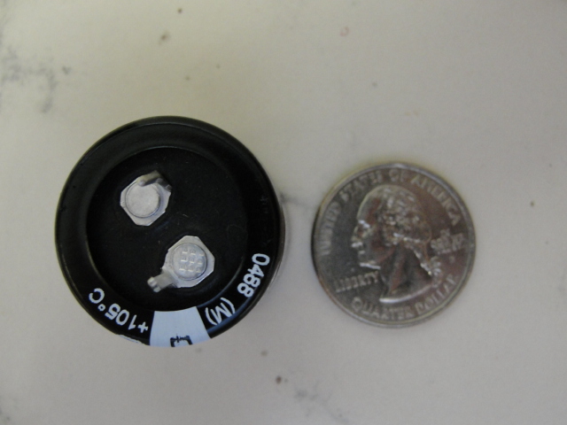

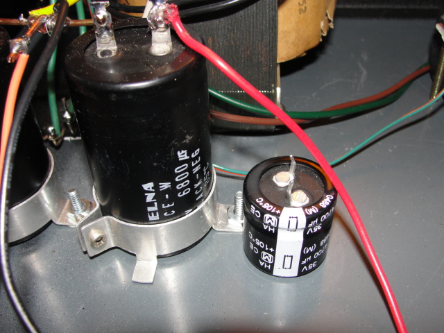

Hi eveybody.....I managed to take some pics today (after 3x12 hrs night shifts). As you can see the 4700uF is non-brand, and very small size (pics taken with a US quater by its size). You can also see its size in compare to my great sounding antique ELNA 6800uF cap. There is another pic that compare it to an old 2200uF Rubycon.
I haven't been able to find simple way to measuring ESR. The information I found involves equipments I don't have - sig gen and an OSC scope.
But then again, I went to digikey and mouser and can't find newer ELNAs that are comparable to the size I'm using. Biggest one is about 3300uF. ARe these all they are making now ? Nothing bigger than 3300uF ?
I also search for Panasonic FM in digikey and mouser and they don't have it. They are listing different Panasonic series that are not FM. I'm kind of lost but I want to avoid buying caps from Ebay if by all means possible. Where do you guys buy your filtering caps from ?

The printing on those Panasonic caps looks a bit suspect to me....
I don't have any panasonic caps in my pictures. Are you sure you are seeing panasonic ?
The (M) logo is that of Matsushita, also known as Panasonic.
Your pictures presumably show a TS-HA series cap. According to the datasheet, the 35V/4700uF type should be of around 25mm diameter and height.
Additionally, the 0488 marking looks like a production code of week 4 in 1988.
