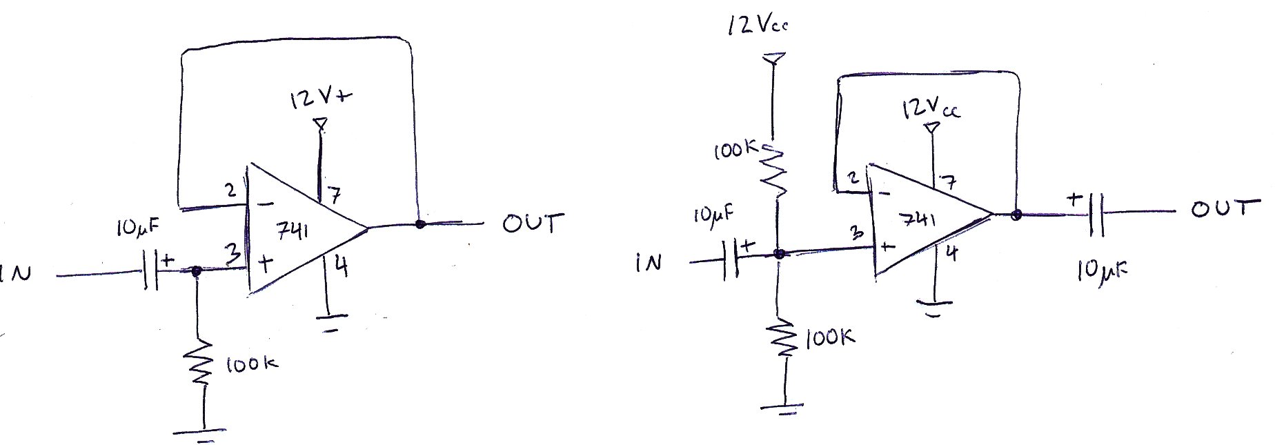

Hmm, I had time today to give this a try, but I still seem to be doing something wrong, the signal is not showing up at the amplifier. Here are the configurations I tried. I tried both setups with and without the coupling cap on the output. For the record, the power supply is a 12V 3.2Ah SLA, which will end up being the power supply in the finalized project.
-Chad?
Administrator
Joined 2007
The second one is 100% correct and will work. If it doesn't maybe the opamp is faulty. An SLA is pretty scary to work with.
DC voltages with no signal applied... check all the pins on the opamp.
Pin 3 should be at approx 6 volts and pin 6 should be the same.

Yep, you are right. I went back and double checked everything, which seemed to be in order.
However, what was happening was that for some reason, the TPA3110D2 amp chip had gone into shutdown mode when (and each time) I hooked up that battery (woops). After giving the amp a "gentle" reset, the 741 buffer amps (unity gain followers?) worked like a charm. Separate l/r channels for the VU meters, one mono channel for the amp. Beautiful. Thanks again for all your help!
