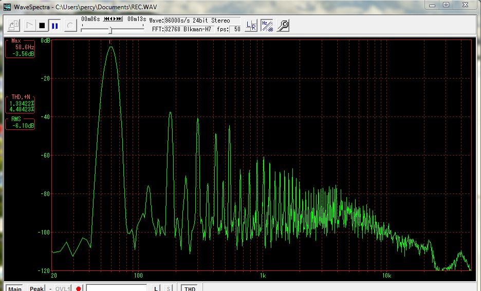

This the spectrum I get for my household 120V 60hz AC line. I measured this by just dropping the voltage down to line level (~2V) using a simple resistor voltage divider and recording it with my soundcard at 96Khz/24bit.
Pretty strong and extended odd order harmonics and a fair amount of even order as well.
Is this normal ? Is this what typical household ac looks like ? Frankly I wasn't expecting this, I was pretty taken aback but has anyone measured the spectrum on their ac line ? I am very curious how does it look for others.

No, it is quite a bit noisier than what I would expect. Try running it through an audio transformer for isolation. I think you are seeing RF past the Nyquist limit fold back down.
The first 5 or 6 spikes look about right, it is the 1 K and sidebands that don't look right.
Correct, an AC filter is designed to block/suppress RF frequencies, but will do nothing to the harmonics between 60 and 20k. As far as whether or not those harmonics matter depends on the application.
When I AC heat DHT's, I prefer to run my heater source through a ferroresonant transformer, which produces harmonics only out to about the 11th. Higher order trash is eliminated. So you get slightly cleaner and regulated power. But for converting AC to DC for amplifier power supplies, this source at your house panel is just fine. Having a cleaner sine wave won't really improve the situation. In fact, it is the use of rectifying power supplies in your home and on the grid that causes the voltage to look like this in the first place.
Any attempt to clean up the source harmonics will normally result in higher source impedance as seen by your amps, which is usually not the goal.
simon, actually those are indeed 60hz harmonics. What you see 1Khz is actually the 17th harmonic (1020hz). I will try to just attach the wav file so that anyone can look at it directly.

I note that the 3rd, 5th and 9th are each ~1% of the 60Hz fundamental.
I suspect the total distortion must be around that 5% upper limit.

Why is the 17th harmonic so large? Not what is expected.

Depending on wgere you live and what industry or offices are near you, that looks about right for the mains. Worked on some gen set controllers that synced with the mains and we got false zero crossings up to the 13th harmonic in some places, so the EE's went away and palyed with some analoge circuitry and DSPs to solve the issue. Being near large HVAC installations is the worse scenarion.

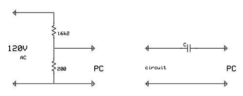

I find it very interesting, and above all very ingenious, way of measuring the noise in the mains. Please, can you give a full explanation, a little tutorial on how to do?
How does the resistive divider and as we connect? Between earth and live, between earth and neutral, between live and neutral, or use all three? How do you connect to the computer and programs can be used?

Hi Raul,
this is between Live and Neutral. Ground was not in the picture. I wired up a high and low value resistor in series (16.2k + 200ohm) and that 16.4k served as a load to the 120V outlet Live and Nuetral. Then I just tapped the ~1.5V drop across the 200ohm resistor and fed it into the Line-In input of my soundcard and used WaveSpectra to observe the spectrum real time. WaveSpectra also produced a wav file of the recording. That’s it. Essentially I have done nothing new than using the soundcard as a scope or analyzer. Other than perhaps a very dangerous way of hooking up the soundcard to the ac outlet! :eek:
Keep in mind this is limited by the soundcard’s bandwidth which typically is about 48khz, maybe 96khz with some pro-audio interfaces, so this is not quite useful for high(rf) frequencies which I suppose is what you would find on the ground wire and post-power-supply or other areas that you were referring to.
The resistive divider method can cause false readings if the neutral is dirty since the PC is typically connected to ground, and the divider connects the PC to the neutral causing a possible ground loop.
