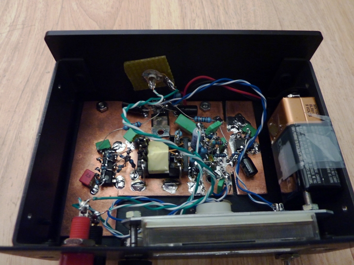

Hi all,
Here is the simple capacitor ESR meter which works very well.
My version of the ESR meter is based mainly on the project published by Lawrence P. Glaister at
Capacitor ESR Tester
There are several modifications though which I think are important:
1. I used the impulse step-down transformer to couple the oscillator+driver with the load and to reduce the output impedance. The transformation ratio is about 15:1 but it is not critical (you can use 10:1 for example). What is critical is to adjust gain and bias for Q1 to stay in linear region. I extracted the transformer from old Nokia cell phone SMPS charger.
2. I paid particular attention to Q1 amplifier biasing and gain. The key here is that Q1 should stay in the linear region all the time (no clipping). All the voltages are indicated on the circuit diagram.
3. I used higher oscillation frequency. Fo is around 233Khz.
The layout of the circuit is nothing special: ground plane and "ugly construction" (see photos).

Great! beautifully done . I believe I saw your design on the net and considered it as one of the prototypes.
Your circuit seems more accurate too, but high accuracy was not my goal here. I was also concerned with the usage of the op-amps for amplification at high frequencies (that's why you need three in series to achieve required gain).

Actually, it is not an ESR meter, it is a simple (scalar) impedance meter.Hi all,
The only case it could display the esr is when the capacitor's self resonance frequency happens to coincide with the measurement frequency.
That said, it is certainly a useful piece of gear anyway.
