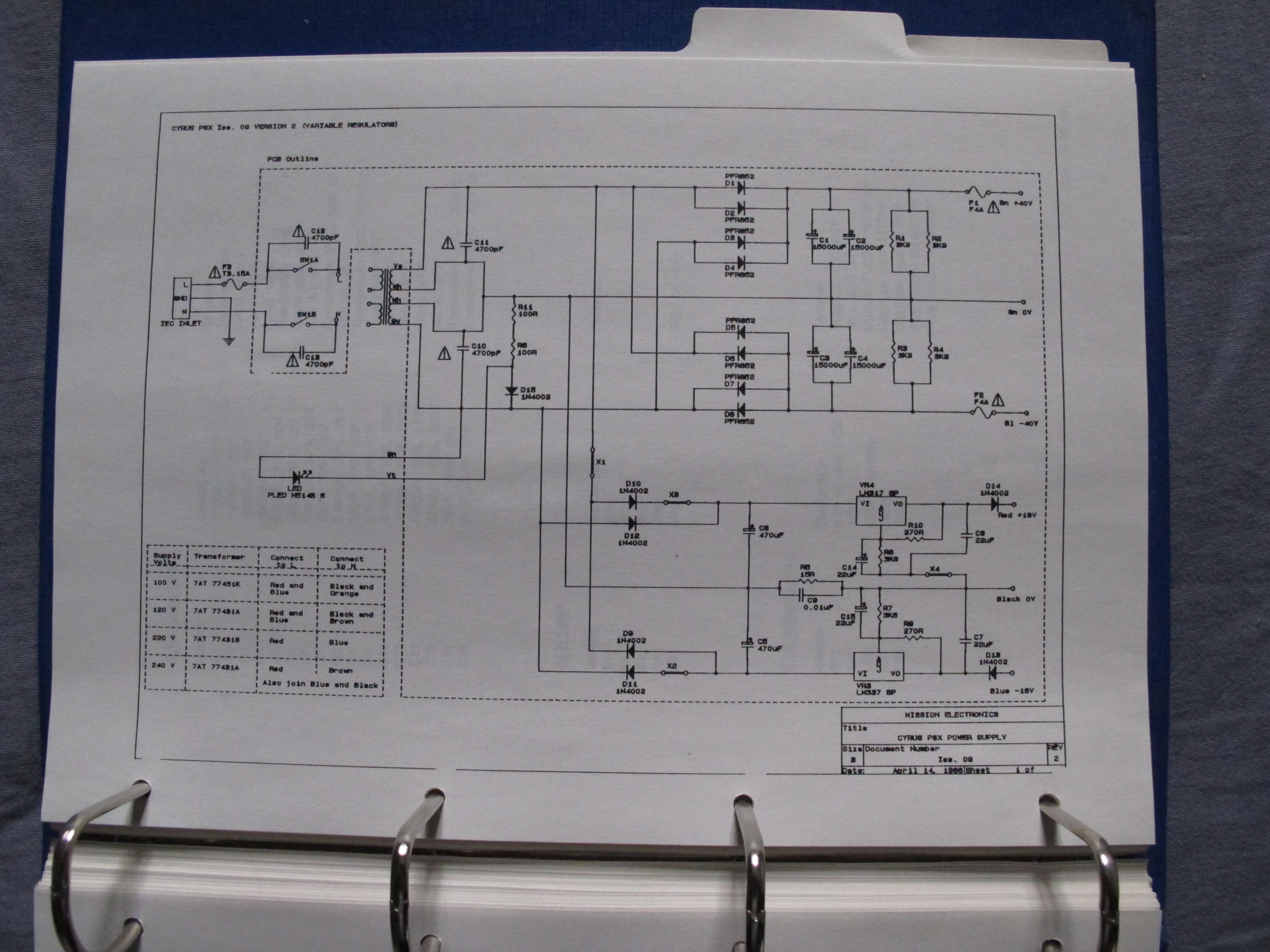

I do not know how old is this PSX, but I think that it is not older than 10 years, so I guess the caps are still ok...here is a pix of the Cyrus Two power supply. Couldn't find a Psx schematics, but I read on the net that it is pretty similar to the Two power supply section...

images of the PSX service manual
I have the complete factory service manual, obtained from Mission in 1989.
I shot large JPEG for best detail, did not crop or edit for time...
