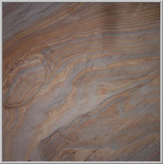

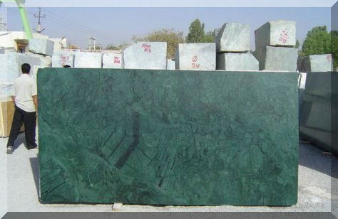

Here are some of the stones that I have.
So if I were to make speaker cabinets, what should considerations should there be?
Anything else?????
