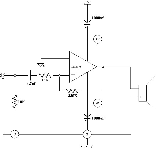

Nuuk said:It should do.
it couldn't have worked, as the inputs are swapped.
it seems that you wanted an inverting topology but with different resistor values. the resistor values will work, but the topology will not.
Besides swapping inverting and noninverting inputs, and setting it up for large DC offset by not compensating for bias current, you've also got a situation where disconnecting the speaker could remove the input ground reference.
Bad circuit all around. Use the app notes as P-A suggests. Those National guys are pretty smart and actually know how to use their chip.

Oh my... inversed input is just a typo, thanks for pointing it out, I may have followed it during construction. With that reversed, do all the values look good?

I didn't check the inputs but I think that was more of a typo than anything. Still, as you guys point out - it would not work that way round.

Illusus said:Oh my... inversed input is just a typo, thanks for pointing it out, I may have followed it during construction. With that reversed, do all the values look good?
it will work if you correct the input error.
The chip is surprisingly fault-tolerant. I ran it with just two resistors and it worked flawlessly. I used much lower resistors (20k/1k combo) because that's what I had. No problem whatsoever. The key here is the ratio between the two, not their absolute value.
There is no reason that yours wouldn't.
Illusus...you are off to a start with a design and asked questions......dont feel bad about that as we all make mistakes in venturing into new things .....your other design criteria should be your input to this amplifier as you have used a low impedance so now you should look at what source will be providing the signal and whether it is suitable or else you will need to adjust the input impedance of your design
