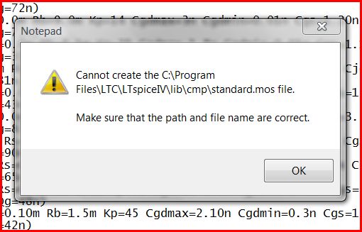

Hopeing some of you Spice experts can help a total newbie to LTSpice :)
I'm stuck on how to import models into the library despite reading the help files, and searching these forums and googling.
Here's what I am trying to do if this is possible. I want to import the Spice models that Bob Cordell has on his audio site such that those parts are available to use on any simulation.
So I have tried to add them to the library by adding just one device to the appropriate file but find I can not then save the file, I get in loop.
I am following this method (section H),
LTspice Tutorial
by going to the library and adding a new .model line.
Nothing I try lets me save the file. Whether that is an operating system specific issue I don't know. I'm running Vista.
(Even I just alter a single character in a library file as a test it (Vista ?) stops me closing the altered document)
How do I do this ?
Is there a different or better way.
And please don't assume any knowledge whatsoever on my part on this.

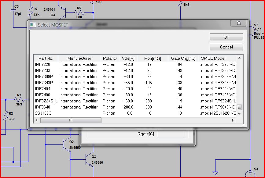

Administrator
Joined 2007
Might be getting somewhere... been 2 days on this !
I've changed permisions for the library folders and can now save to them. Yay :)
The transistors I added to the "mosfet" file now show correctly but all the data on the initial selection is showing zero... which seems to be because that data isn't included in the original file I pasted in.
The libraries and importing models is thus far the most difficult aspect up to now for me...
