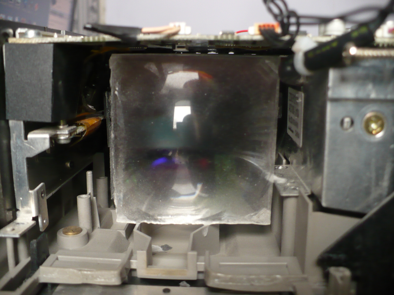

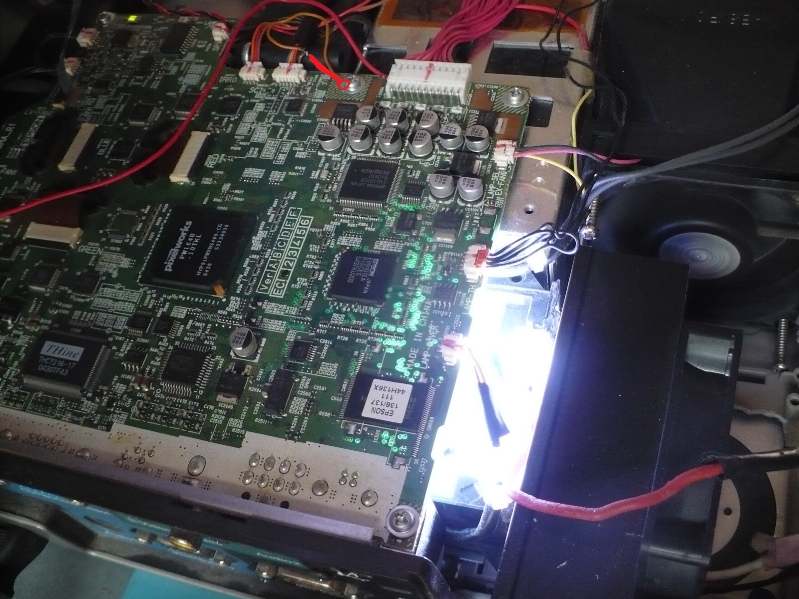

first lamp hack 1st pin on ground
remove all lensses
break all the material till last lens
put fresnel lens for the led
ENJOY
remove all lensses
ENJOY

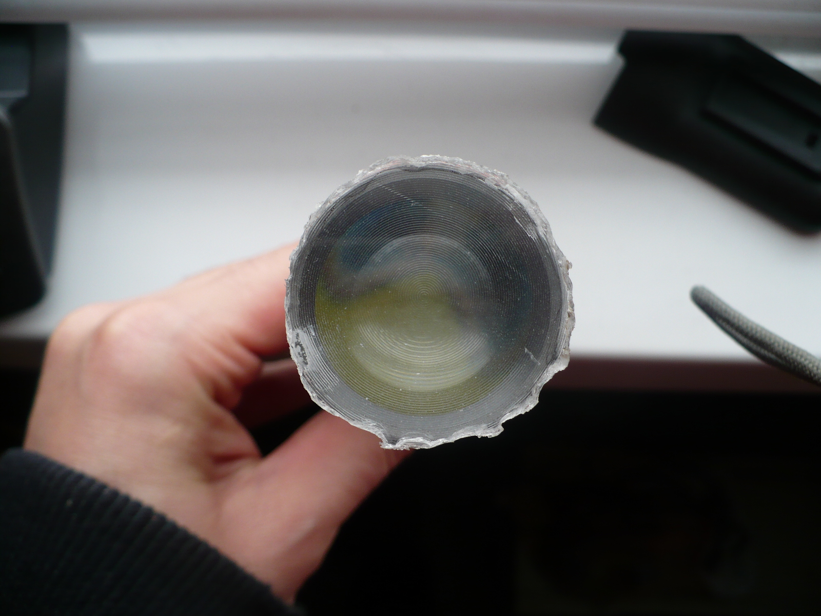

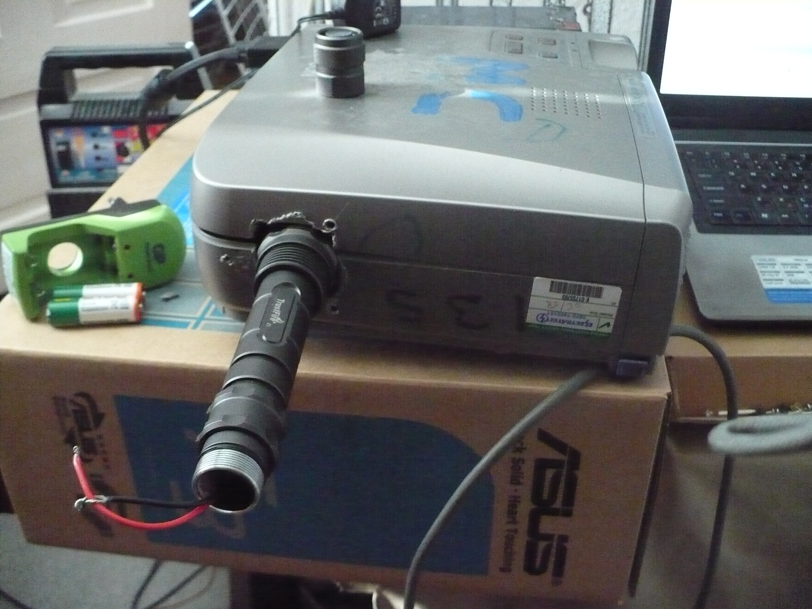

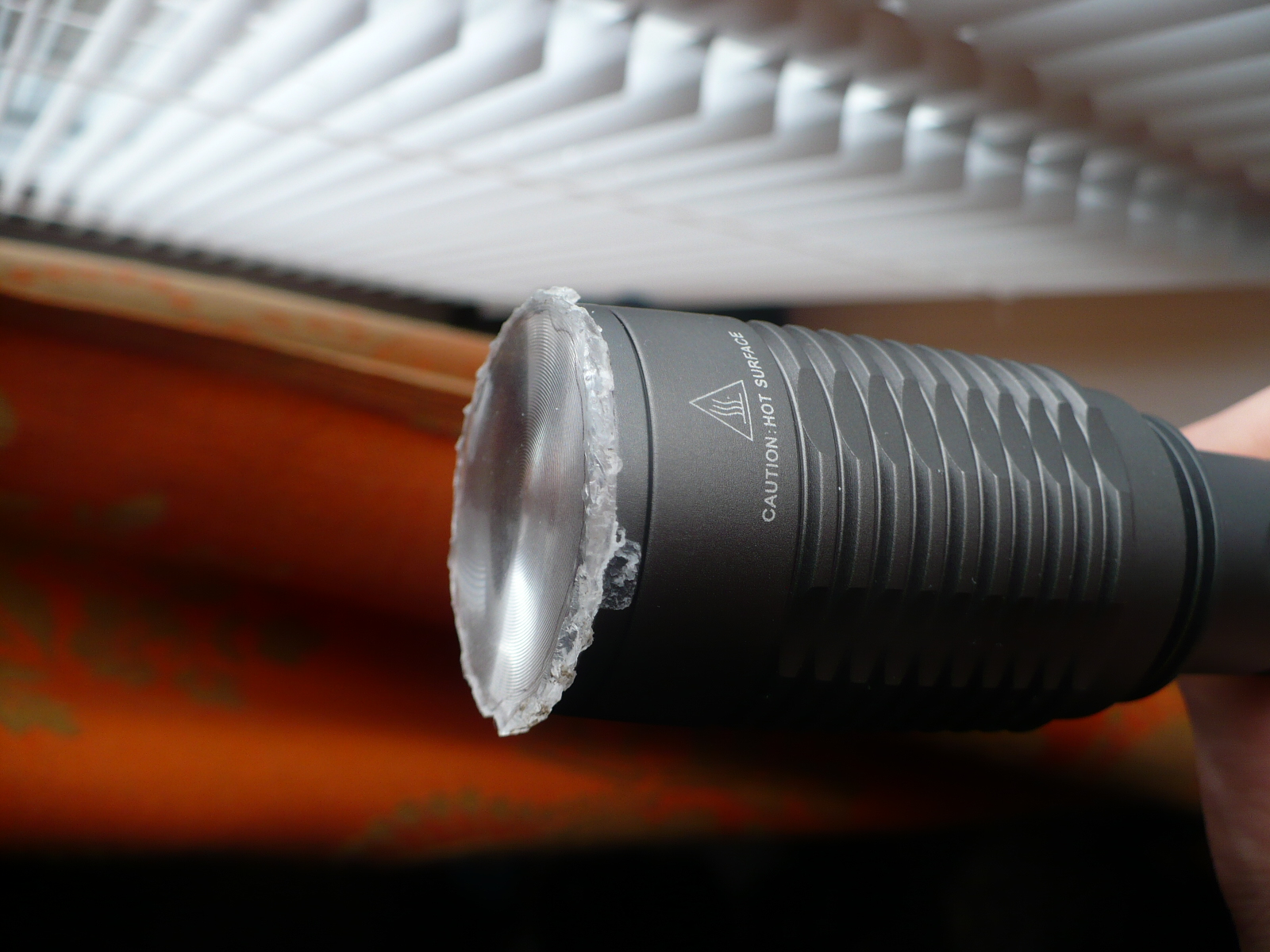

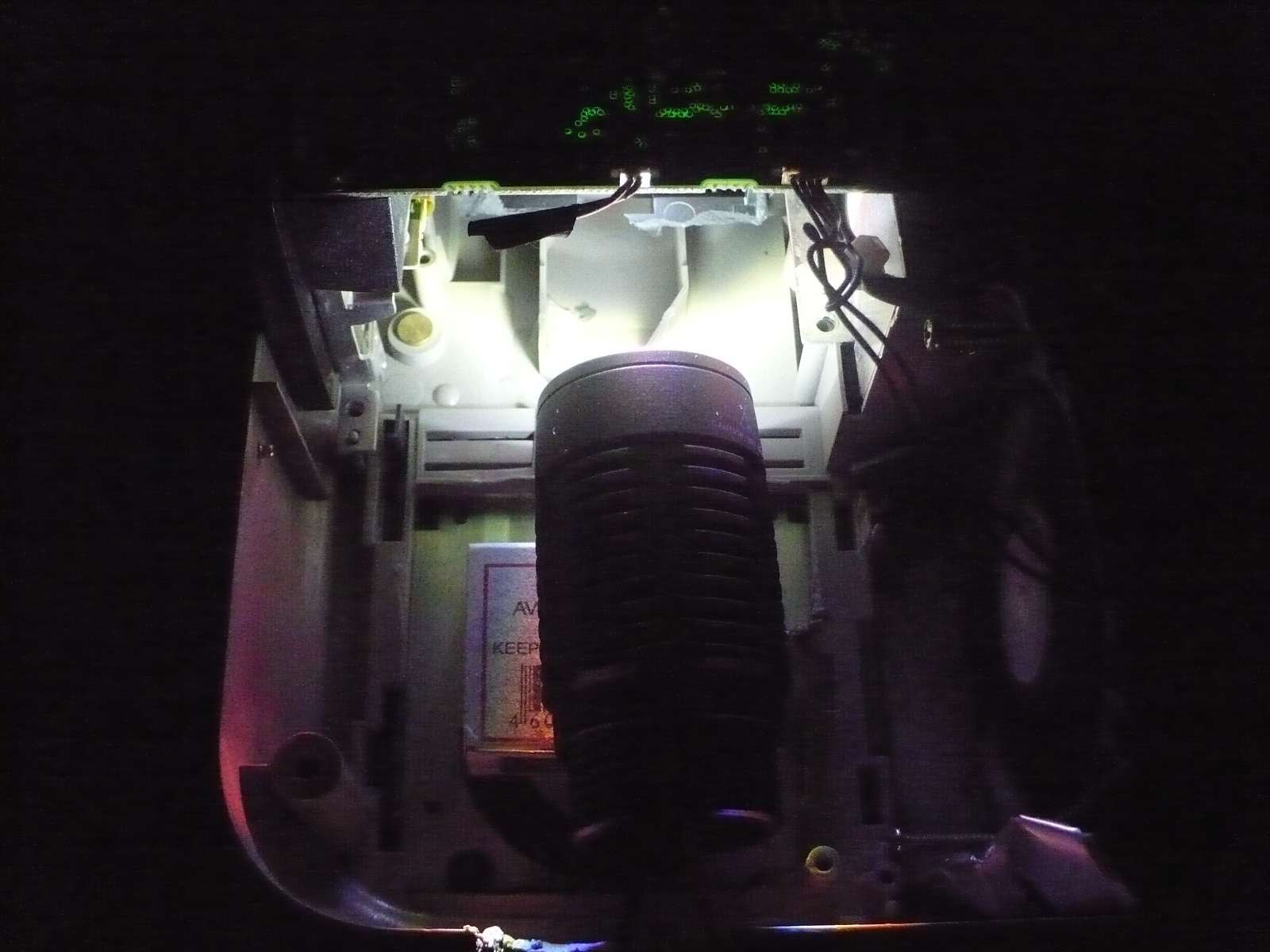

second mod with TRUSTFIRE Z1 1600 LUMENS flaslight
i removed the fresnel lens and use the flashlight only
used ~7,5v 3A adapter from old Macintosh laptop for power supply

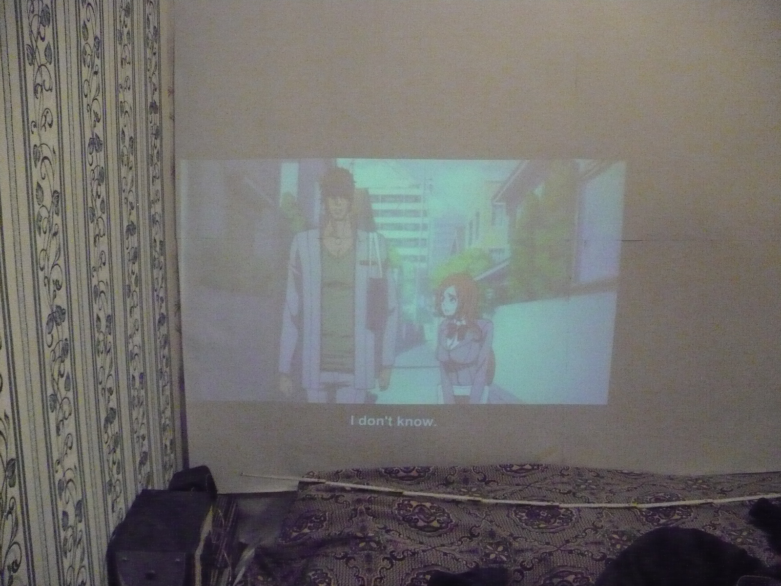

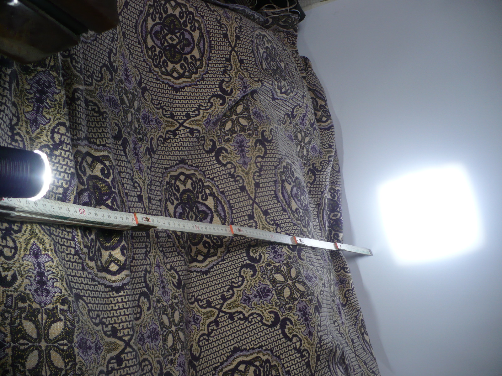

i put a fresnel lens on the flash ligh for better concentration of the beam
because when you pull out the lens to make smaller dot u have lost light with single lens
with second lens you use more light from the flash light

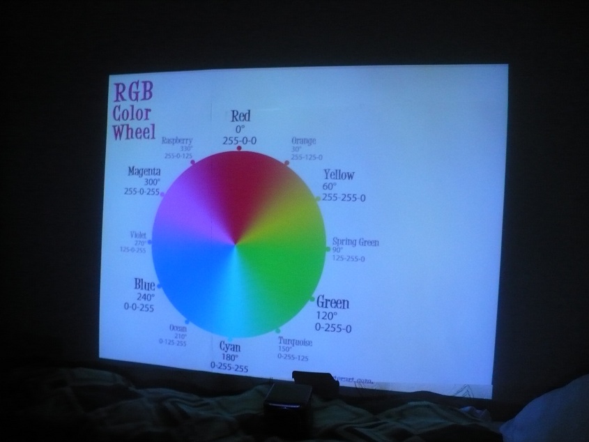

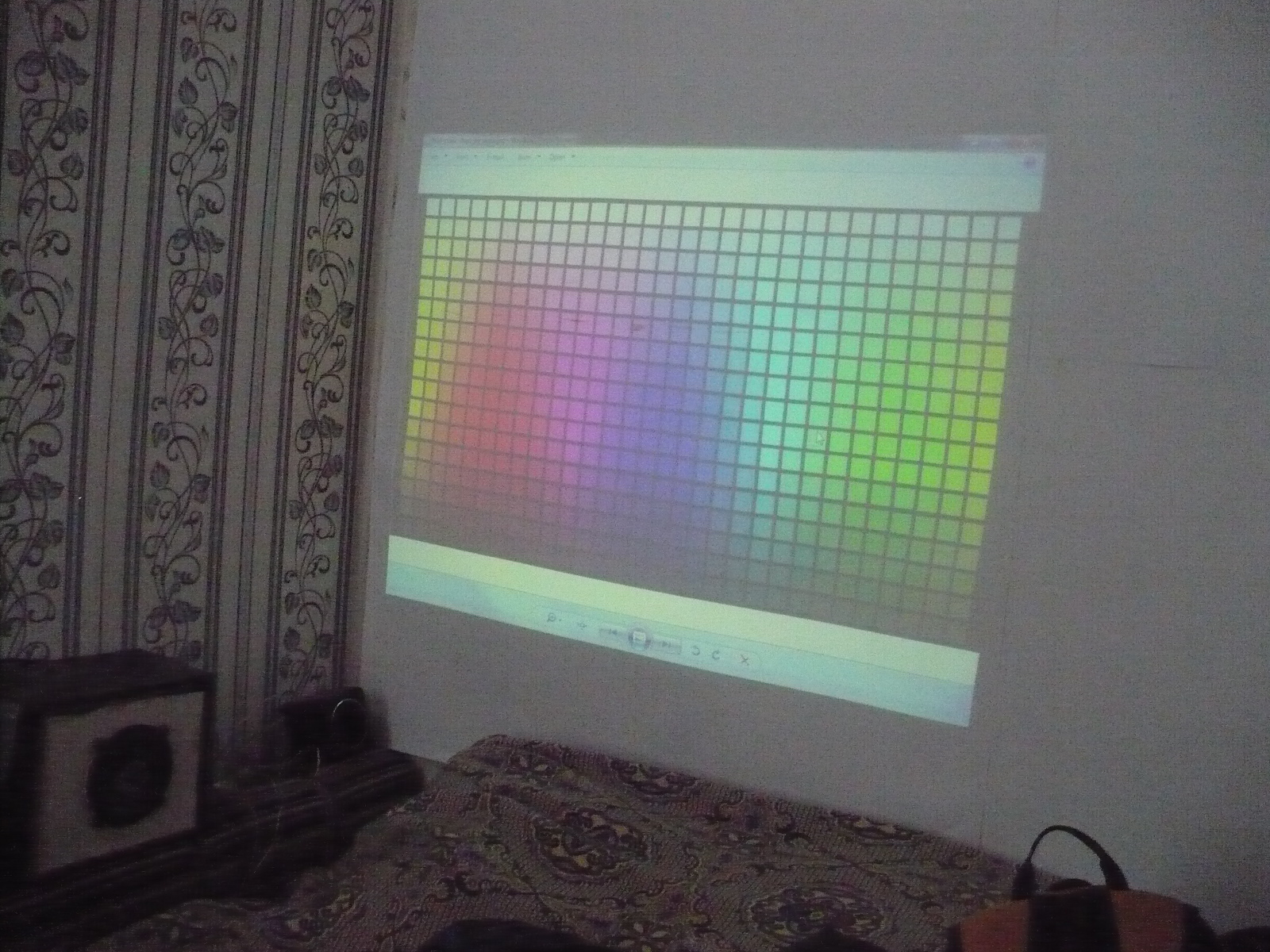

i made pics on the flashlight and what dot it make on 1meter on the wall

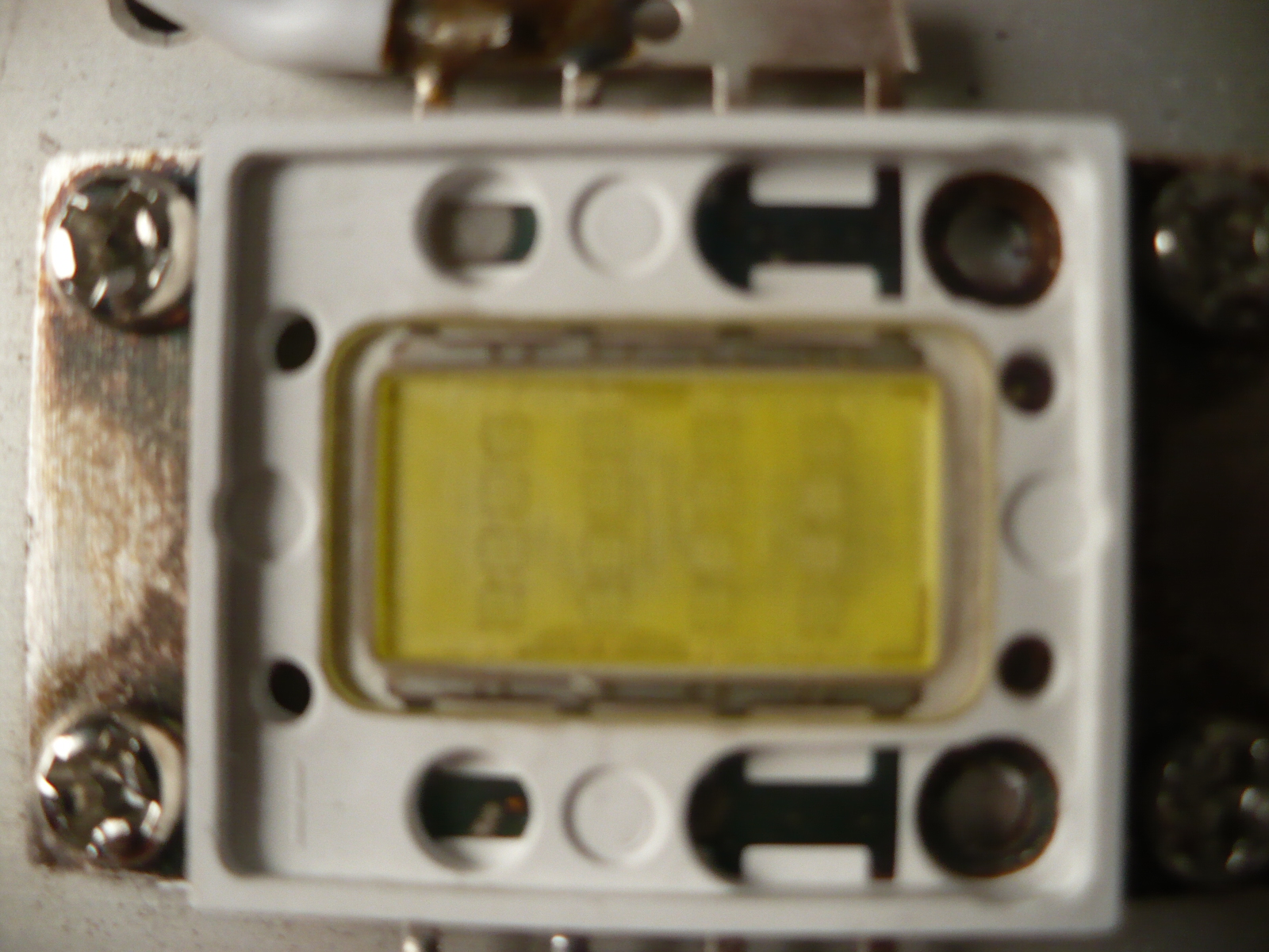

the big led i have works on 12v and i think is near 25w
i think almost all fresnel you can find will do the job
you just need to test the spaces from led to the fresnel and the first lens in the PJ

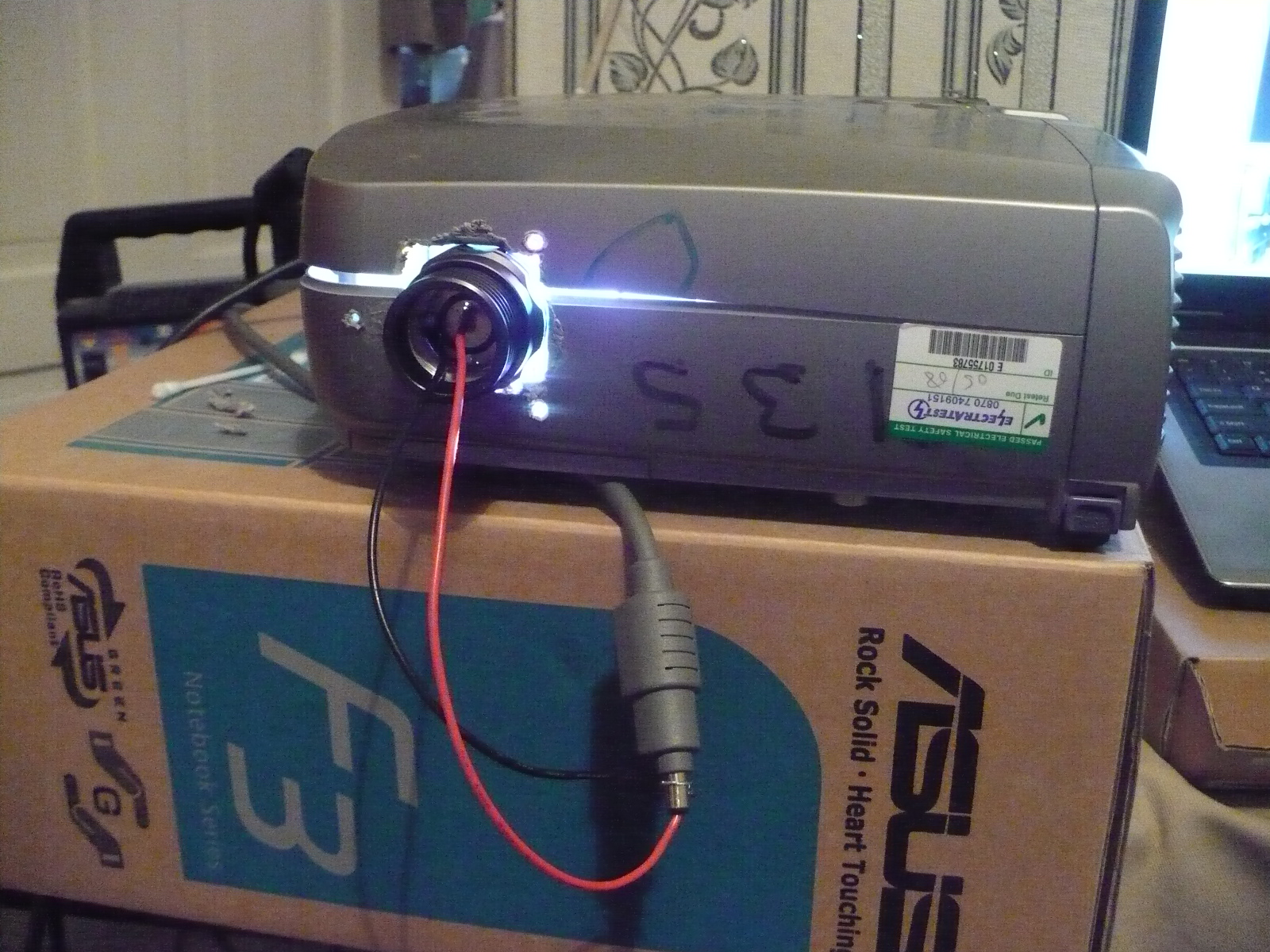

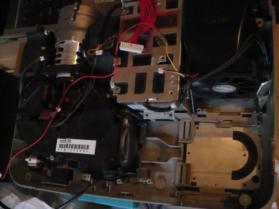

Did the same thing with Epson EMP 71. Quite simple. But...

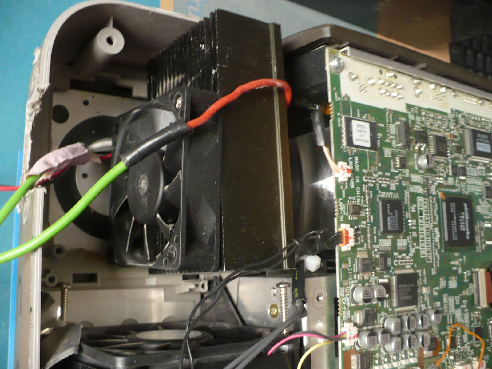

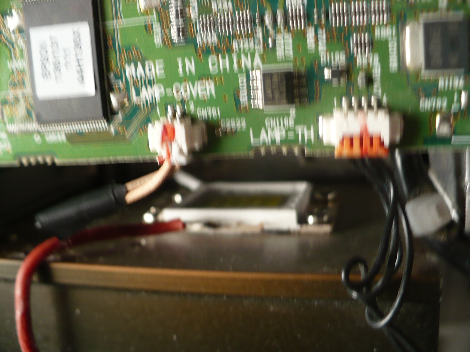

Projector fans are running like crazy even when there's nothing to cool... When i plug projector to mains power (orange led constantly glowing) i can hear fan a little bit (i think it should be completely quiet). When i turn the projector on (green led starts blinking and then become constantly lit) all fans are running at 100% which seems to be quite loud for my little room... Any ideas what to do? I just shorted two of three wires going from motherboard to lamp power supply (which means that lamp is working) and left everything else just as it was before (fans, thermocouples, thermal fuses). Is your modded EMP also this loud?
Well... i've come with workaround to keep things bit quiter...
1.) standby fan is in power supply and is not controlled by motherboard therefore it would need to disassemble whole power supply. anyway... i am lazy to do this.
2.) there are 4 fans. each has 3 wires: power supply (RED+ BLACK-) and WHITE for detection of RPM pulses. When no RPM signal is detected then projector will turn all fans at maximum speed, shutdown lamp and blink red. I guess i can disconnect 3 of these fans when using LED instead of lamp. Then i can short all RPM inputs together, so single fan will be faking 3 other fans. I have tested this by disconnecting single fan and using RPM signal from other to bypass RPM error.
Anyway... I am still looking for ideas how to lower RPMs of all fans instead of completely disconnecting them... I think it's much louder than it's supposed to be. It's possible to limit current using resistor or add some PWM controllers, but there's already PWM controller on mobo, so i think it can be tweaked somewhere else...
