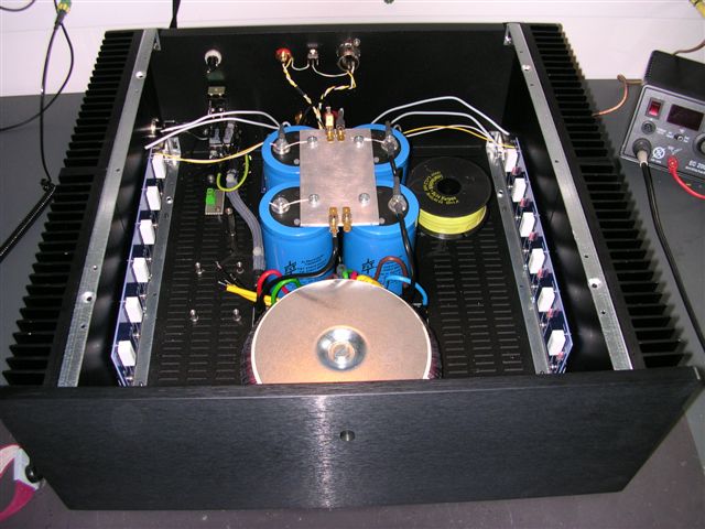

I run Aleph 2 monoblocks (about 300W heat per monoblock) in Pesante Dissipante 4U 400mm (1 box per channel). They get warm/hot but I can put my hand on the sinks and the thermal cut-off is not reached.
Hello AlbertNL,
How did you utilize the heat sinks for your monoblocks? i.e. both sides (2 sinks/side). Pictures?
Thanks for the responses it's given me more to think about with these key topics. How to deal with DC rail, power interconnect and all those caps..
I am afraid I don't have any decent photo's. This one does give an idea of the layout. As you can see, both sides are used.
Power supply uses:
  • Talema 1KVA 2 x 40V/12.5A secondaries
  • 4 x F&T 47000uF/63V
  • 2 x Intertechnik 2.2mH
I am considering some future upgrades:
Better internal wiring, extra PSU capacitors, Elna Silmic II 220uF capacitors, possibly change input and current source IRF9610's to ZVP3310A's and change power resistors.
I think that for testing it would be great to have a large separate PSU with relatively high voltage and current (as high as you will need, say 1KVA with 2 x 40V secondaries) and a variac that can handle a bit of VA's for the amps that need a lower voltage. Add two panel Volt meters to the PSU box's front panel to aid setting it up for testing. Using a thick (2.5mm^2?) short cable from the PSU box to any box with the actual amp circuit would make for easy switching.
