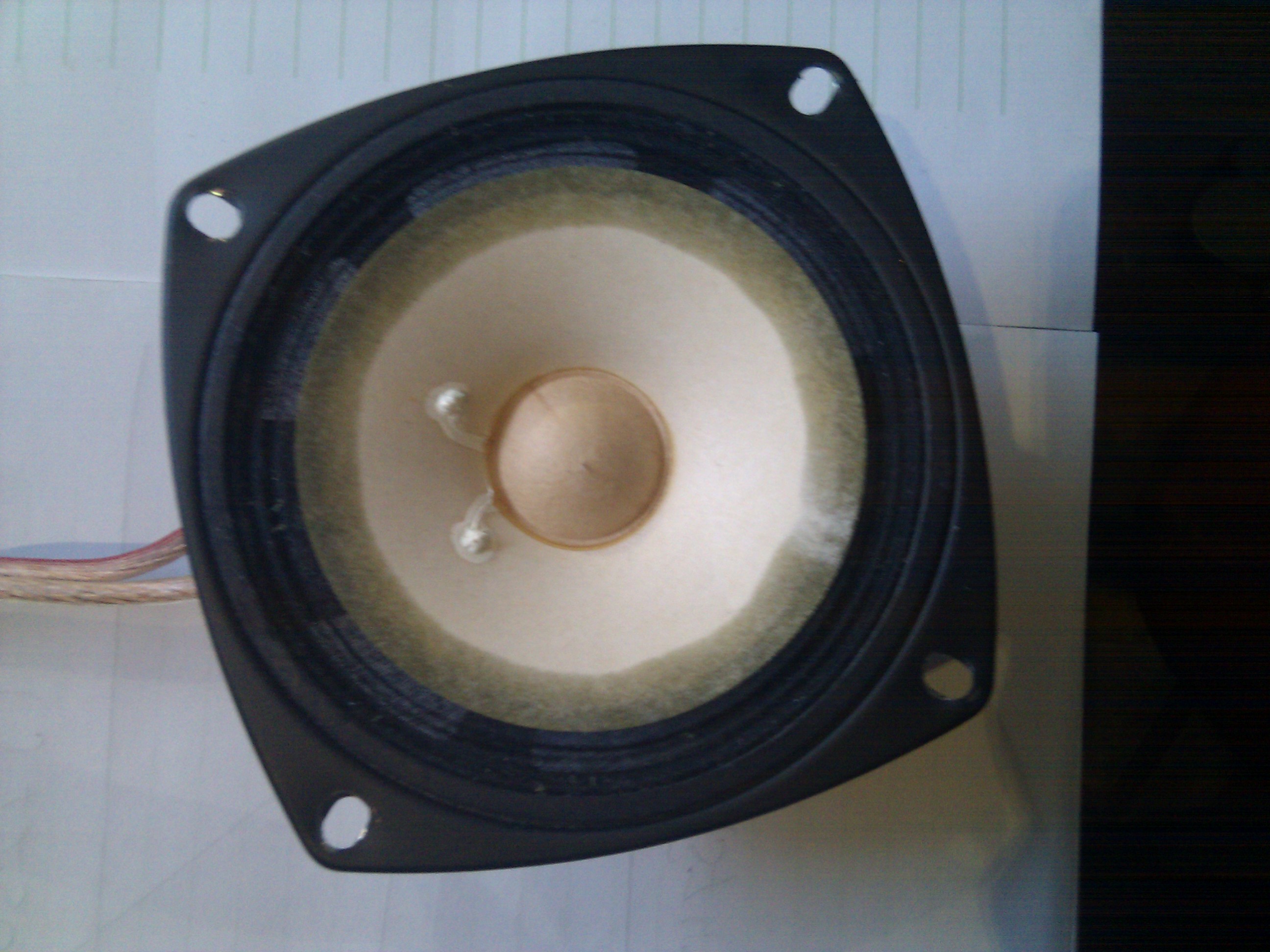

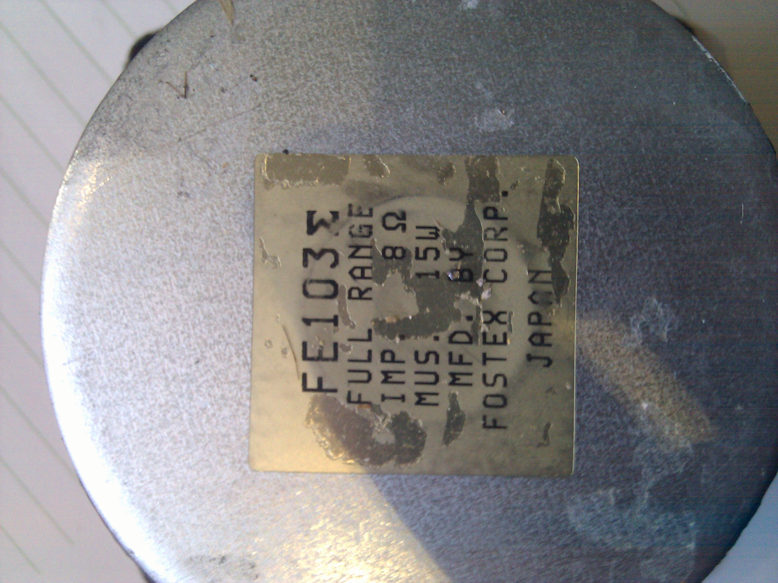

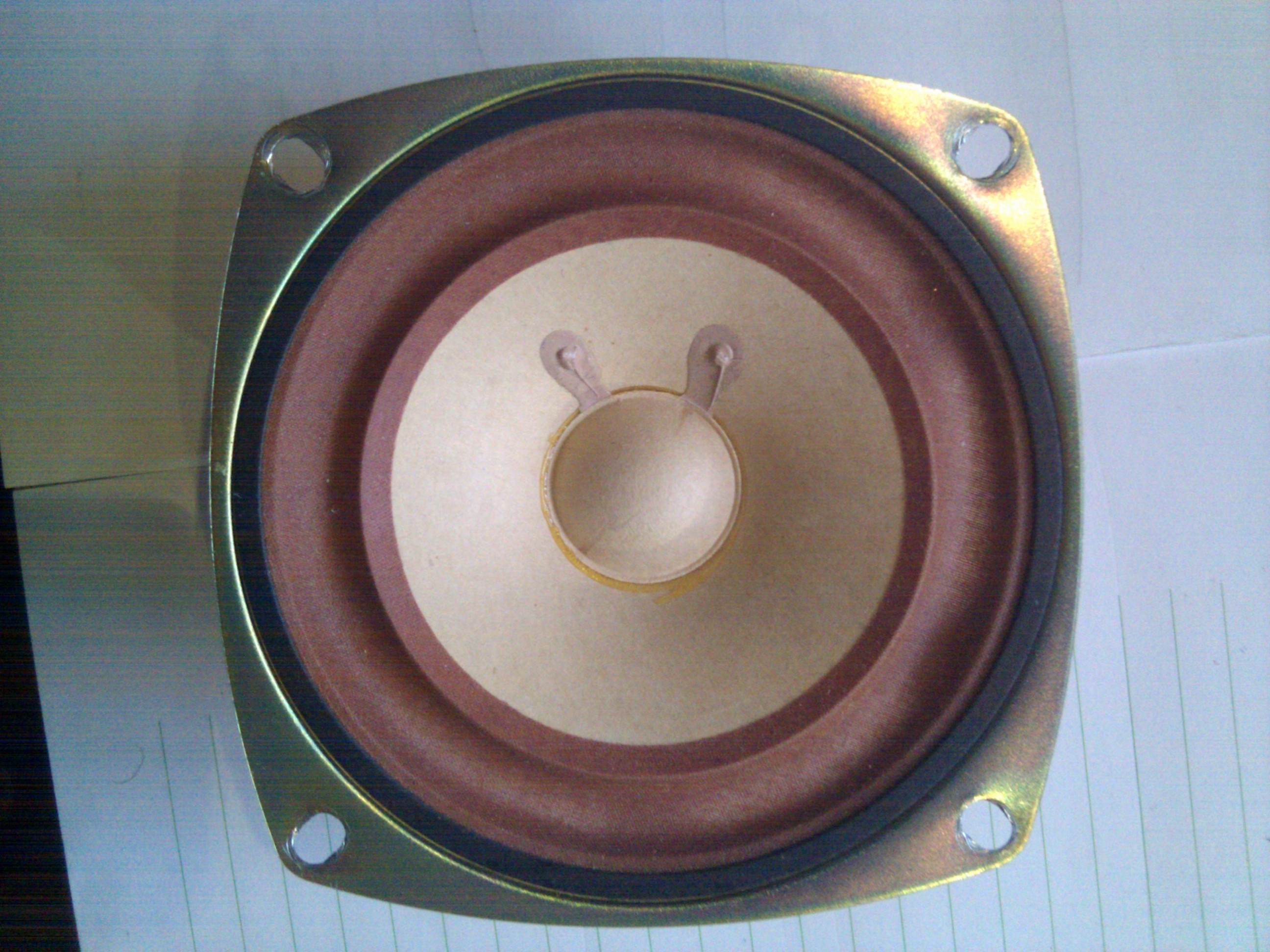

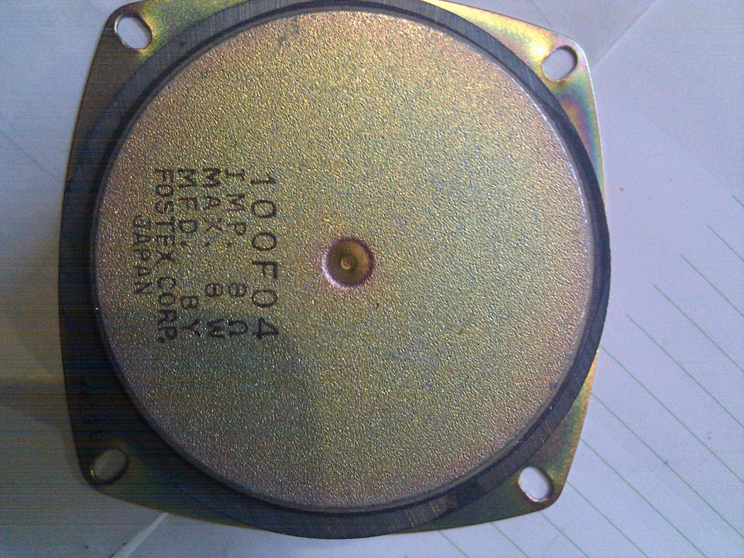

I just got my hands on some old Fostex Drivers, but I can't find any spec or information on them.
I was hoping that someone here could help out.
The first Pair is "Fostex 100 F04"
And the second pair is "Fostex Fe103 Zigma"
I would like recomended enclosures, and specs.
-Tommy

Σ = upper case 'Sigma.'
There is a certain amount of information out there.
FE103Σ - Google Search
http://www.google.co.uk/search?hl=e...272l10272l0l10886l1l1l0l0l0l0l194l194l0.1l1l0
The FE103Sigma was a variation on the old FE103, with a larger magnet structure. Fostex in this period didn't put out a particularly comprehensive set of data (they still don't for most Japan-only special editions). This is about as much as you're likely to find from them: http://www.doc-diy.net/audio/horn_de/images/acr.png
The French magazine Audiophile from 1984 gives some information: Le Fostex FE-103 Sigma
And the German magazine Klang+Ton measured some specs. back in 2000, when it was near the end of its life: http://www.diyparadiso.com/datasheets/speaker/fullranges/fe103sigma.jpg -note that at the time Fostex units were often sold under the ACR brand name.
And here's another box: La Petite Audiophile
I can't comment on the designs; I only spent about 5 minutes looking & don't have time at present to back-engineer them. Since they're older units, it's likely that they've drifted from the factory spec. anyway.

The FE103 is Zigma's, With the greek symbol.
The greek symbol is Sigma. Zigma is bad Japanese for the symbol.

The 1st is an FE103 varient. Bigger magnet than the last 3 generations. Made in Japan probably dates it to the late 70s, or the 80s.
The 103Σ is based on the same platform, probably differing only by having an even larger magnet. Yours has had some leakage from the surround glue onto the cone, you should check to see how well attached it is (very common in the even older alnico version of these drivers)
