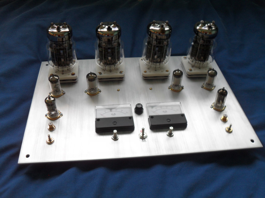

This is my first post so bear with me please,
I have been collecting parts to build the Tim Mellows OTL for about 3 months now and have now started the build..
This is my second recent valve project , I did build a Mullard 5-10 back in the 70s so I chose the Mullard 3 -3 stereo as my return valve listening (mainly due to having the ef86 /el84 tubes + transformers from an old tape recorder) it sounds fantastic but it is not quite loud enough.
I have spent the year playing with different circuits and Tim,s circuit seems the most sensible OTL yet, so I have decided to go with it... I will post pictures of the progress as I go.

Hi smith01793 only one of the images is coming up for me. If I open the links in a new tab they work. You might want to try attaching the images direct.
Click the Go Advanced button and you have a section to manage attachments.
edit: make that two are visible the last one works too.

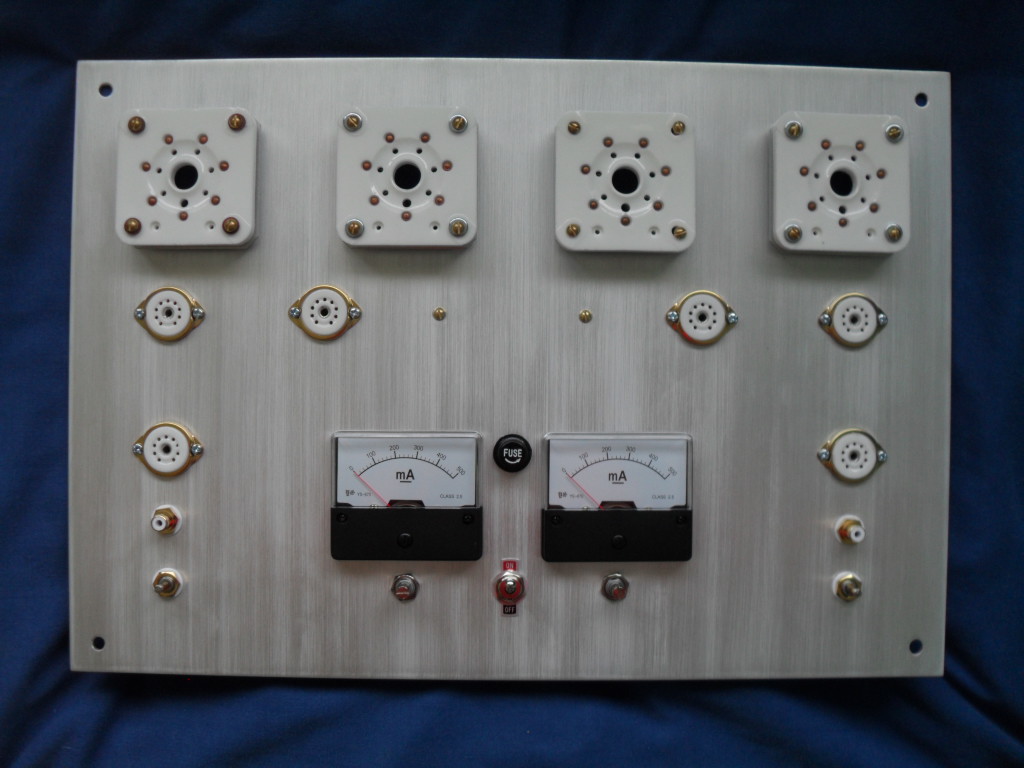

Interesting comments RE the Tim Mellows design..
I chose it for two main reasons,
1) the total cost of the build will be about the same as the tubes and transformers for something like a 300b build.
2) In my experience... the more simple a design, the better results.
I am still working on perfecting the anodising.. once the top plate is anodised the build can start hopefully this should not take me too long as I have booked a week of work
