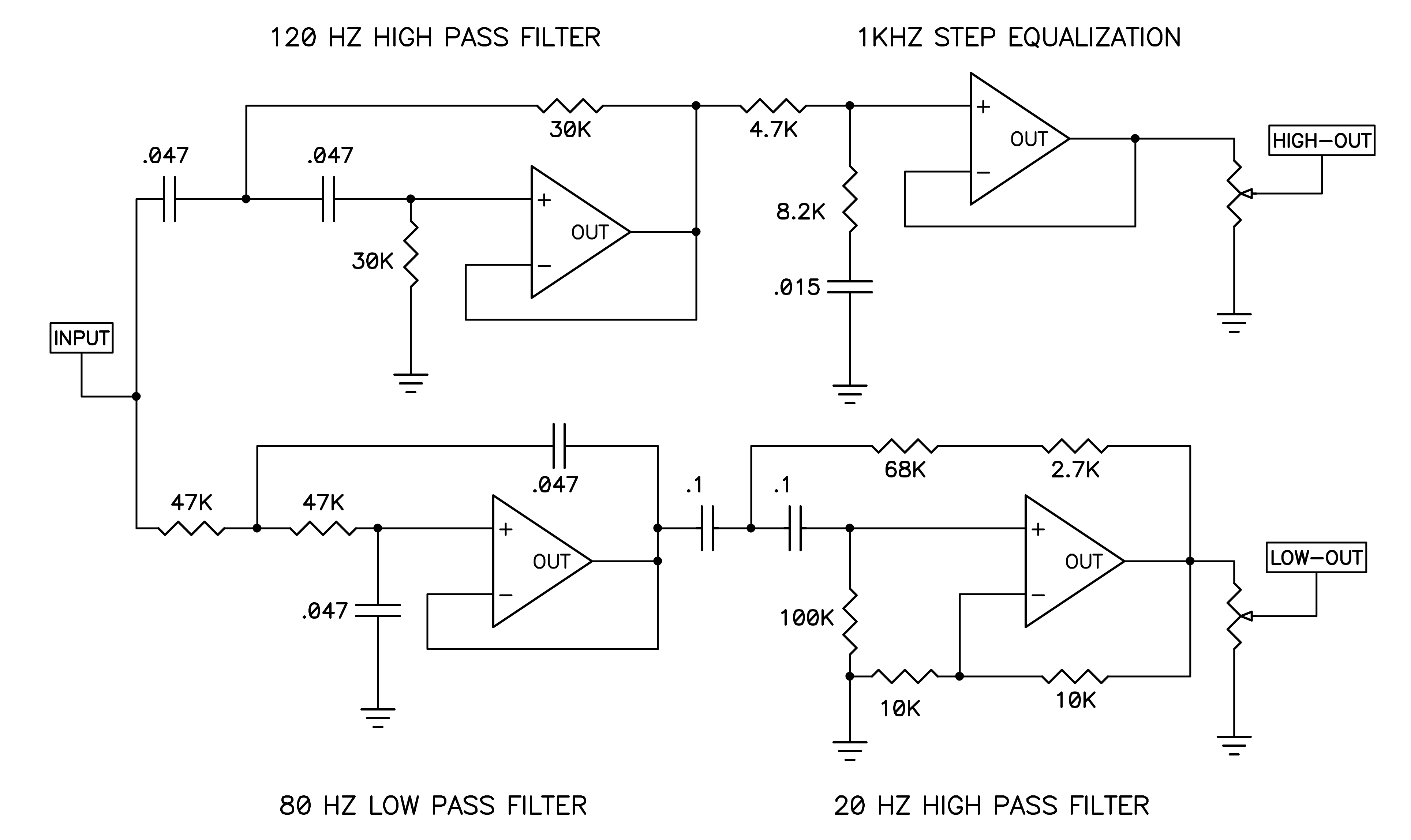

The crossover that worked well can be done with a First Watt B5, which is
documented at FIRST WATT or can be done DIY if you feel comfortable
coming up with some op amp or discrete buffers. A fine example is a
variation on the schematic circuit shown in the Slot Loaded Baffle article
on enjoythemusic.com.
The high pass filter is 12 dB/oct at 120 Hz, and the low pass filter is 12 dB
at 80 Hz. Both drivers are wired in phase. A 6 dB bump at 20 Hz is provided
by a high-Q low cut filter, and the top end is shelved down 4 dB above
20 KHz.

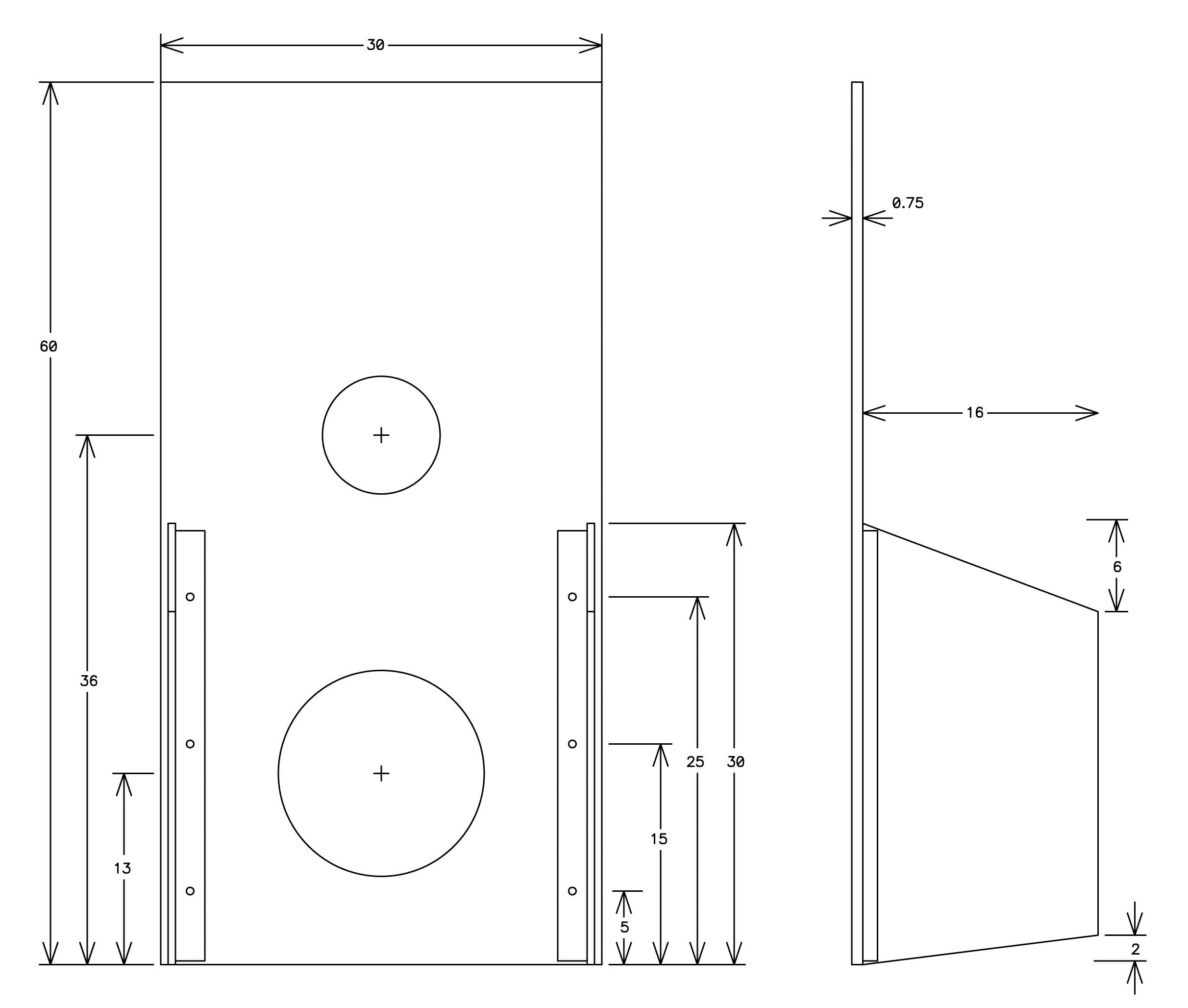

The DX55 is mounted at 36" high in the center of a 30" X 60" open baffle,
and the woofer is mounted below that. The open baffle is supported by
wings on the side rears, 12" to 16" deep and about 30 " high.

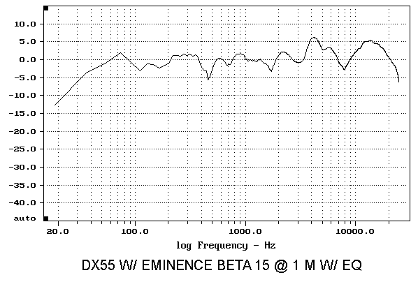

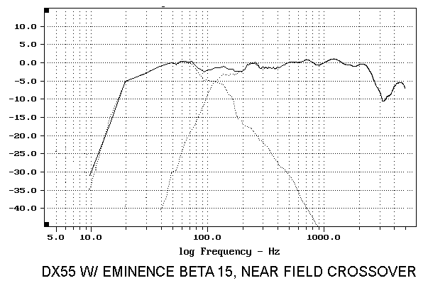

Attached are two graphics, one showing the near field crossover response
of the drivers separately and together, and another showing the response
full range taken at 1 meter on axis.
