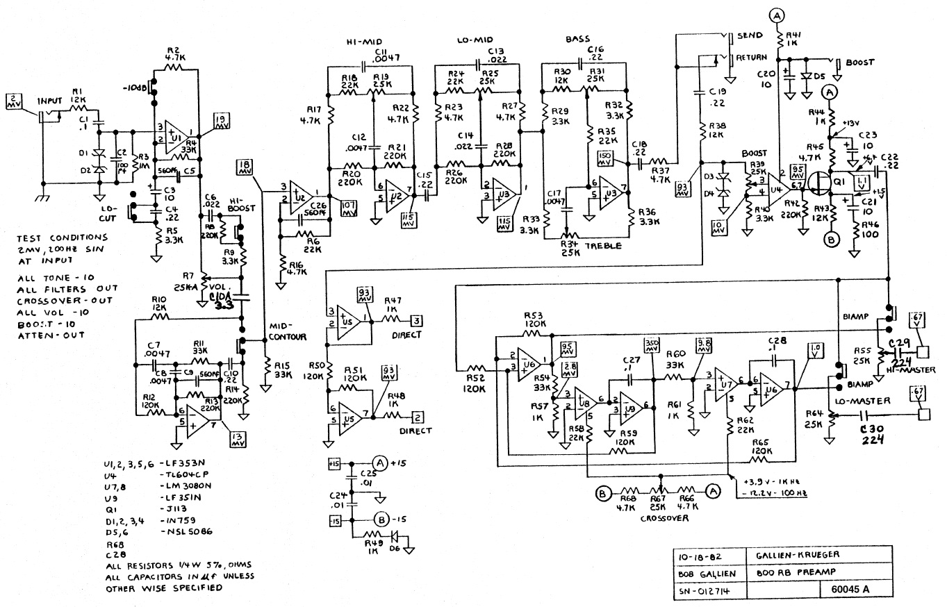

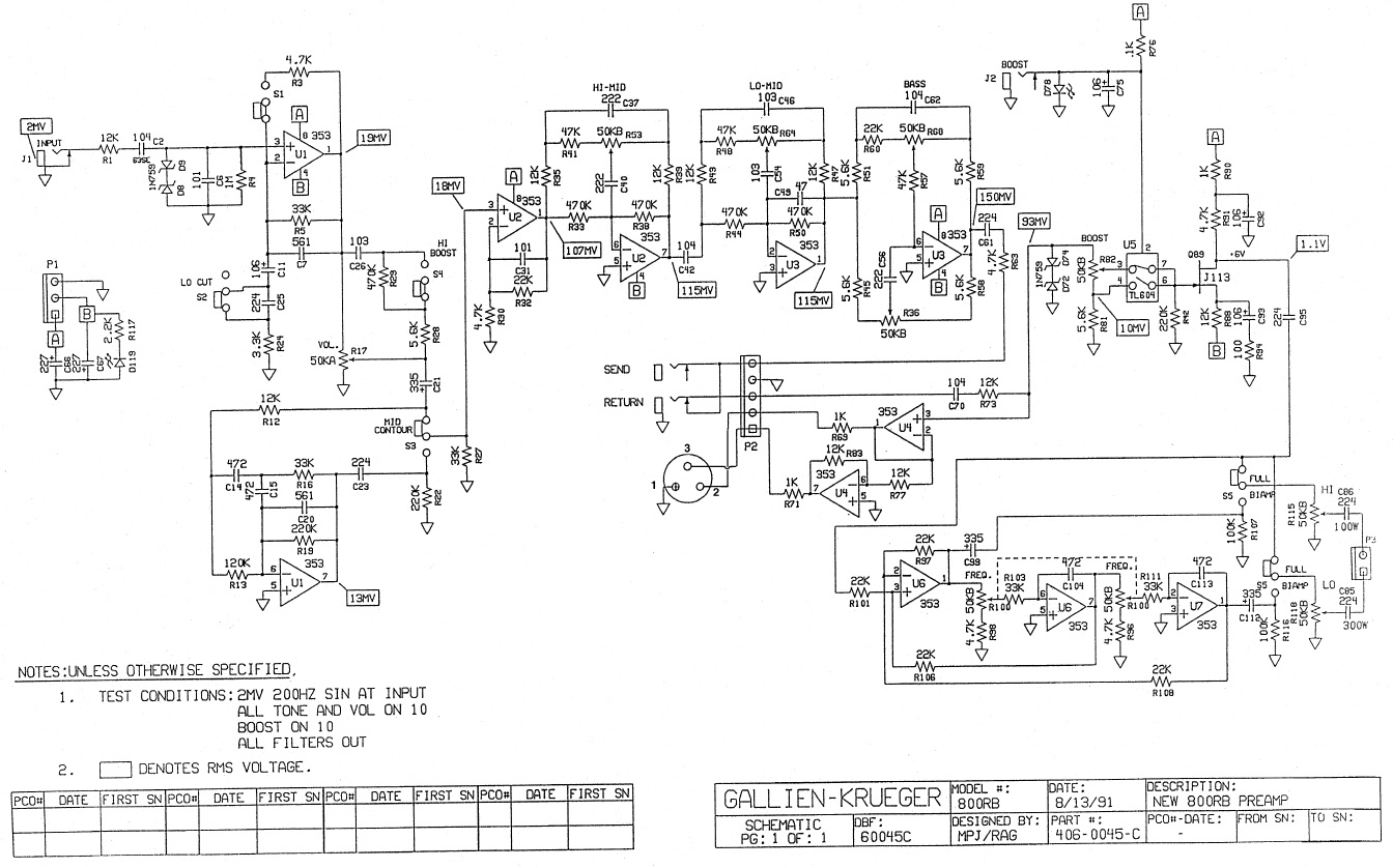

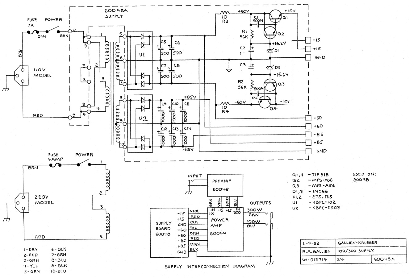

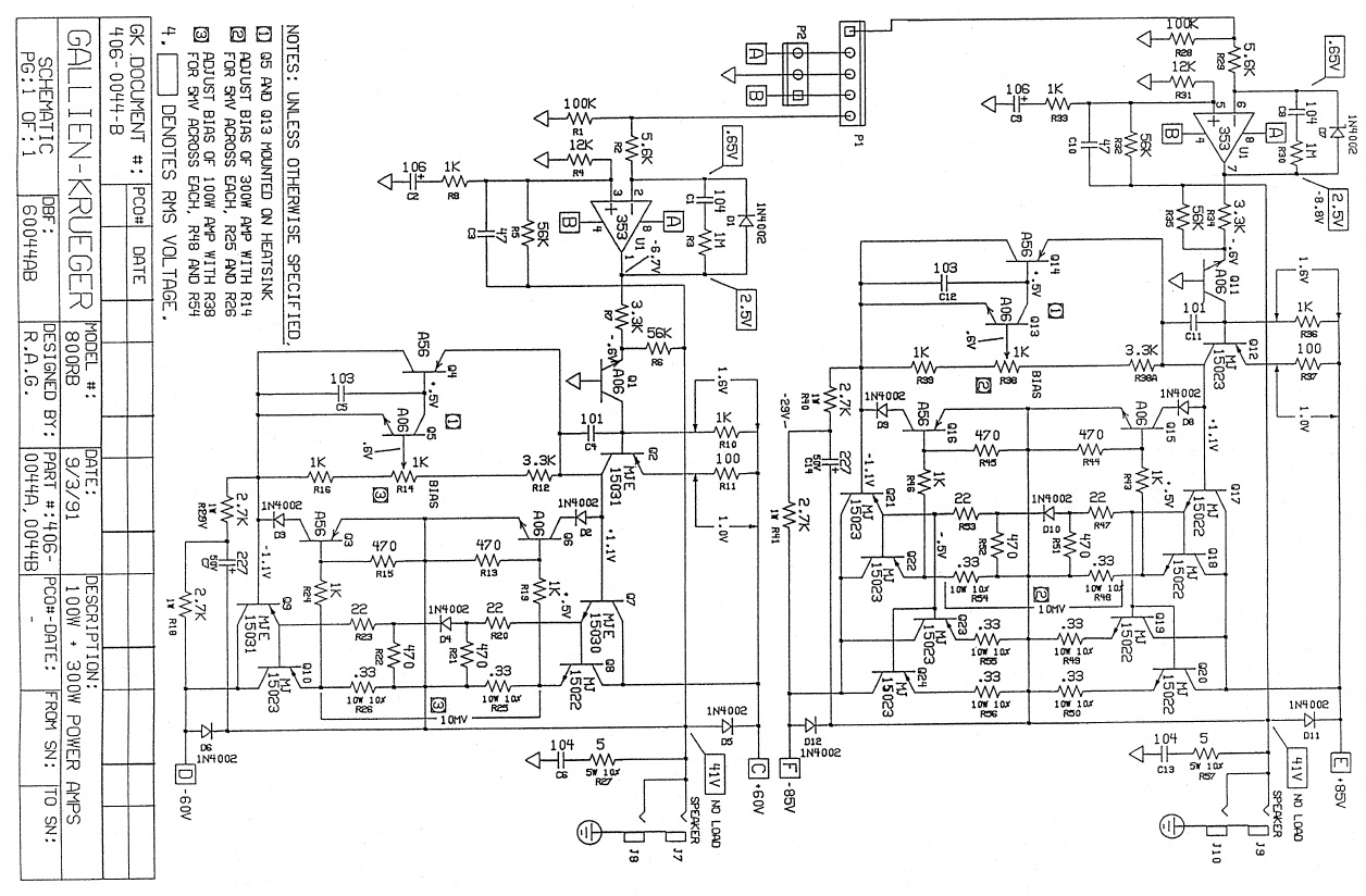

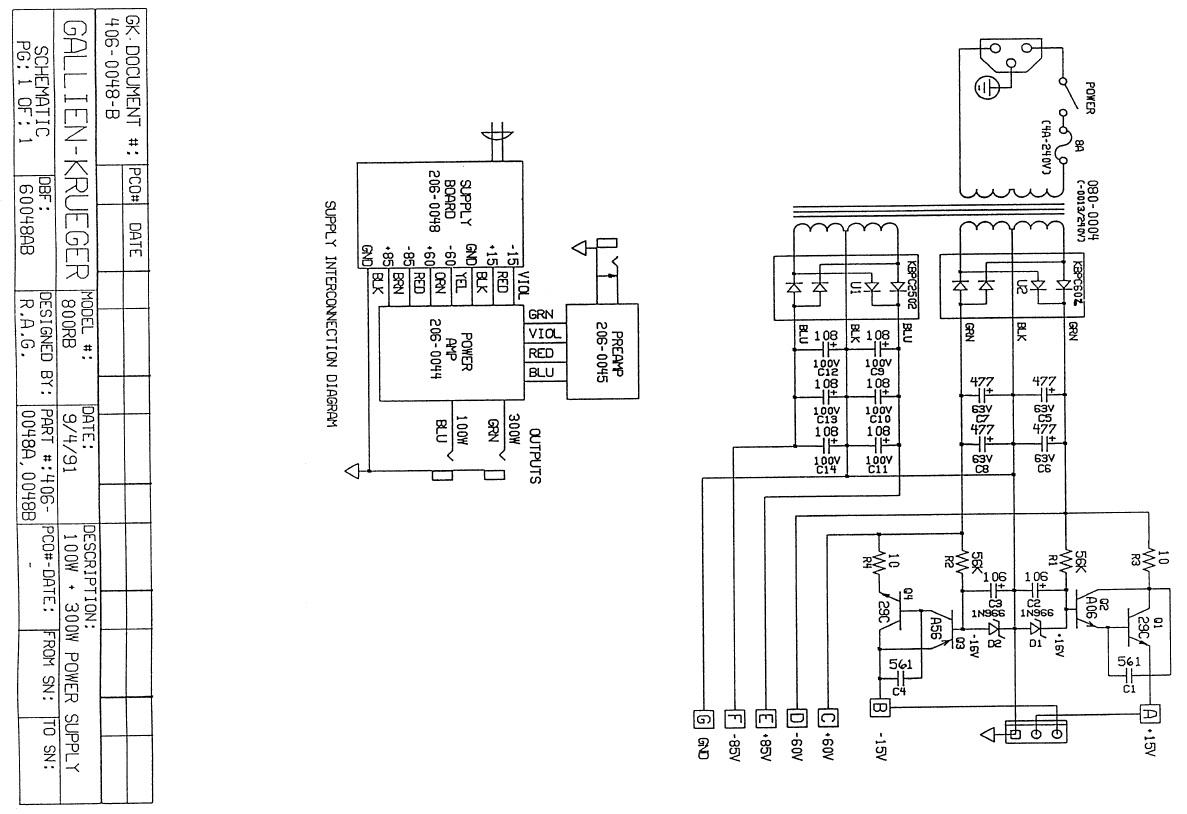

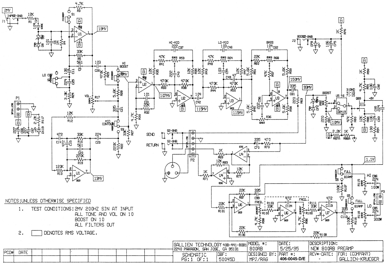

So, after a bit more looking I found that there have been a few redesigns for this amp. I have attached schematics from 1982, 1991 and 1992. I haven't looked at the differences between 91 and 92, but 82 is notable as it uses a single pot for the hi/low crossover whereas the 91 and 92 use 2 pots ganged together.
