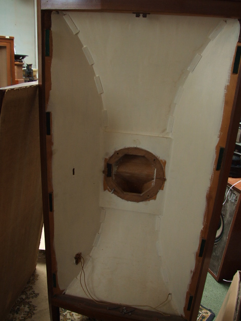

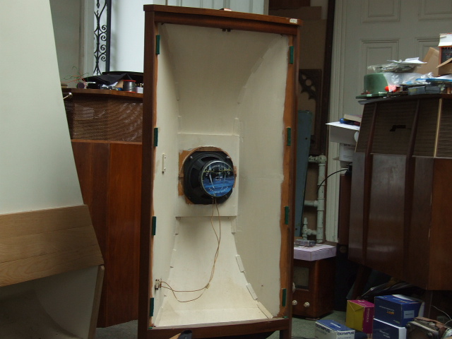

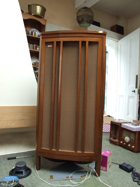

This week some friends in Surrey had a pair of Wordens of the 5ft high variety and kindly let me have them.
Worden's continue to fascinate - he was a nuts designer who had a fetish for reversing the unit into the cabinet rather than facing outward.
The larger speakers were apparently made with Wharfedale 10s in mind but mine were modified for a pair of Lowthers. Thes face forward into a divider-reflector - upwards into a helmholtz resonator with a slit vent on top. The lower direction faces into a horn facing downwards to the floor. The sound from the reverse of the unit is reflected on each side by the 45 degree reflectors from the corner whilst at top and bottom the sound is reflected by the concave shape of the horns. This means that the sound from the reverse of the speaker reflected from the exterior of the horn is in phase with that coming through the horn at floor level. The cuvature of the double horn shape to bottom and top means that the sound is projected forward and focussed at the centre of the speaker, the speaker producing a sweet spot vertical height of armchair listening position, whilst radiating laterally evenly.
Top treble relies on lateral transmission sideways from the reverse of the cone. With Lowthers and other twin cone speakers, there may be an element of transmission through the outer cone and a phaseplug may be helpful in sideways treble dispersion, particularly potentially a long cylindrical one.
Not having a spare pair of Lowther drive units to hand currently I've put in a pair of Audio Nirvana Super 8s and they sound very natural. OK - the Lowther TP1 of course sounds better - but the Worden's sound good and give music a lot of space.

First listening proved good but coloured. This was noticed on a woman's voice, suggesting wavelengths of around 4ft and around 2ft - 2ft 6 being the distance from speaker to top of the cabinet, the upper chamber seemed to be likely to be the culprit.
With experience of the Lowther TP1 London/Imperator and placing acoustic absorption in the chamber at the start of the horn, I've placed some absorption, about 9 inches square on the upper reflector and going into the upper chamber. This stops reflections from the closed upper chamber reflecting back and coming out through the speaker.
The wide magnet of the Audio Nirvana prevents treble coming directly out and ensures that treble emerges sideways, towards the reflectors at sides and top and bottom, as intended.
The resulting sound is truly excellent. The cabinet cloth is the standard 60s acoustic cloth but with a muslin behind. Removal of the muslin has taken a layer of obscuration away from the treble. Being spoiled by listening TP1s I'm critical and whether a speaker annoys me is a severe test. The Worden's are not merely not annoying, but a true pleasure.

Interesting Speaker.
Can you please supply some more pictures and some dimensions. I may try to build a pair. I'm guessing that the cabinets are open on the bottom. A picture of the slit vent on the top would be most useful.

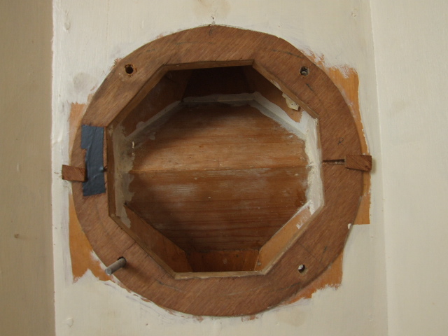

The speaker unit fires inwards towards a four faced pyramid - two faces butting the sides which are at 90 degees, and two sides reflecting up and down. Up goes into a compression chamber - which needs damping with acoustic material on the reflector and on the sides for around 9 inches to a foot in my experience so far, whilst down expands as a horn probably with a cutoff rate of around 150hz or so. I have put a triangle of metal underneath to reflect treble there forward.
The sound on classical music is superb, although somewhat constipated on full orchestra although this might be an effect of compression on music through teh radio. On baroque music with harpsichord continuo the Lowther DX4 is better than the Audio Nirvana. Possibly a DX3 might be good. I'm using old bullet phase plug rather than the pepper pot. The longer old PM7 one might be better. With the Audio Nirvana I have glued a top of a plastic water bottle on the phaseplug to reflect top treble sideways, as this is the source of the top treble emanating sideways to be relected by the panels at each side and the focussing reflectors top and bottom.
The wide dispersion that the design achieves eliminates that tight sweet spot of many fullrange speakers and the sound is very open - it achieves elements of why we might like front horns, back horns and open baffle.

The triangle reflector is just that - reflecting up into a compression chamber with vent - a bass reflex, and down into a 150Hz or so horn. It doesn't need baffles for a treble horn . . .
