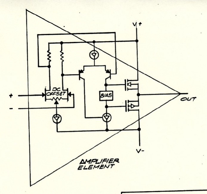

DMC-10 simplified schematic, for reference.
As you can see, it is essentially the same kind of circuit as the Pioneer, but with J-Fet inputs (NPD5566 like so many US Pre's of the time, matched 2SK246 can be substituted with minor changes, according to Kaneta and some of his followers 2SK30 is best for input pair) and lateral Fet outputs (VN.. and VP.. parts long obsolete - nowadays I'd use 2SK214/2SJ77 or related).
The J-Fet inputs improve input level handling and linearity, as well as RFI resistance. The Fet outputs largely remove the loading on the VAS (some nonlinear capacitance remains, but very little).
With the Hitatchi TO220 laterals I recommend above you can easily run a few 100mA quiescent current to get pure class for even low impedance headphones.
Ciao T

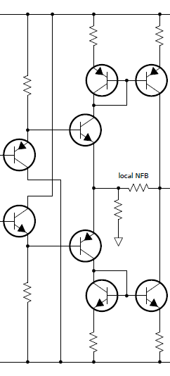

The "diamond buffer with voltage gain and feedback" is known as "current feedback" It is quite common, as is a Sziklai Output.

"The "diamond buffer with voltage gain and feedback" is known as "current feedback" It is quite common, as is a Sziklai Output."
Are you sure about this? A diamond buffer has nothing to do with current feedback.
Yes, I am quite sure about that.
The description in parenthesis was taken from the OP's post and his description of the circuit. The actual circuit is the one I commented on, a current feedback system with diamond transistor front-end (e.g. AD844 in IC's).
Of course, to understand this would actually require reading posts and knowing a few things about basic electronics, prior to commenting.
This is something that long gave up from certain people, these days I only expect from those are educated, well mannered, reasonable and knowledgeable...

My question was asked in a perfectly civilized manner and without any other intentions.
However, since you chose to interpret my question as a hostile challenge, let me restate it it in terms you may better understand:-
You don't need a diamond output stage to create a CFA.
Do you understand how a CFA works, and why?
rjm
Joined 2004
Thorsten is correct, it's a current feedback circuit element. (see here) There are symmetrical current mirrors on the collectors of the diamond buffer output transistors, with the output load of the mirror tapped to return a proportion of the signal back to the diamond buffer output.
When I was parsing the circuit earlier I saw the feedback resistors but my brain did the I-V conversion automatically :) and I saw it as voltage feedback rather than current feedback. Sorry if I was unclear.
