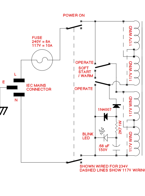

anyone using an inrush current linter on their tube amps. this one is rated at 12 amps. so would it work on my amps that have 10 amp fuses?

A lot of missing details about your amps. Why a 10A fuse, to start with?
I agree,
What current are you drawing from the mains and what wattage are you dissipating in the amp? Remember that a fuse does not blow at the rated current some can be approx 1.5x the value.. I x V = W.
If you are having to use a 10A fuse because of inrush your fault current is going to be quite high. What rating is the mains cable to the amp? With resistive fault you may draw more than the cable can take and not blow the fuse... Reduce the inrush and fuse closer...
Obviously if you switch off and back on you will blow the fuse because the thermistor will be hot and resistance will be low.
EG even if your drawing 500W from the mains with 110V ..4.6A ?
Just for fun measure your AC mains current... Also a Time lag fuse can be used..
the amps come with 10 amp fuses. the amp uses 8 KT-90's and puts put 380 watts per mono block. I have 3 of them as well as 2 250 watt per mono block versions that have 8 amp fuses.
the amps each have two 3800uf capacitors of the primary rectifier.
the fuse size questions was to get input on if a 12A inrush limiter would work on a primary circut that draws 10 amps at max power. in reading the tech data on the various data sheets....there's an implication that the function has a lot to do with heat of the limiter...so when it says 50ohms cold and 5 ohms hot, not sure if that means it needs to get to 12 amps to get to 5 ohms.
Wall power into the room is thru a 220:120 step down wired as a balanced power transformer 60 - 0 - 60. The transformer is 50A's on the seconday side. two 30 amp breakers protect the transformer on the primary side....a 30 amp breaker for each 120v leg of the 220 circut. The actual wall jacks are a couple seperate 120 (60-0-60) volt outlets at 20amps using code required orange balanced power outlets .

Without getting too curmudgeonly about it if you are not blowing the fuses or tripping the breakers the amplifier should be capable of withstanding the inrush current, it was designed to do so. Sounds like one of the larger VTL amps.. Use MDL type fuses rather than fast blow, and consult with the maker of your amp.
The 12A device you are talking about is probably 5 ohms cold and more like 0.1 - 0.2 ohms hot otherwise the voltage drop would be ridiculous and it would burn up in short order. Normally they need to dissipate a watt or two to be hot enough to operate on the low resistance end of their curve.
Useless for tube amps, check the spec of this device.
Better to use a series resistor bypassed after 1 second by a relay
