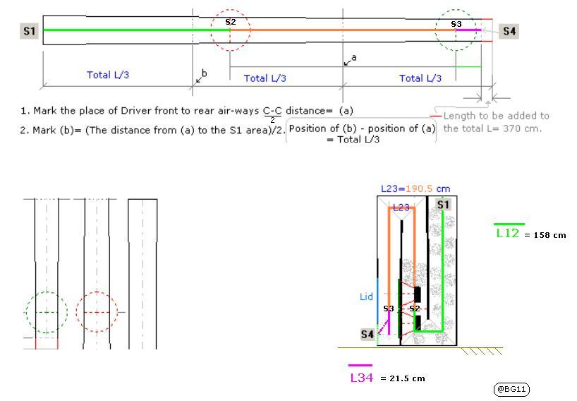

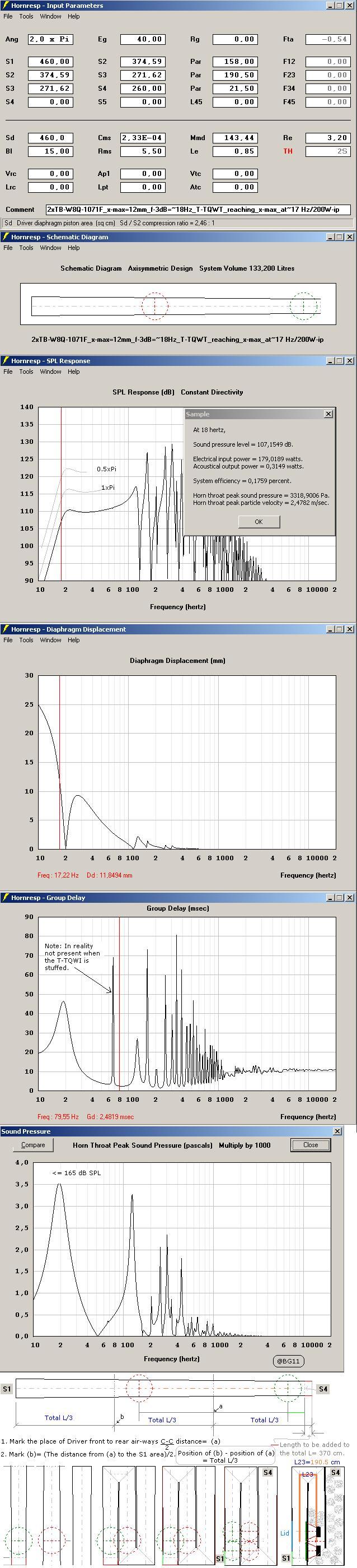

Hi permo,
Here is a simulation using two series connected Tangband W8Q-1071F in a T-TQWT that should not be driven with input powers above 200W Rms:
The design challenge is to provide enough of clearance behind the driver magnets...
b:)

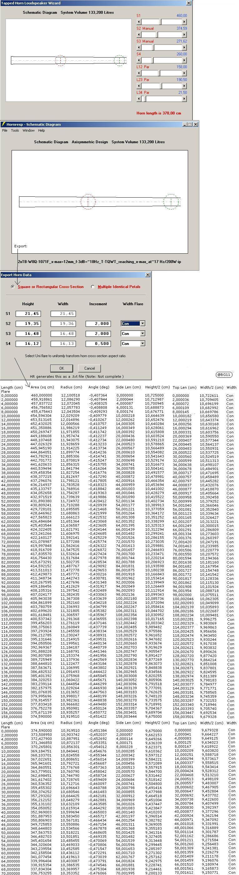

Wow, now I can see it. What kind of enclosure is this? It looks like the volume is workable for sure and it looks great. I can see the basic design, but all I get is L23......what is L12, L34..etc..etc... What driver configuration do I pick in hornresp? Clearly not a tapped horn..but looks AWESOME. Heck, I can start cutting wood tonight if I can figure it out.

Hi permo,
Here is a picture that might help:
PS: You can export the enclosure dimensions in HR by clicking on 'file' at the schematic diagram screen: Example in th picture.

I noticed L12 was 158 cm. So that means that there are 158 centimeters between S1 (beginning of throat) and S2 (middle of driver(s)) correct? That puts the drivers a ways up the horn I think?
S4 would be the lenght of the opening at the end of the horn I think? What is S3 in this design?

Hi permo,
Looks like bjorno's design from Post #3 will work well.
There are a few small errors in the lower right hand corner of the picture: S1 (the opening close to the drivers) should be S4, and S4 (the close end of the duct inside the box) should be S1; in general, all the S's refer to the cross-sectional areas of the tube (or duct): S2 is on the side of the drivers (pick the middle between the two drivers) pointing towards the closed internal duct, and S3 is on the side of the drivers (again, in the middle between the drivers) pointing towards the mouth. S1 is the throat (close end in this case), and S4 is the mouth (opening close to the drivers). All the L's (e.g.: L12) refer to the distances between the S's.
Quite correct: I seem to do this all the time,Thanks Oliver!

Submitting a picture revision of what Oliver have noticed here-above:
b :)
PS: The important distance here is L23 but L12 can be slightly off easily to correct with the necessary needed damping material. This can be shown in simulations, i.e. by using MJK:s or the AKAbak program.

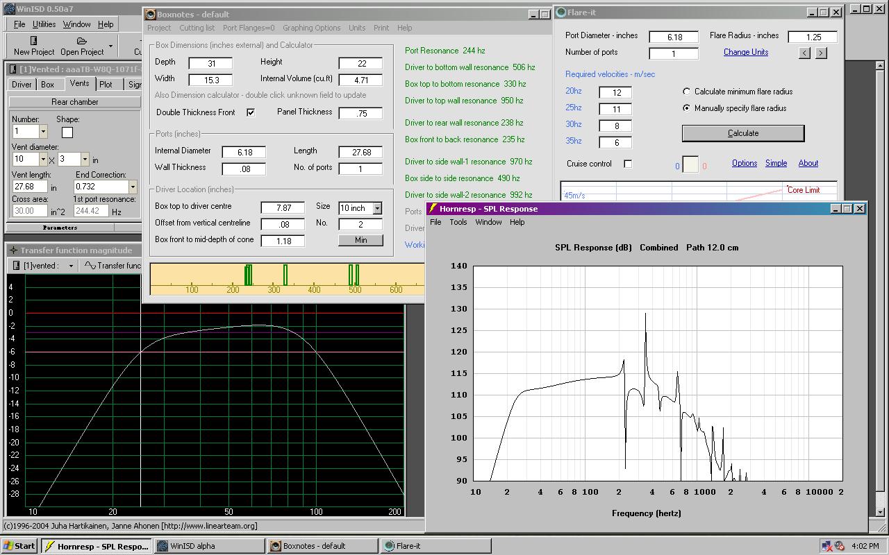

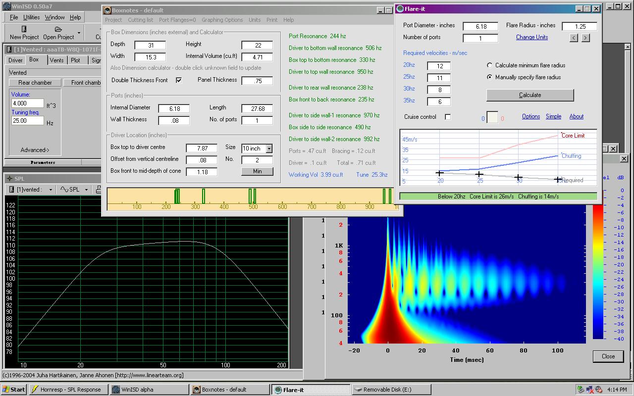

Movies you say, :) my specialty :p I like those two drivers in a 4ft^3 ported box tuned to 25Hz with a 3" x 10" slot port 27.6" long. pic below. This design would let you upgrade to a 500w amp and have reference spec.

Still trying to put a cut sheet and dimensions together for the horn. I have some questions. I totally understand S1, S2, L12, L23..etc..etc.. here are my questions
1. Does each horn segment have to be a certain internal volume or am I more concerned about hitting my S and L variables appropriately?
2. How big/long do I make the opening?
I am starting to wonder if the lighbulb is ever going to get lit for me, regarding these horns!
