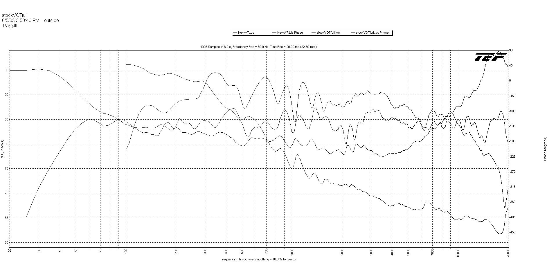

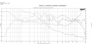

Anyway some years back a friend had a stock A-7 that he wanted to make better sounding and louder if possible. I had never worked on one although I had used plenty of Altec horns in the past. I thought what would it be like to deal with one like a Synergy horn?
Here is the before and after curves. Note, the less flat curve is the stock one, the after curve has about an octave lower corner and a similar hf extension. Unfortunately, I took the “after curve” at 1V @ 2 meters while the stock one was at 1V@4 feet so the greater sensitivity of the modified one is not evident. It is a fire breathing monster comparatively due to greater sensitivity, much greater power handling as well as having an octave or more extension at each end..
Subjectively while I only listened to it for a few days but I was surprised that it struck me that it sounded much like one of our synergy horns, I suppose from the lack of crossover phase shift and hf driver.
It had been my intention to write an “upgrade” article back then; I took pictures and had made some notes on what I did. It involved several minor cabinet modifications (and moving the horn slightly, easy), new drivers (I used a 2226 and BMS4550) and a new crossover.
