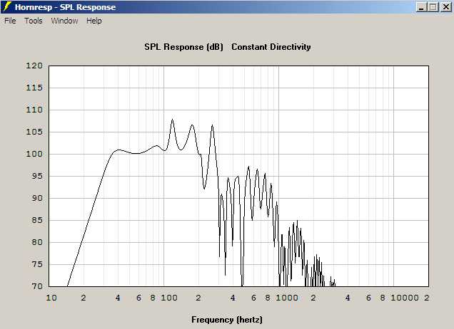

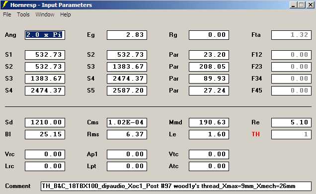

Going back to wood1y's thread: http://www.diyaudio.com/forums/subwoofers/170749-15-tapped-horn-rcf.html I found a nicely documented tapped horn by Xoc1 that actually seems to work fine with the factory T/S parameters of the B&C 18TBX100. Hornresp calculates the V_net to be 454 litres, so this might be the volume range you could use to compare other designs to.
490ltr is sim volume, I did another one that came out 450ltr flat from 30hz to 100hz.

I think its lucky that the 18TBX100 is an almost perfect fit for Xoc1's design I referenced in Post #9. That design is pretty complete. It'll be hard to improve on that one substantially, maybe a slanted board from S1 to S2 to reduce the S1 area, but that is only necessary if you try to maximize the upper end of the response.

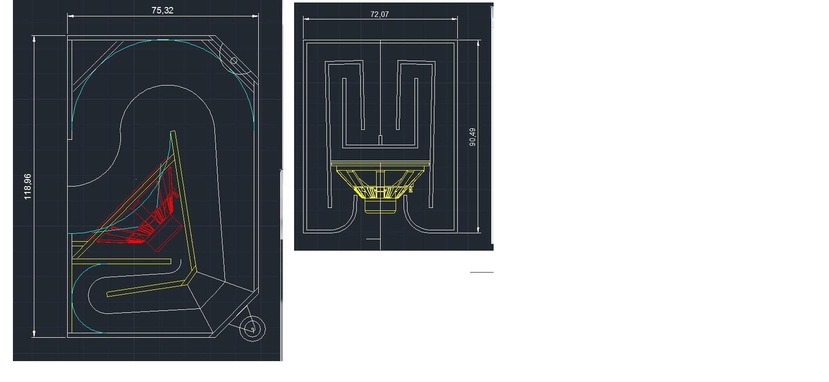

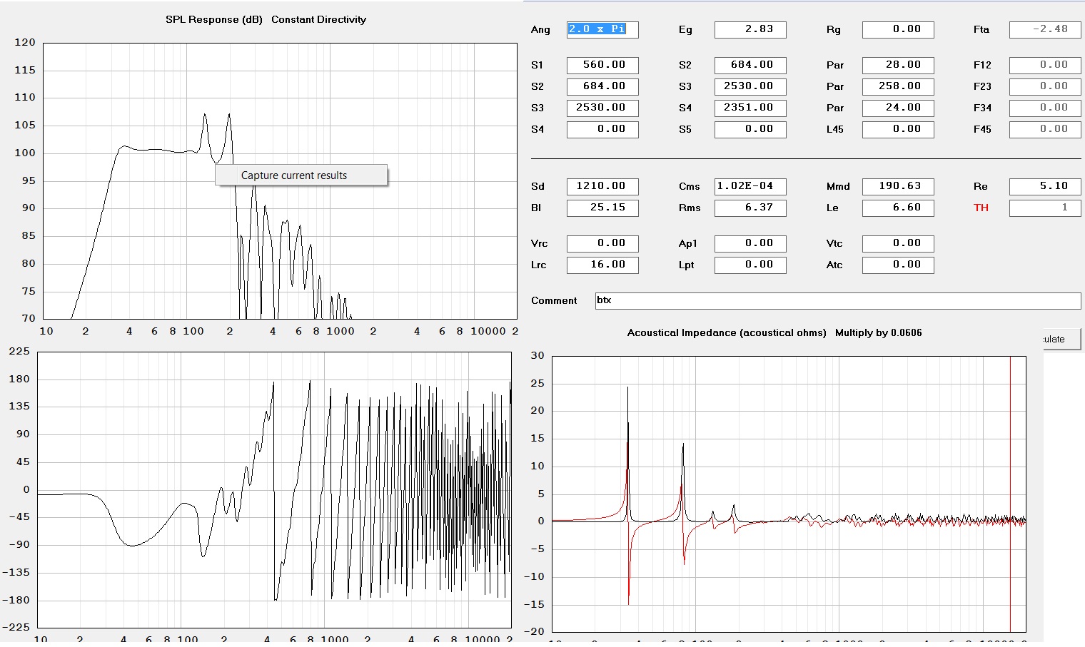

the post 5 box from the 30 hz topic is a 400 ltr cab.the tbx doesn't work that wel in it.
the post 466 is a 575ltr cab .it works in it but it could be better.
what about this design,its a bit wider but les deep also 575 ltr(stil needs some work thoug)
just noticed ,the le of the tbx is 1.6 mh :eek:
