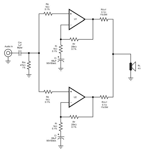

Original PA100 schematic from AN1192

the PA100 circuit in National's AN1192 doesn't use any.
It is a simple parallel circuit, not a bridged circuit, plus it is non-inverting.

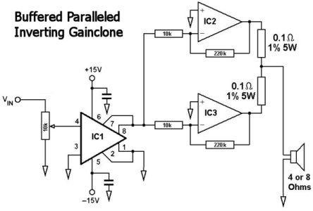

On a side note, just to make sure that I understand a bit the role of a DRV134 buffer by example, would the following works ?
Thank you a lot

If you want a buffered amp, that is inverted and as well as paralleled, than build such an amp, regardless of if you've seen a schematic of it.
It's just that the DRV wouldn't be a good buffer to use. I use an OPA627 for gainclone buffering services. You could also easily use a BUF chip or even an Elantec EL200x buffer if you can get ahold of any.
The DRV is a good balanced line driver, that's why you may have seen it in bridge/parallel circuits.
You do only want a parallel amp and not a bridge/parallel amp, right?
You're right :nod:
A buffered, inverted paralleled gainclone !
And since I'm only beginning to understand exactly which part of the circuit does what... I'm not very good at designing my own ones...
I'll give it a try during lunch time. Be warned : It may be the most useless schematic you'll ever see in your life.
Thanks and see ya
Parallel Inverted Gainclone
Konnichiwa,
Well, is it practical to make a paralleled inverted Gainclone? I suppose so. I can see no reason whatsoever why it should not in a technical sense would "work".
What I would question however is the SENSE of doing so. Paralelling devices (no matter of what type) always causes problems as while these devices SHOULD IN THEORY share the load equally, they very rarely if ever do.
The result is INVARIABLY a drasitic decrease in sound quality. Just build the same discrete amplifier circuit with one pair of output transistors or with a huge bank of them.
Okay, a paralleled Gainclone will be more load tollerant, but if you have such incompetently designed speakers that their impedance falls much below 3 Ohm I would question the speakers and would then also consider if it is possible to break up the parallel connections of drivers and rather give each driver it's own amplifier.
Often speakers have a so-called 2 1/2 Way configuration which places 2 more or less identical drivers in parallel, one working only at LF the other up to crossover frequency. If such a speaker uses fairly low impedance drivers it may indeed drop below 3 Ohm. In this it is usually possible to convert the speaker to bi/tri wiring so that each driver (plus related X-Over parts) get their own binding posts which then allow each driver to be given a non-paralleled "gainclone".
Just for an aside, 5A peak (limit of LM3875) into a 3 Ohm Load allow 40W to applied to the Speaker and around 30W into a nominal 4 Ohm Load. This should be achievable using a 18V+18V secondary transformer. In most cases I would expect this level of power to be fine for "normal use" and 4 Ohm speakers with an average (87db/2.83V/m) sensitivity.
Sayonara
