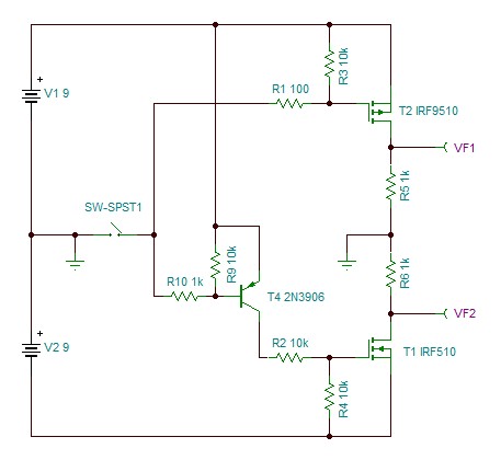

I think raudio's design will do the trick. I need to order some P-channel MOSFETs before I can breadboard it, but the simulation is working great. (I've got to get up to speed on the SPICE modeler, so I'm still using the Falstad sim for now.)
I'm not sure what VF is supposed to stand for, so I'm guessing R5 and R6 are still representative of the load, and VF1 and 2 are probe points? Is that right, or do R5 and R6 serve some other subtle purpose, while VF1 and 2 are outputs? The rest of it makes perfect sense to me.

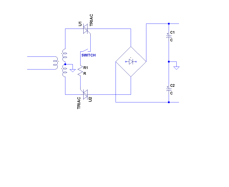

I'm glad you asked about that. I wasn't very enthusiastic about the TRIAC idea because I didn't want AC through the switch on the front panel. Hearing "gate drive current" made me realize I was making uneducated assumptions. So I can use some arbitrary DC source to turn on AC transistors this way? Neat.
I think I'll still go with the earlier plan this time around, but I'll keep this in mind for later research. :)

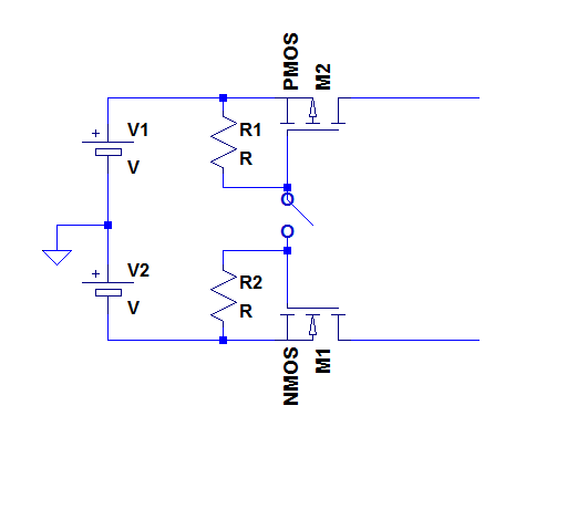

Elvee, I'm not really sure what you did differently. It seems like you moved the switch, but the circuit's still the same. What did I miss?

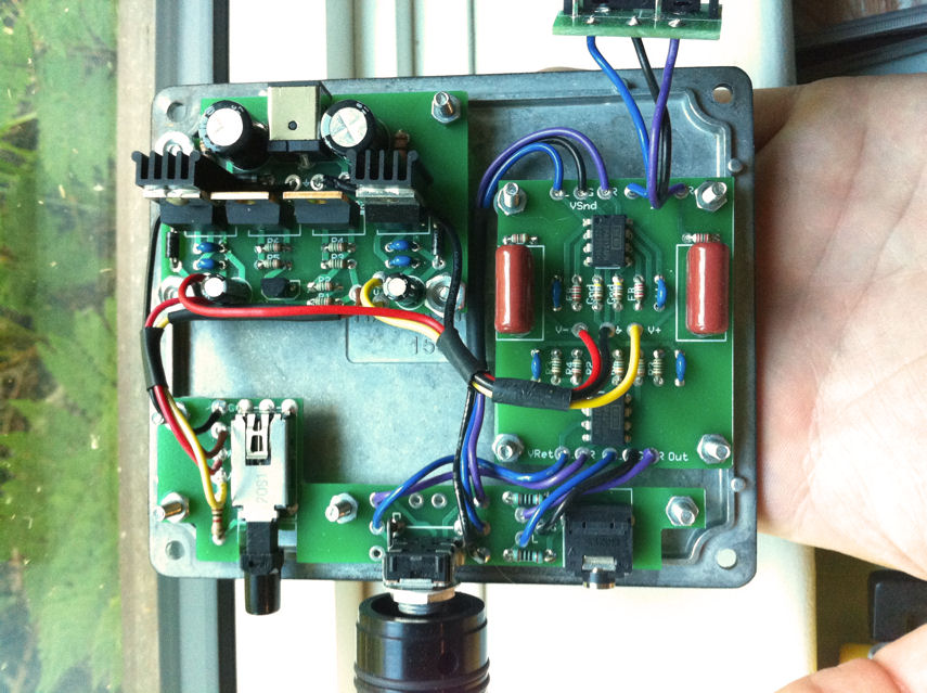

BTW, thanks to everyone that contributed to this thread. I actually built the amp with the PSU based on raudio's schematic. Works like a charm!

He Swapped the Source and Drain pin of the PMOS
My design shouldn't be able to work IRL but somehow it did in simulation.
Hmmm..... Seems rather complicated just to switch 2 rails...
Both mine and moody's circuits should work fine.
