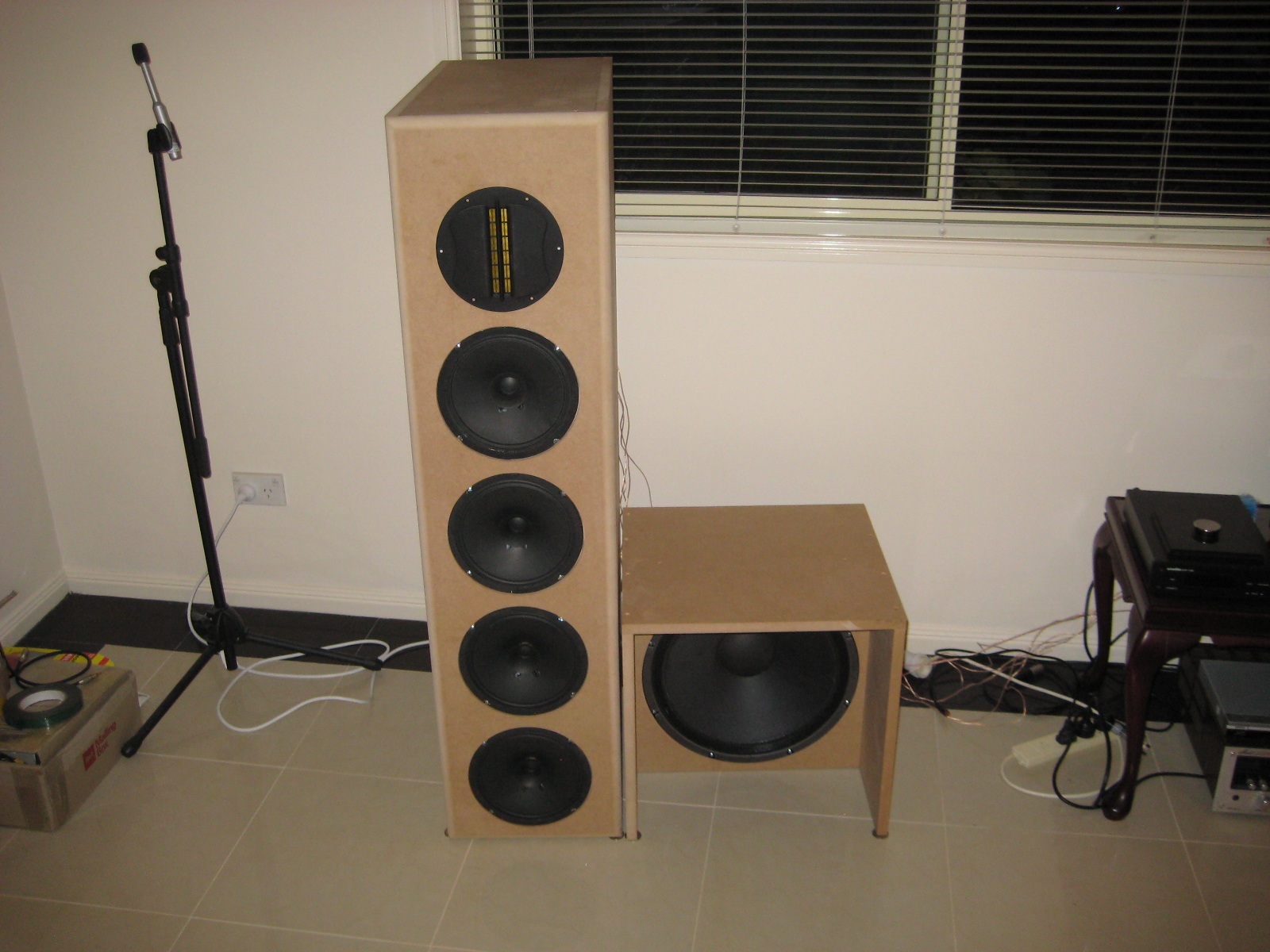

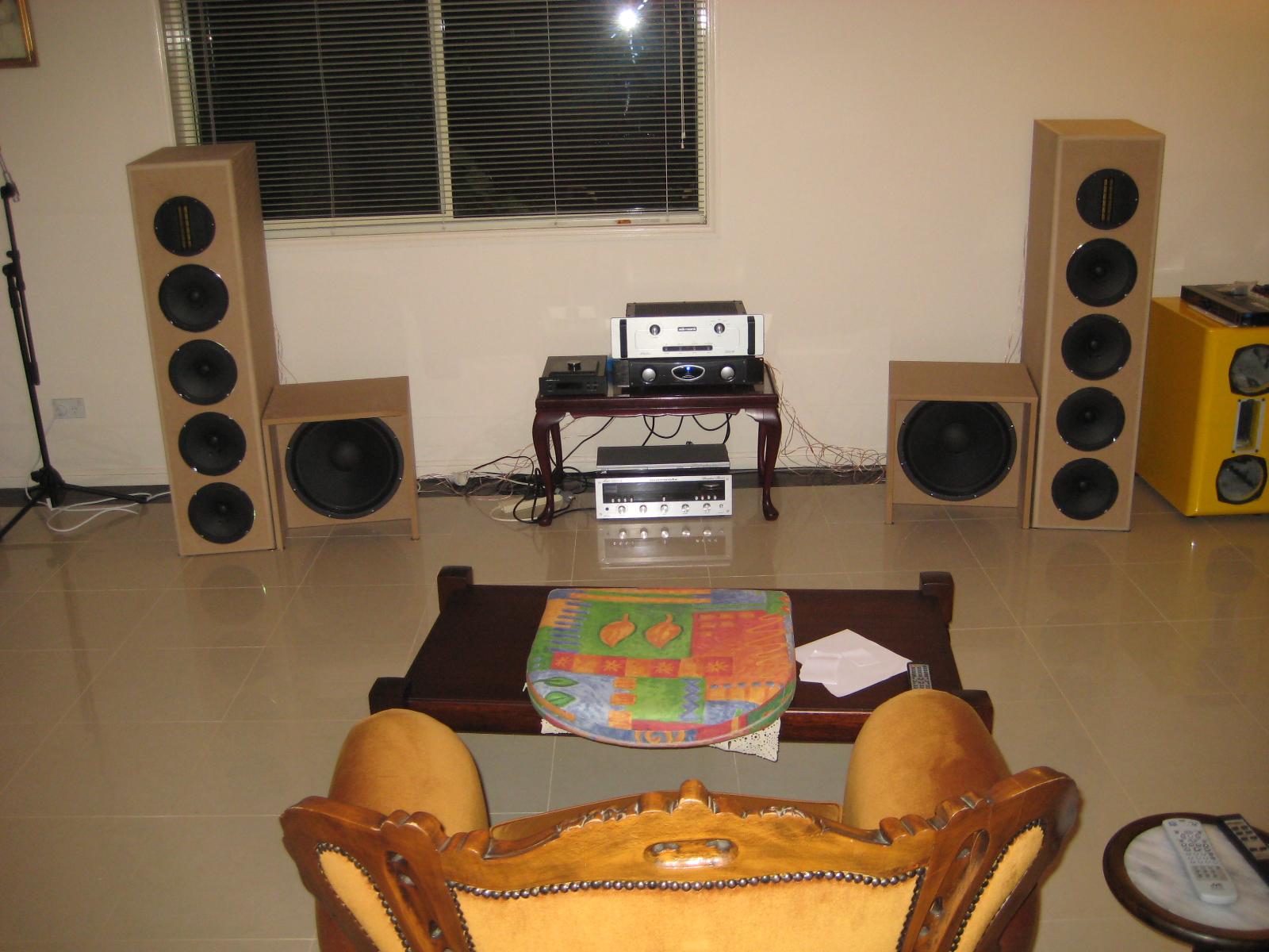

I've actually built something similar, although I can't claim full credit for the design, but more info on my build can be found here.
The best DIY speaker in the world? - DIY Audio & Electronics - StereoNET Australia
They are essentially an 'open backed box' and each driver is separarted by a shelf, to stop crosstalk and to provide bracing. I'm using a very cheap full range driver, found at my local Jaycar shop
8-inch Twincone 8 Ohm PA Speaker - Jaycar Electronics
They do need help from a tweeter, and I've tried several ribbons, planars, and domes sadly, from a cost point of view, they pair very well with my RAALS, which I already had, so the RAALS are going to stay. In the pics I'm using a HiVi RT2C-A Planar Isodynamic Tweeter, which sound good, but the RAALS simply shine, and sound OH! SO! natural and so much faster. And that's the problem, these things are very fast, in a different league of fast compared to power hungry modern 'Hifi' drivers, with heavy magnets and heavy cones. They also need help in the bottom octave, and I'm using a pair of Alphas in a 'H' frame for bass support, these will need updating though as they are just a tad too slow to keep up with my FR's and RAALS, but enjoyable for now. my hunt for a great well priced high sensitivity OB 15 incher continues.
I'm running these passive, and the crossover is very simple, LR2 on the tweet and Bass, and a inductor, so 1st order on the FR's just to tame the combined rising response, crossover ponts are 3k and 170hz, but you can vary these to suit your tastes, higher or lower, you have room to explore.
So how do they sound? Well I'll say this. I've never ever been as this excited about music and HiFi in my entire audio journey, some 20+years, these speakers simply tick so many boxes for what they do well, if I couldn't build another pair of speakers, or buy something better (N.B I'd have to spend plenty) i'd happily live with these for a long long time.

Hi Norman, I should clarify. I'm using a second order on the RAAL, cut off is 3000hz. Second order on the Bass, cut off is 170hz, polarity reversed on the tweeter. I did try a second order on the full rangers, but they simply don't like caps in the signal path, it kills their sound, so just a small 0.44mh inductor filtering all 4 full range drivers, just to flatten out the combined rising response. To be honest I thought they would sound 'Honky as hell', but they simply don't, they certainly aren't a flat frequency response, but a 'Flat' FR to me sounds very dry and boring, lifeless in fact, so I've leant. Without really knowing it these speakers are approching the type of sound I've been listening for. I feel more connected to the music, within the music. There's just something that sounds right with these very light fast speaker drivers that when grouped together, reveal details and timbres and transients, that simply aren't there with other speakers I've built or heard before. Things like singers swallowing, chests filling with air, feet moving on the ground, or hands being rubbed on clothing, lips actually touching the mic, it's all there and more. I thought this level of detail would be tiresome and fatiging, but I I've done extensive 12 - 15 hour continuous listening and felt fresh and wanting more. All this from a very modest pre/power front end, and a cheap DVD player as a source, who knows what will come when I finally get myself a half decent DAC, let alone cables, and a proper amp? more work to do though speaker driver and cabinet treatments to do, and I may add another 15inch bass driver as well. All been well worthwhile thus far, certainly had it's ups and downs, and I've made it a point in this build to do it as a subjective project, resisting the urge to use a measuring mic and software my ears are to be my guide for this one. It takes allot longer, but t's been more enjoyable as well, and I'm learning more about myself as a music lover, and DIYer. It's certainly the last time I put cheap nasty speaker drivers in a box at the back of my parts cupboard that's for sure.:D
