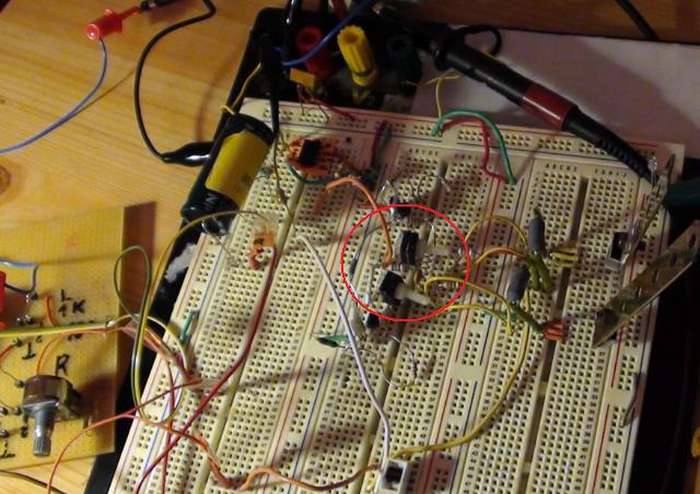

I've been playing with op-based amplifiers a bit. My first attempt was simply an NE5534 with integrated darlingtons at the output (TIP147/149 I think). This turned into a complete failure because, after taking care of oscillations, the darlingtons were impossible to thermally stabilize. A darlington has 2xVBE from input to output thus twice the sensitivity to thermal changes, plus the integrated device has driver and power transistor thermally coupled which now seems like a very stupid idea to me. After the PCB burst into flames after playing for a while (it was powered from a 400VA toroid transformer) I abandoned the project.
I now have mchambin's circuit on the breadboard and did some THD measurements.
Some changes to the original schematic:
-the CFP oscillated badly so I added comp caps to the drivers; the BD136 (negative side) I found needs something around 400pF for lowest THD while the BD139 is happy with just a few tens of pF
-LME49860 and OPA552 were used as op-amp
-power supply is limited to +/-13V (maximum output from my stabilized lab power supply)
-stopper resistors were added (100R to the op-amp's output and 10R to each driver base)
Attached are the THD results with comparison to loopback connection on my Xonar DX soundcard. The test was conducted both with open output and 8R dummy load; interestingly this only caused minimal change to the THD. Distortion becomes much smaller at higher frequencies; I don't know if this is due to the 100uF output capacitor or just a quirk of the measurement software (Visual Analyzer + WaveSpectra).
I also compared non-inverting and inverting topology; now noticable changes in THD were observed. Also the LME49860 was compared to a OPA552; the latter had about the same THD. I conclude that the major source of distortion must be the output stage and there is a limit as to what extent the op-amp's feedback can deal with it.
The bias voltage is non-adjustible as in mchambin's original design. As you can see on the picture the drivers and diode-connected bias transistors are thermally coupled. The circuit seems to be very stable now.
A few ideas I want to try out:
-insert VBE multiplier and find out optimal bias voltage
-use error-correction output stage
Any further ideas/comments on how to improve this circuit?
