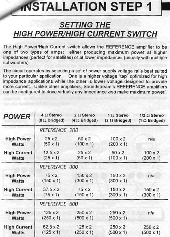

2 ohm mono is not recommended in high power mode. Even if the manual shows that it can be used that way you shouldn't run these amps like that. This is Soundstream's fault for stating it can be run like that and why the company didn't survive due to too many warranty claims. The main indicator that it shouldn't be ran at 2 ohm mono is it doesn't make any more power as you drop from 4 ohm mono to 2 ohm mono. This basically tells you the power supply is all tapped out. When you are in 2 ohm mono, each channel is only seeing 1 ohm, this is too low for high power mode. Switch to high current mode anytime a channel will see anything below 2 ohms. This would include 2 ohm mono. The amps will be so much more reliable if you use high current mode in the way I describe.

We currently use a Ref 300 at 2 ohms mono in high power mode, no problems whatsoever, the amplifier doesn't even get hot.
But I do agree that low impedances caused many problems including the demise of the company. Some of their Class A models can be run at 1/2 ohms mono (1/4 ohms stereo !) but I would never, ever do that. 2 ohms mono is the lowest I go and I agree, at this impedance people should try high current mode first. If it's powerful enough, leave it that way. However, on some of the later models one cannot choose between these modes as there was the automatic switch.
If the amp isn't getting hot, then you are not using the available power from the high power mode. I would go ahead and switch it to high current mode to make it easier on the amp since you don't appear to need all that power anyway.
I could not agree more. I will make the suggestion to my friend, he's coming over tomorrow. I wanted to do so in the first place, we realised we forgot to flip the switch after installing the amp and I guess we left it that way.
