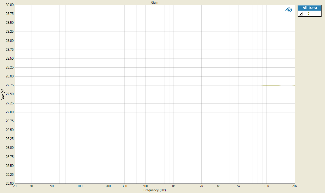

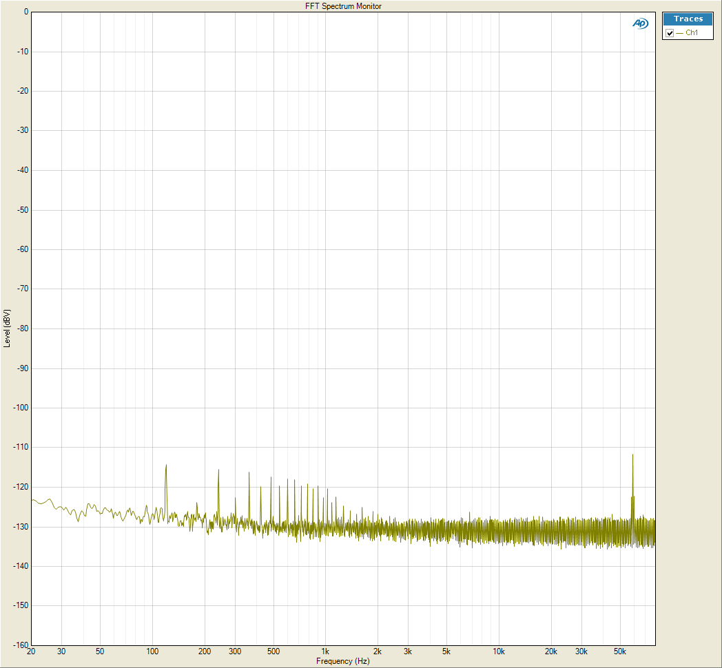

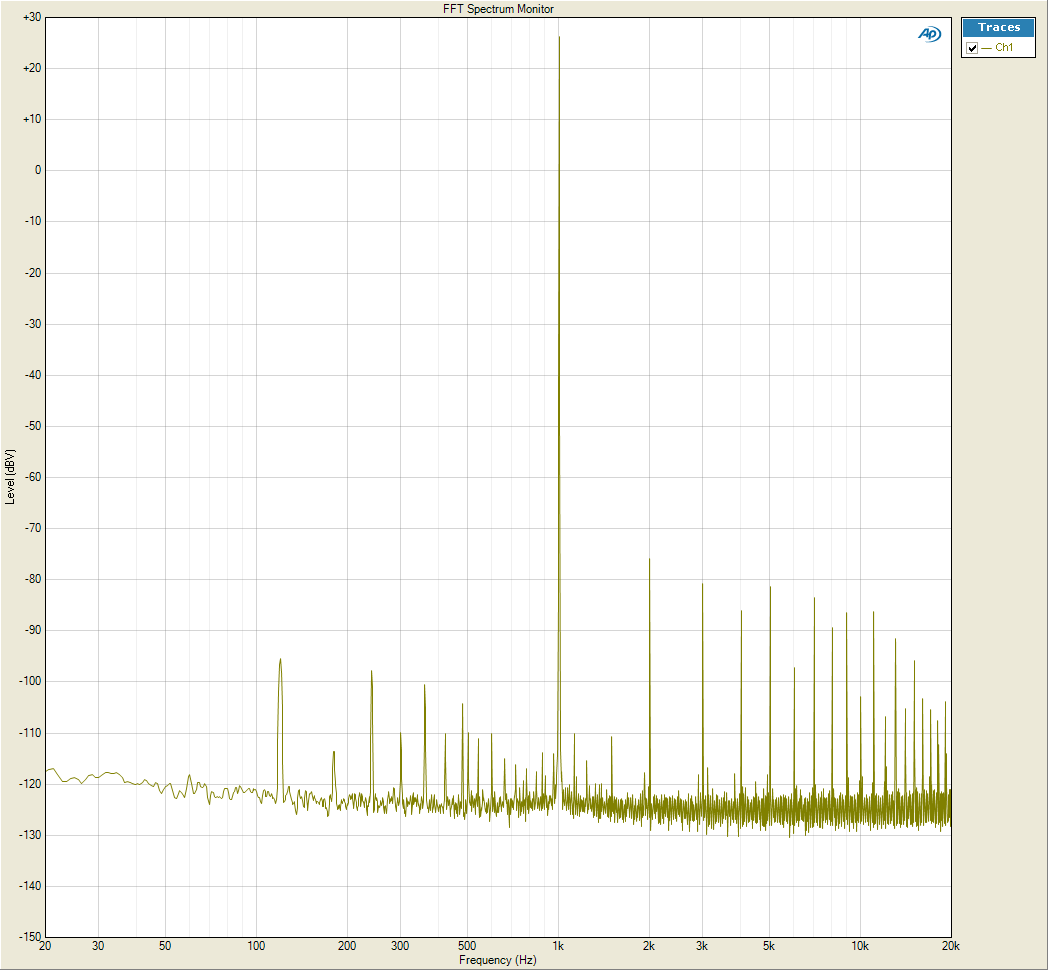

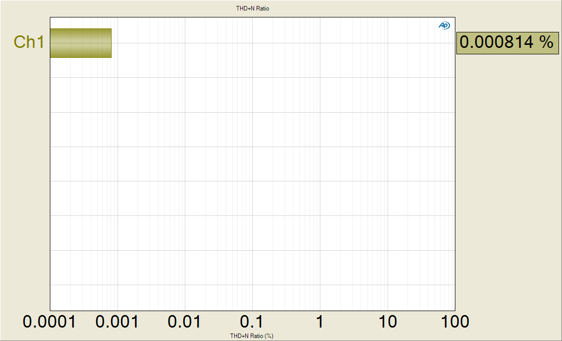

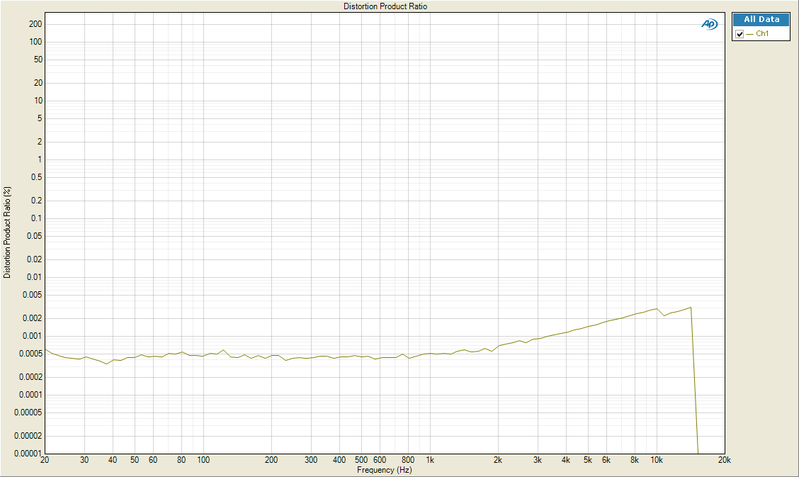

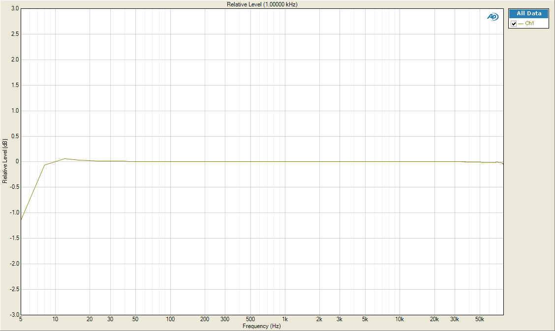

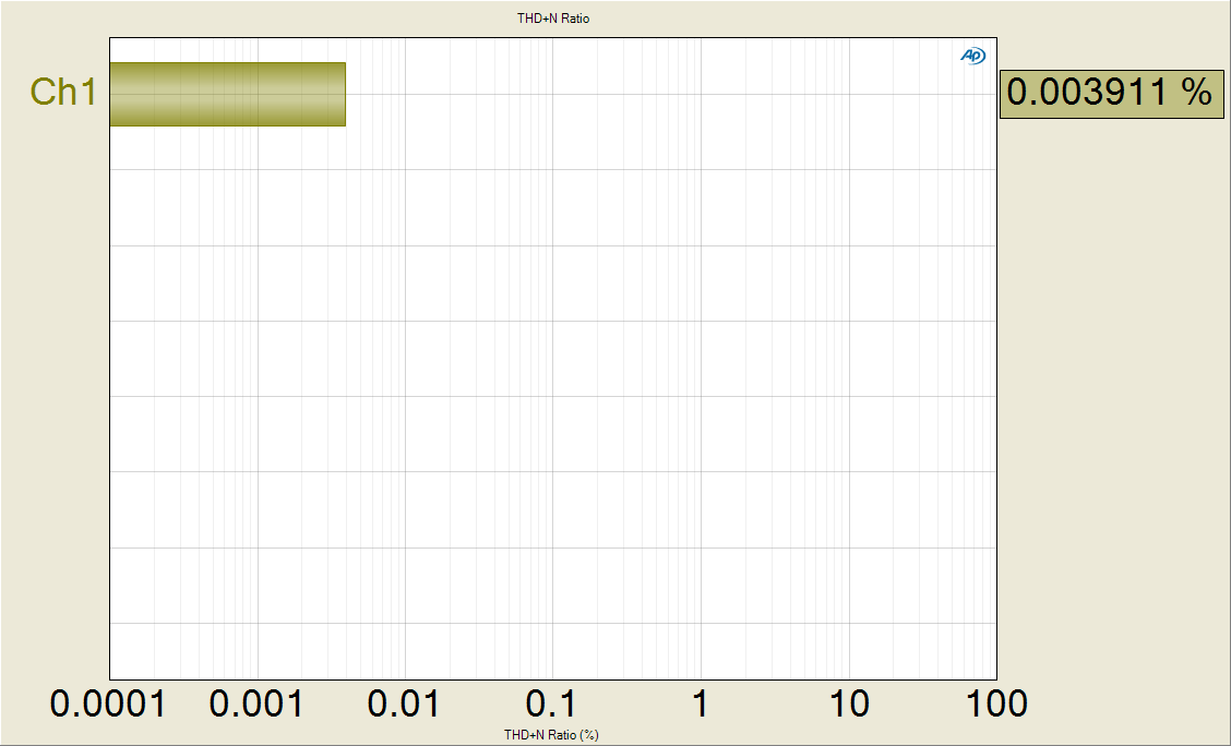

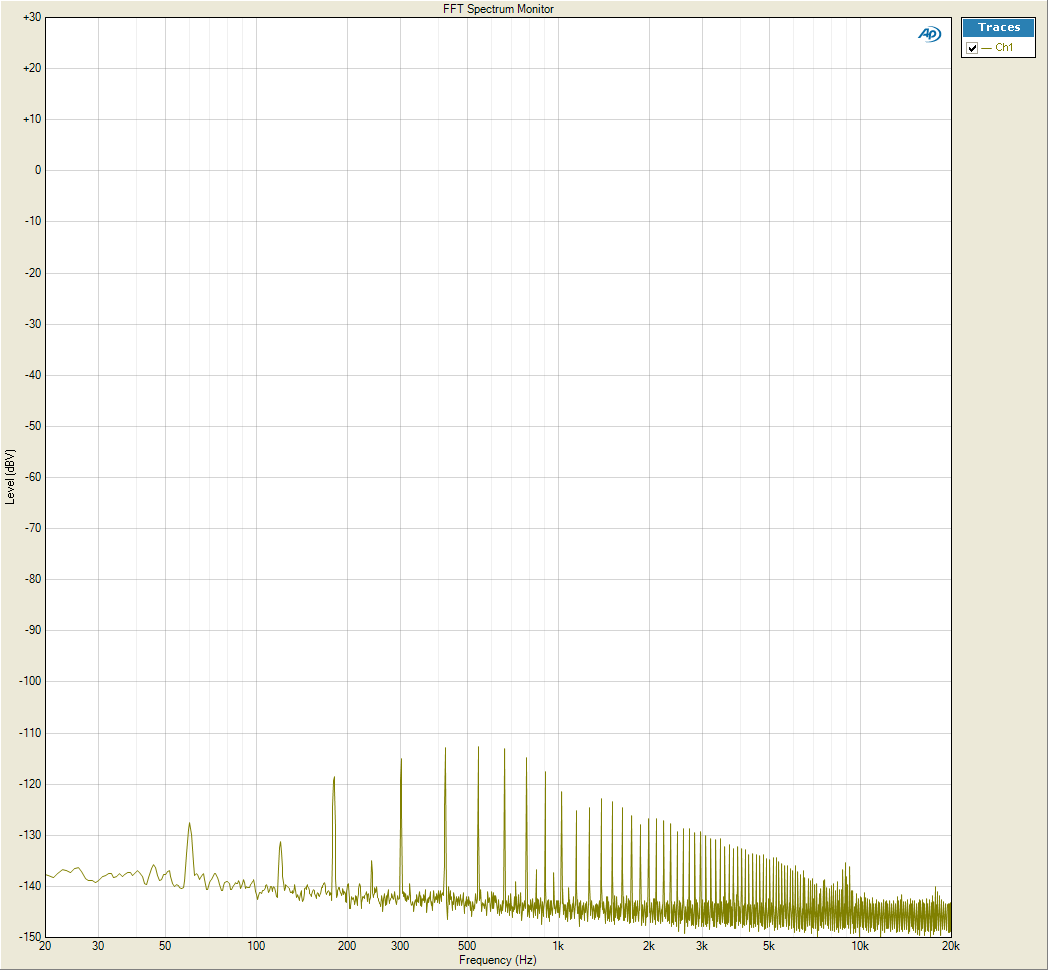

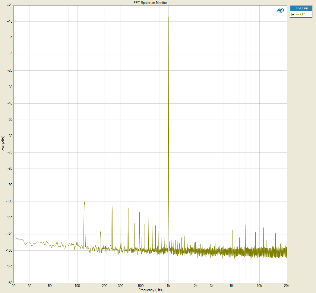

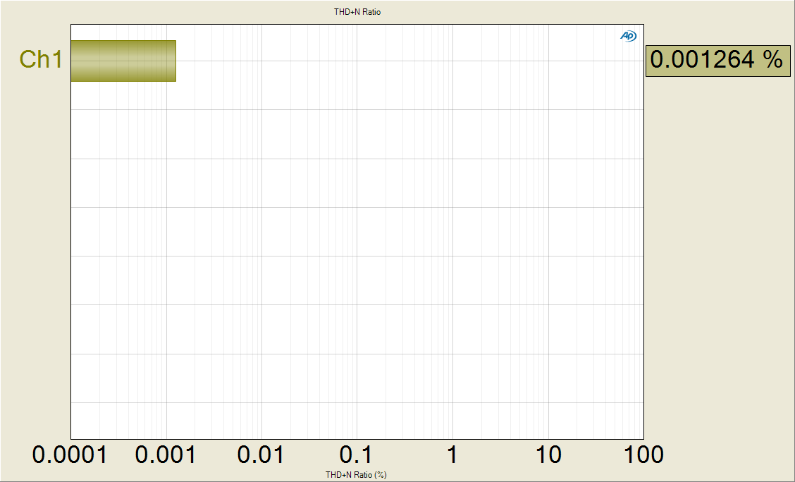

Attached below are the measurements for the prototype that this project is based upon.
I ran a worst case test setup with +/- 40V rails on both the LME and the mosfets. The supply was unregulated and sat at a nominal 42VDC under only the load of the bias. The bias was set to 360mA which meant the channel was dissipating about 30 watts at idle. This is considered a class AB setup.
A more ideal setup would be to provide the front end with a regulated supply voltage that is about 10V higher than the rails used for the mosfets. This allows the output stage to be driven fully rail to rail which means more power output with less dissipation, which gives higher efficiency.
The regulated front end would also drastically reduce the 60Hz noise (along with all the harmonics) that can be seen in some of the measurements.
Overall, these numbers are superb and would absolutely destroy any of the class D designs I've seen so many people here get excited about. The noise floor is exceedingly low, and distortion performance is some of the lowest I've ever measured in a power amplifier. At 2.5W with standard class AB bias, you're looking at about 0.000814% THD+N.
Owen
