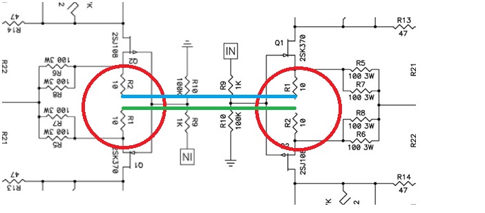

I'm currently building 2 mono F5X with the P-F5c-2V20efrom the diyAudio Store.
those are the boards with cacode option and 2nd output pair option.
I'll build the 2nd output option and "X" 2 boards for a mono block.
AFAIK Smyslow did this with the 1 output pair boards but it was not further commented.
To "X" the boards two pcb connections need to be cutted. Not nice but the boards have no "X-Option". See picture.
Here are my first 2 questions to the knowledgeable:
1. Input impedance
If I go with the 1k input resistir plus 100k reference to ground as in the original F5 I'll end up with only 500 ohms input impedance in a X design. This is fairly low. I built my AX amps with 10k input impedance and 10k reference to ground.
Here I would like to go with 22.1k input impedance and 221.1k reference to ground.
Would this be ok?
2. Relative DC offset resistors output to ground
Would it be helpful to implement the output to ground resistors from other X designs (33 to 68 ohms plus/minus output to ground) also in this design? Or is it unneccessary? If yes, why?

OK
use 1K in series with gates ( anti-oscillation measure ) , then anything between 22K-47K from gates to gnd .
that will be input impedance for each leg .
NB that's not same as XA amps , where is used inverting stage NFB for establishing SUSY function , which means that series gate resistor is dictating input impedance .
OK
Thank you!
THAT was helpful
Output resistors?
> you already have them - look at feedback net
But not when you float the X, dear Choky.
I personally would put 220R 1W to Gnd at both outputs.
But feel free to experiment.
No need to challenge Heinz1 for eine Kiste Bier.
