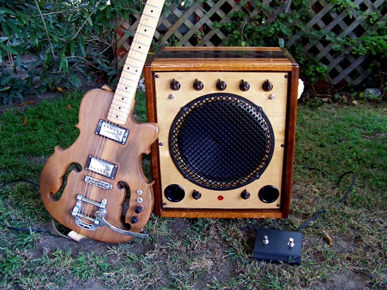

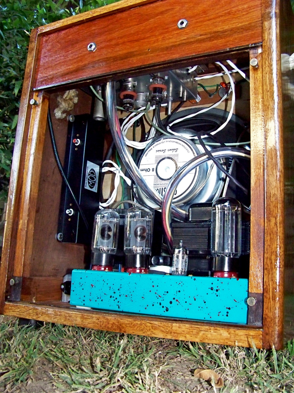

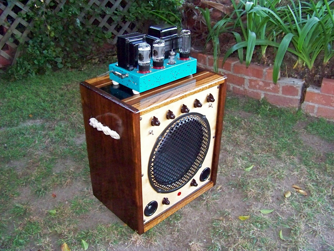

Cool man! How many hours u got on the 6L6s? Those burn marks on the glass are pretty neat. Cool idea to have the rag-holder built into the cab side. The only thing missing is a basket weave grill front.
edit: I zoomed in and see now that's not a rag, but the rope handle...cool!

Semper: Those tubes are used and came from an old McMartin PA amp. I thought those 'burn' spots were original. And I thought about a grill cover. I won't be making another amp with the controls on the front, too difficult. In fact I'd prefer to make a head and speaker cab separately. This amp is for my nephew, 17 and a killer guitarist for his age. And, yes, those are braided hemp rope handles I made-no other handle would do justice...
