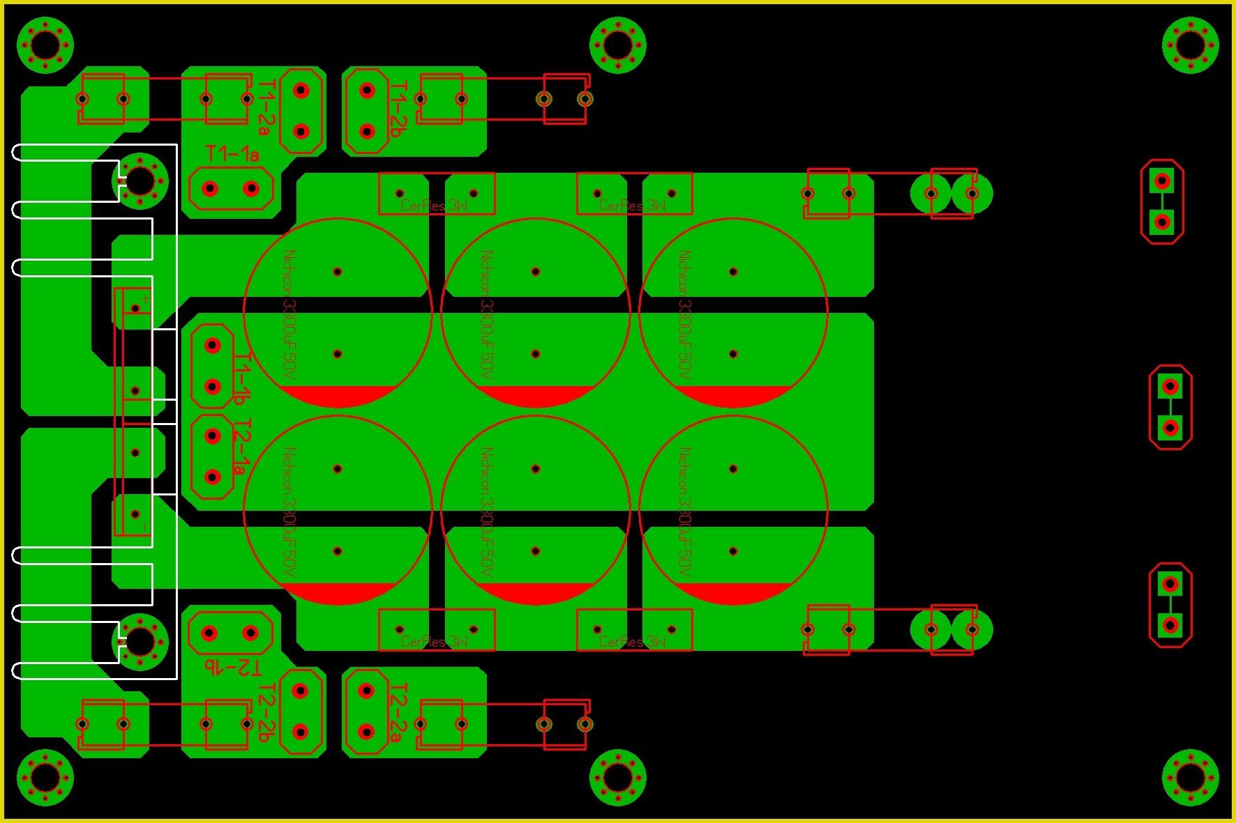

1: Any component that requires special mounting like your power devices to a heatsink go on first.
2: input to output or vice versa? I think it's personal choice though I tend to go input to output.
3: I lay on power / ground initially because it's best if it's minimally disrupted and it HAS to be there. Resistors make fine jumpers over power traces. The video boards I did were mostly 4 layer with a solid ground plane. The other middle layer was primarily power routes or if needed, signal routes that will never need to be altered. I've not tried 4 layer for audio but I'd expect it to be very good if not better.
4: I try for rectangular boards with as few routes as possible as they cost less. 'Routes' are special cuts / cutouts for oddly shaped boards. Size often has mechanical requirements for chassis or card cages. Or, leave enough space around power devices so it doesn't 'cook'.
5: Any devices that cause a lot of mechanical stress are better chassis mounted if possible.
This is a question of faith! I have made a bad experience once putting rectifiers, power caps and AMP on the same PCB. Hugh and others seem to have not made this experience.
In my next layout I will place the power caps on the AMP PCBs, but leave the rectifiers apart.
It is the power caps that store the energy for the output-transistors and the shorter the way to them is, the quicker the current can be forwarded.Best regards - Rudi_Ratlos
In terms of the psu I worry about two things.
First, the very high current surge/spikes that naturally flow in the transformer secondary - through rectifier diodes - through first barrage of filter caps. I don't want any of this on my pcb unless it's out at the edges like Hugh does it. If I can't afford the space to do it his way, then I want it off the pcb.
Either way, I want the current loop area that these large current charging spikes flow around to be as small as possible so they don't couple and radiate into my small signal circuits. This means I want the secondary of the transformer - recifiers - caps to be physically very close to each other with all wiring twisted pairs. The twisted pairs should carry counter-flowing current so that their magnetic fields overlap and cancel out as much as possible.
So if you put any part of the psu on the amp board, you want the rest of the psu mounted very close to the amp board itself. You also want to ensure you have thick & wide traces on your pcb where these large spike currents are flowing.
The second thing I worry about is high frequency noise generated by the rectifier diodes 'switching' on and off. I follow Hugh's recommendation and use soft recovery diodes (that's not the same thing as slow recovery). And if possible, in-line chokes. You don't want these chokes anywhere too close to your amplifier as they do leak magnetic flux. Just like output inductors - you don't want these anywhere close to each other or your small signal circuits either.
And a small afterthought - power supply filter caps - electrolytic caps don't like heat - keeping them away from the hot output stage will lengthen their lifetime. It's an exponential relationship - a drop in temperature has a significant benefit.
Anyhow, I'm not in a position to talk much from experience, these are just the guidelines I give to myself.
In terms of pcb design:
I haven't made many so again I'm not an expert in any fashion. But here are some of my thoughts:
a) I like to keep the main power rails close together so that countervailing current flows are adjacent - minimizes area of loop for magnetic coupling. I also like to keep them short and fat and away from the small signal parts of the circuit. Most everyone else likes to separate the power rails around opposite edges of the pcb - the opposite to my philosophy.
b) Think about where the big currents flow through the load. I find that in most cases I don't have to worry about large currents flowing through the GND on the amplifier pcb - those big currents all happen off board. I place my star gnd at the speaker gnd connectors. On my amplifier pcb the big current flows occur only in the + and - rails.
c) I haven't used a ground plane but may try it in my next design. I do know that a ground plane is a complex animal - it is NOT an equipotential once you move away from dc currents. If you place a ground plane on the one side of your pcb and then run signal traces on the other side, the return currents for these signals will tend to follow the path of the signal traces as they return through the ground plane. You need to consider a ground plane as behaving like a mirror image of the signal traces with all the consequences of cross-talk. The higher the frequency the more this is important. With no ground plane consider carefully where return current flow back to the gnd connector on the pcb - shared ground traces are OK where currents are small, but any larger currents warrant their own trace.
d) Place the 'must have' parts first - usually you have no choice about the power devices. You may also want to place trimmers and connectors in places where they can be accessed. You may need mounting holes.
e) I then partition the board into areas - high current power, low current signal, feedback paths etc. and then layout into these areas. I am careful near any sensitive high impedance points such as the feedback node and input (i.e. the LTP on amplifiers that use them) as these are very prone to capacitive coupling of unwanted signals - you can end up with an oscillator instead of an amplifier this way.
f) If the layout is not pleasing to my eye then I will change it. Don't ask me why, but it seems an important part of the process for me.
p.s. use large pads for through-hole parts, easier to work with and less likely to lift up when you have to replace the part in question because you blew it up !

Partial PSU
Here's the start of my PSU. It will have boosted rails for IPS and VAS and will use two dual secondary transformers, 20V+10V, no centre taps. Will try to fit a capacitance multiplier for the boosted rails if space allows (still have to lay down rectifier, filter and other components for the boosted rails yet, obviously).
Comments and constructive criticism welcome.
